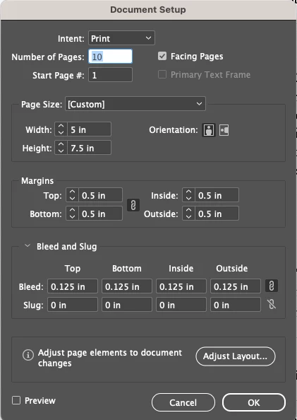

I am working on a little book with my friend. I used Adobe Illustrator to make the cover and in the pricess of working with InDesign to make the book. I am new to KDP book formatting, but have used these programs before - there is so much murky information out there its a bit overwhelming.
I was hoping to receive some help to make sure that I am starting out with the right dimensions/template for the print version interior pages of the book.
Interior pages: Black and White only with no bleed. (Small black and white images at each chapter.)
Paperback trim size: 5 x 7.5 inches (custom size)
Page Count: 24-150 pages
Inside margins: 0.5 inches
Outside margins: 0.5 inches
Also posting here the document size etc.
Also any free resources to learn about this process (design with Acrobat programs to publish with Amazon for both print and ebook) would be awesome - it has been a steep learning curve for sure.
Thanks so much!

KDP print books are a fairly easy process, assuming three things:
  • You have reasonable mastery of InDesign, especially in page layout (size, margins, facing pages, headers/footers). If you're still learning these, a few tutorials or videos will help you get things right without a lot of trial-and-error.
  • You should follow all the page and trim size numbers given you by KDP to the dot. It looks as if you know this and have all the numbers you need for your desired trim size. Covers are much fussier and have to wait until you have a final page count (to determine the spine thickness); the best way to do your first cover or two is to enter the numbers in the spine-width calculator and download the template it generates. (You can actually lay that image into a background layer in InDesign as a visual design reference.)
  • Don't try anything tricky with your layout. KDP simply does not allow things like upside-down pages, back-to-back books (like the old Ace Doubles), or many other "clever" or "unusual" layouts. Keep it all standard or the bots will reject the submission.
Basically, if you can export the content to suitable PDFs, you'll be good to go. But again, having more than basic PDF export knowledge helps with things like bleeds, color profiles, etc.
E-books are another whole world, although KDP/Kindle is one of the easier ones to deal with. It is NOT just a matter of exporting the same book file to EPUB; you have to follow some different rules to get a clean, well-organized export. Here is a basic primer on InDesign-to-EPUB/Kindle, and there are some more advanced essays in the same place: http://www.nitrosyncretic.com/DPR/dpr_indesign_epub_basics.php.
Happy to answer questions and help as you move your project along.
ETA: You will probably do better to do the cover layout in InDesign and pull any design or illustration assets into it from Illustrator. Much easier to manage in the resizing and export for print.

I keep second guessing my margin choices. We are aiming for a clean "easy to read" look. Currently it is 0.5 inches all around. I keep thinking that having a larger inside margin larger (0.7 or more?) would be a better idea? It is a small book with not a lot of pages so the spine will be minimal but is there an industry standard or is it completely personal preference (as long as following the KDP guidelines?).
Thanks again.
James Gifford—NitroPress
Feb 3, 2024 6:43 PM UTC
A larger inside margin is almost always needed. The smaller the book and even more so the smaller the page count/thickness, especially with a "tight" binding like perfect-bound, the larger it should be for convenient reading. On a 6x9 book, I typically use 1 inch inside, 1/2-inch outside (well, actually 6pc and 3pc — picas are so much more convenient for print layout! 🙂 ) We've all read books that have too small an inside margin and are a PITA to read without breaking the spine. Your readers will appreciate it.
Within reason, KDP doesn't care how large your margins are — only that they are wide enough to keep all text inside the safe trim zone of about 3/8 inch. They have very little opinion about esthetics  — that's your job.
