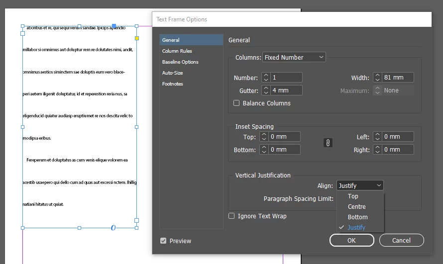

Check that your text boxes do not have Vertical Justification turned on.
If you need it on generally for "reasons", you will need to override it for these particular ones.

Robert at ID-Tasker
February 26, 2024
Something like that?
