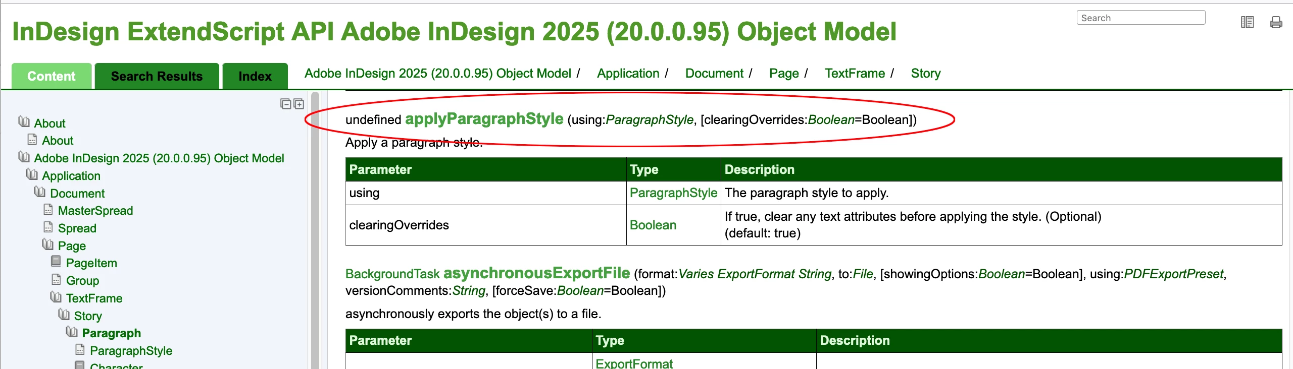

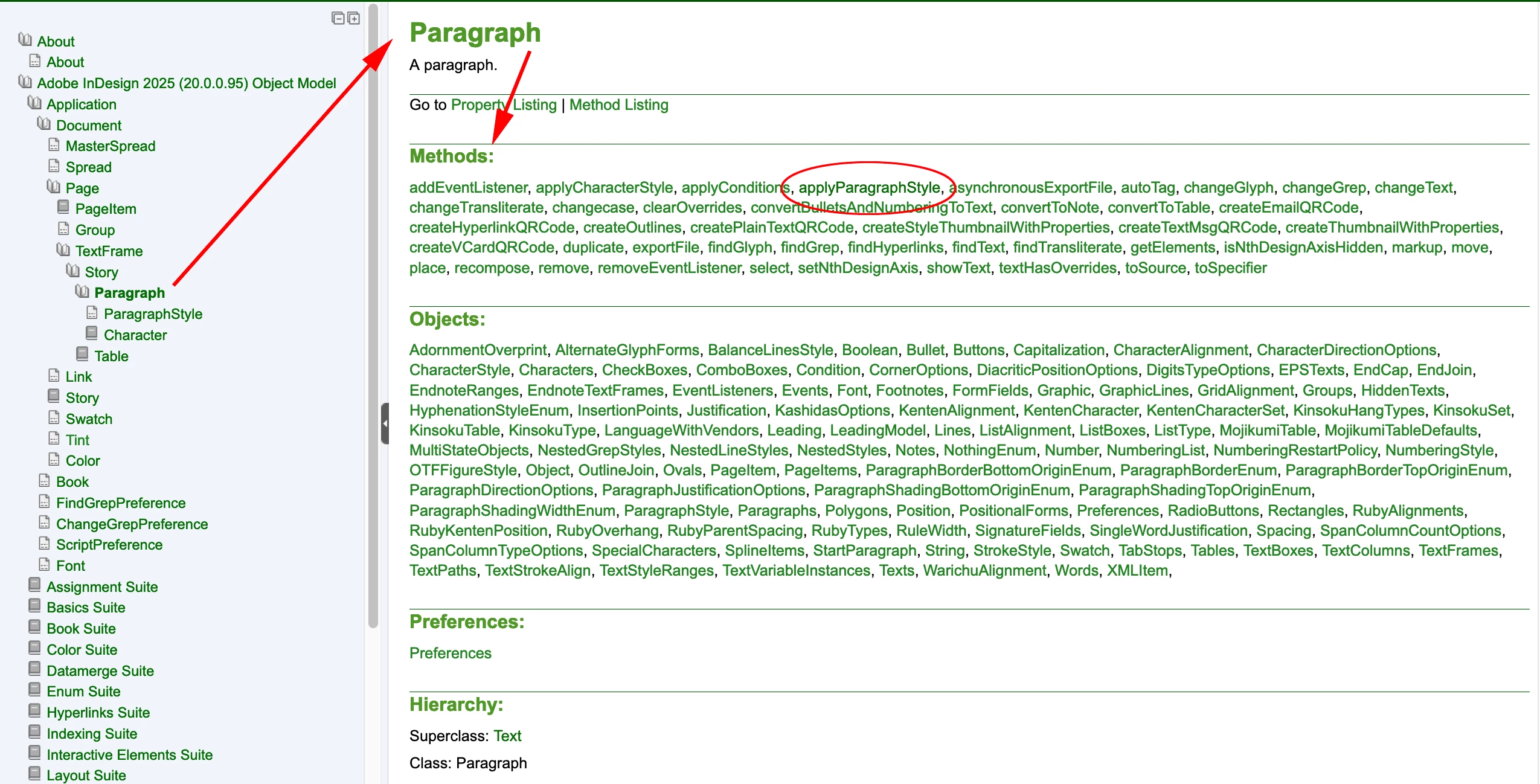

rob day
Oct 14, 2025 12:38 PM UTC
I couldn't find any info on it anywhere
Hi @ed_ben_c , Just in case you are not aware, you can find a very well organized API here:
https://www.indesignjs.de/extendscriptAPI/indesign-latest/#Paragraph.html#d1e503310__d1e509635
