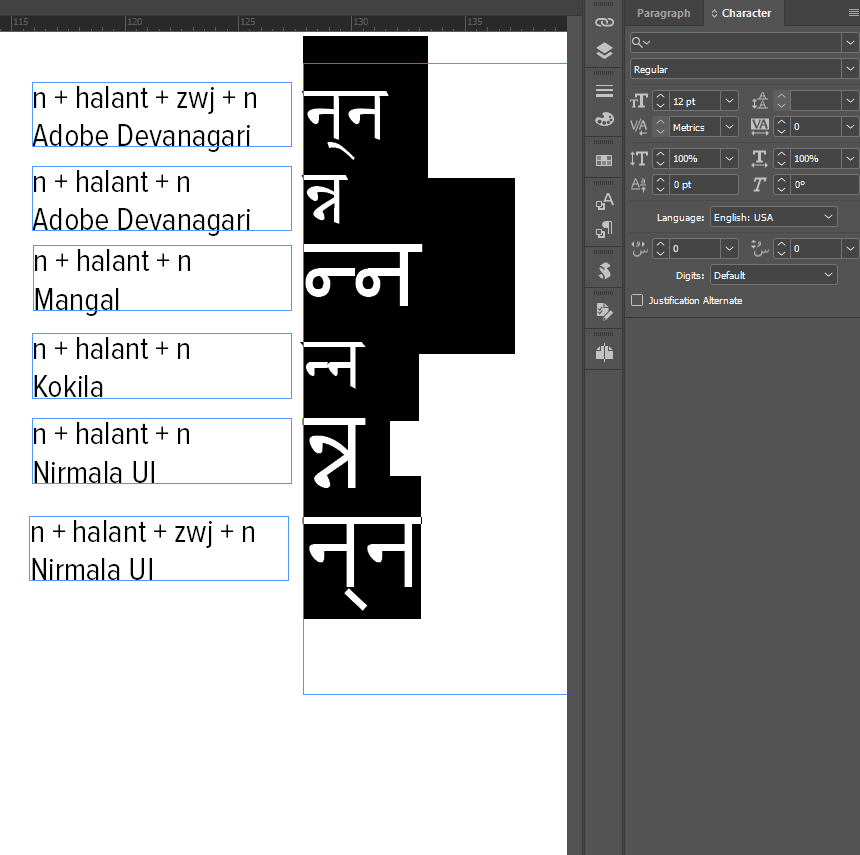

Every time I write the words such as " न्न श्व " I want to write a traditional one like " न्‍न, श्‍व " how can this be written ? The key "=" does not seems to work in indesign. Can anyone please help me?

Thanks for all of that additional information! Took me a while to figure it out, but I think I've nailed it. I've installed the Nepali Unicode Romanized input method myself, now. I find that the equal key successfully inserts a zero-width joiner, which looks like it's doing nothing, but it's certainly inserting a ZWJ.
Then, I tried to type this combination using a variety of different fonts. However, there isn't a Nepali setting in my Language: dropdown, so I left it in English. It turns out that some of the OpenType methods your font will rely on to render correctly are language-aware; if you don't pick your language in the Character dropdown, they don't work! There's no Nepali choice in my install of InDesign, so I picked Hindi instead.  In the following animation, note that Nirmala UI immediately changed its rendering of the glyph when I chose Hindi as the language, but I had to rekey it in Adobe Devanagari in order to get it to render correctly.
It's not unusual for such features to be dependent on the language setting of the host application, especially since many languages that share the same writing system will have different ligature or contextual-alternate behaviors.
So I think that the correct answer is: actually, the equals key is working correctly; the problem is that InDesign doesn't have a language setting for Nepali. The workaround is to mark your text with a langauage that InDesign does have in its dropdown, one that supports the glyph-shaping behaviors you need.

The things you want to type have zero-width joiners; I still don't know why the equals key is part of your post, but if you didn't have a way to type this in your current input method in InDesign, I'd suggest adding a keyboard shortcut to Type -> Insert Special Character -> Other -> Joiner

In my typing layout, the '=' key is used for zero-width joiners. However, there is still a problem. In order to type 'न्‍न,' I have to type 'न,' '्,' 'ZWJ,' and 'न.' If I don't use ZWJ, then it appears as 'न्न,' as you mentioned. However, when I need to type 'न्‍,' I simply go to the Glyphs window.
I am using the Adobe Devanagari font, and my operating system is Windows. My input method is 'Nepali Unicode Romanized Layout.'
Interestingly, there is no problem when using the same layout and font in Adobe Photoshop.

Can you give us some more information? I don't know enough about typing in Devanagari script to know what is going on in your case, but there aren't that many possibilities.
Are you using Windows or Macintosh?
What's the name of the font you are using?
Are you using a standard 101-key Latin-script keyboard to type?
What's the name of your input method? How do you turn it on?
Does this combination of hardware + software keyboard work to input your desired characters in other apps? (I'm guessing "yes it does")
I don't think you are using the default Hindi Inscript keyboard that comes with Windows, because I don't think you'd need the equals key "=" to type the characters you're trying to type. I don't know exactly how you would type it... a न, followed by a virama, followed by... something else? Not another न, because that clearly yields न्न. How would you type these glyphs in other apps?
