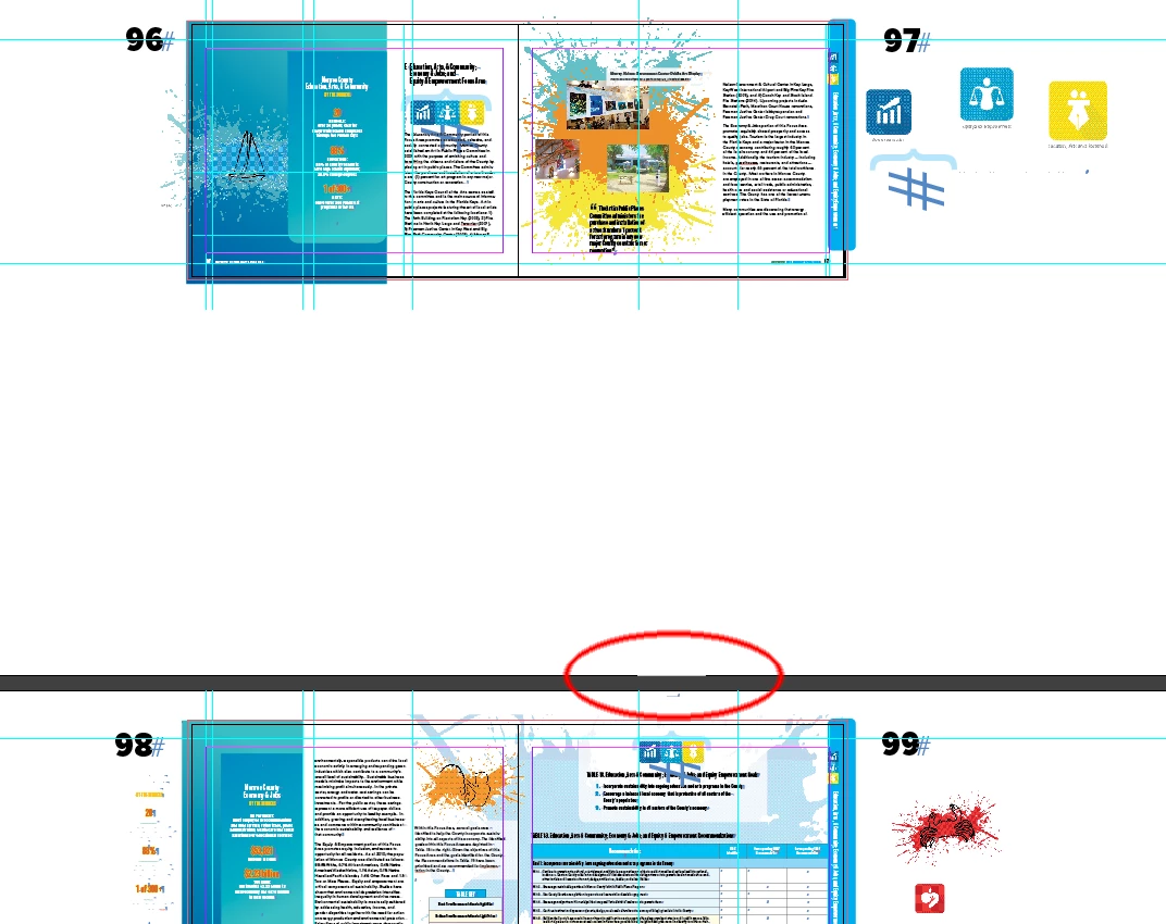

Jul 26, 2016 9:00 PM UTC
Sorry, grabbed one. Here is closer view screenshot.

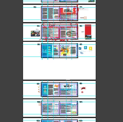

seajpsideAuthor
Jul 26, 2016 8:58 PM UTC
Sorry, maybe this one will be more helpful.
Tried grabbing and moving upward but it snapped back as it is. Grabbed each page individually. Not sure how to do them together with Page tool. It is a facing page doc as is probably evident.
Jul 27, 2016 2:11 AM UTC
You have something trapped right on the edge of the pasteboard at the bottom on the right hand side. Usually copying and pasting  large items or multiple items larger than you document size this can happen. Delete this and the pasteboard will snap back. This can happen with guides too.

Jul 26, 2016 8:22 PM UTC
Very likely caused by Page Tool because I kept getting it when reaching for Black Arrow. This i screenshot.

Jul 26, 2016 5:27 PM UTC
that is usually the result of something at the edge of the pasteboard. It should not carry over, but if you want it gone, drag around all the content of the two pages on the spread and copy.
Delete the two pages, and add two new pages. Then paste in place to put your content back.
