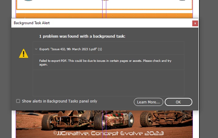

I export to PDF our local newspaper for printing and digital publishing, which has worked perfectly fine until the most recent InDesign update (18.2). It fails every time on every computer in the office that has the latest version installed. We have worked out that it has something to do with the update because I have reverted back to a previous version (18.1), and it's exporting fine. Exporting a single page to PDF is fine. It's the larger documents (64 pages/52MB) we having problems with. Print to PDF works fine, but it has colour issues when printing and the hyperlinks aren't saved for digital use. I use InDesign every day to produce our local newspaper and other client work. Until the issue is fixed I will stick with version 18.1, but I do like to keep my Adobe products up to date.

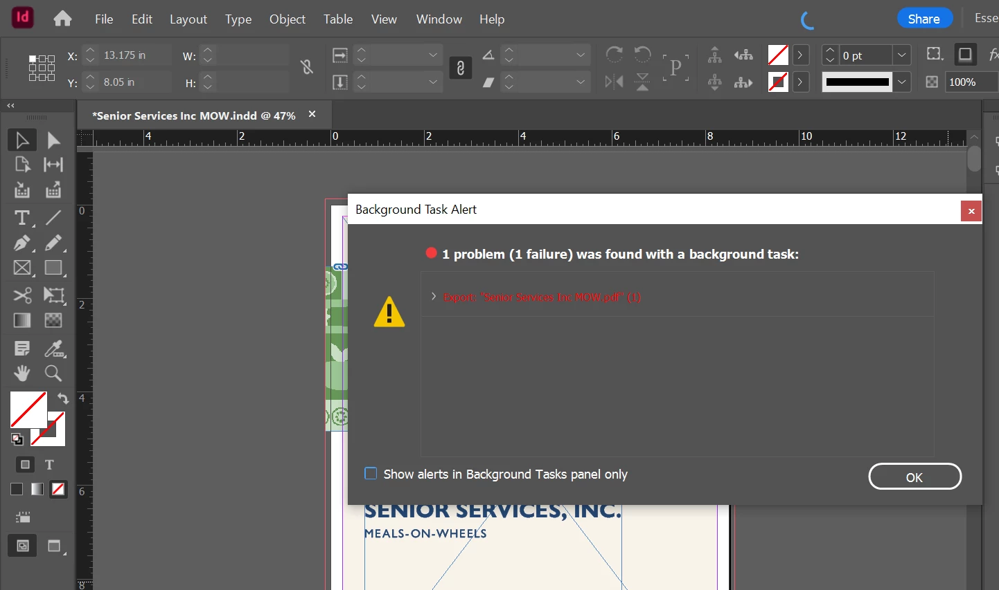

My team is having the same problems. We checked for type 1 fonts. We tried rolling back to 18.1. Error message: "1 problem was found with a background task". Should we disable background tasks?
Robert at ID-Tasker
March 17, 2023
Try and see if it helps - you can always undo it.

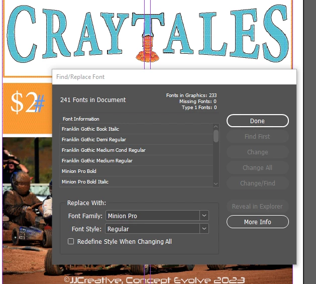

crayt17396241
March 10, 2023
Thank you for your reply.
I have checked the document, and there are no Type 1 fonts.
Would there be another reason?
