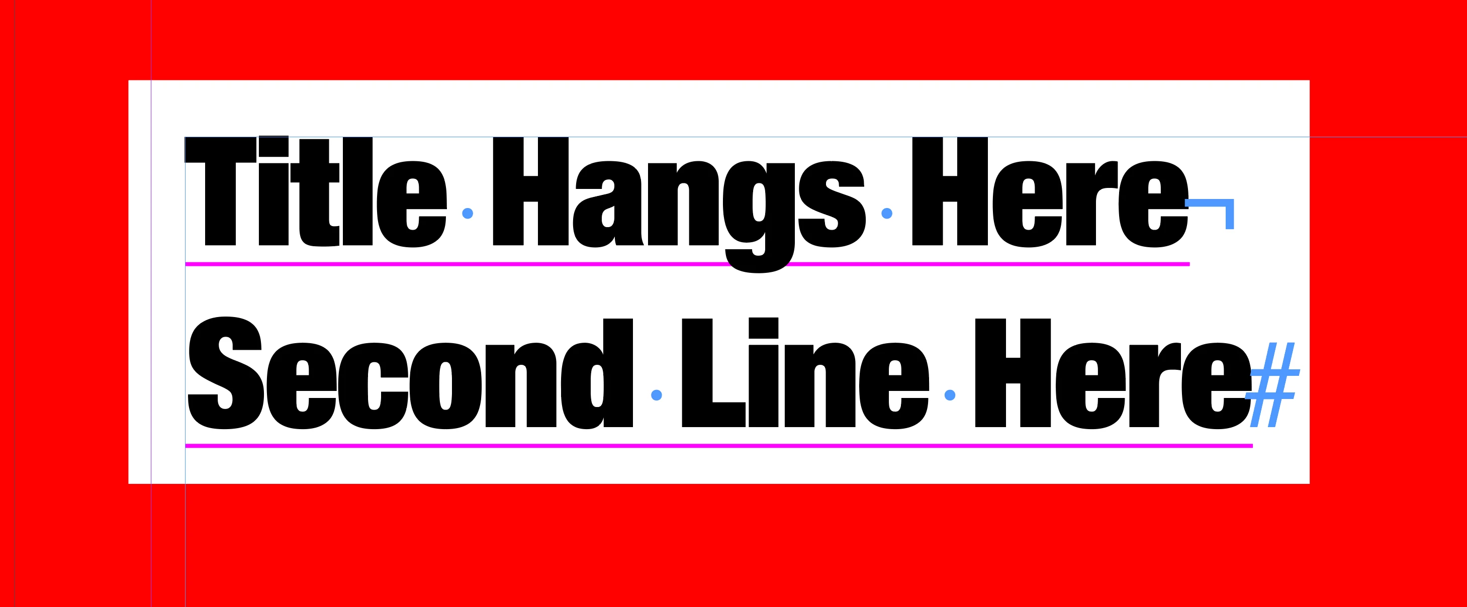

Trying to see if there is a resolution to the following. I want to set up a way to establish a style where I am using both Rule Above and Rule Below for two different purposes. One establishing a white box below the type so that it reads over photos and can adjust based on the type without creating a secondary box and one where it adds a thin rule below the type (an underline) that does the same. The problem is that no matter how I set up the thin rule, on the turn the white rule of second line blocks the thin rule of the line above it. I don't want to change type specs if I don't have to. I know I can adjust the white rule to be smaller so that it doesn't overlap with the thin rule, but I am wondering if there is a way to make the subsequent lines display below the previous ones. Screen shot attached with basic look. The problem with this is that the thin rule needs to be below the descenders. For reference of placement the cyan rule is an offset strikethrough, the only method in which it is not covered by the white rule of the next line. The magenta rule is actually in place on both lines, the first line is just being covered by the white rule of the second line.

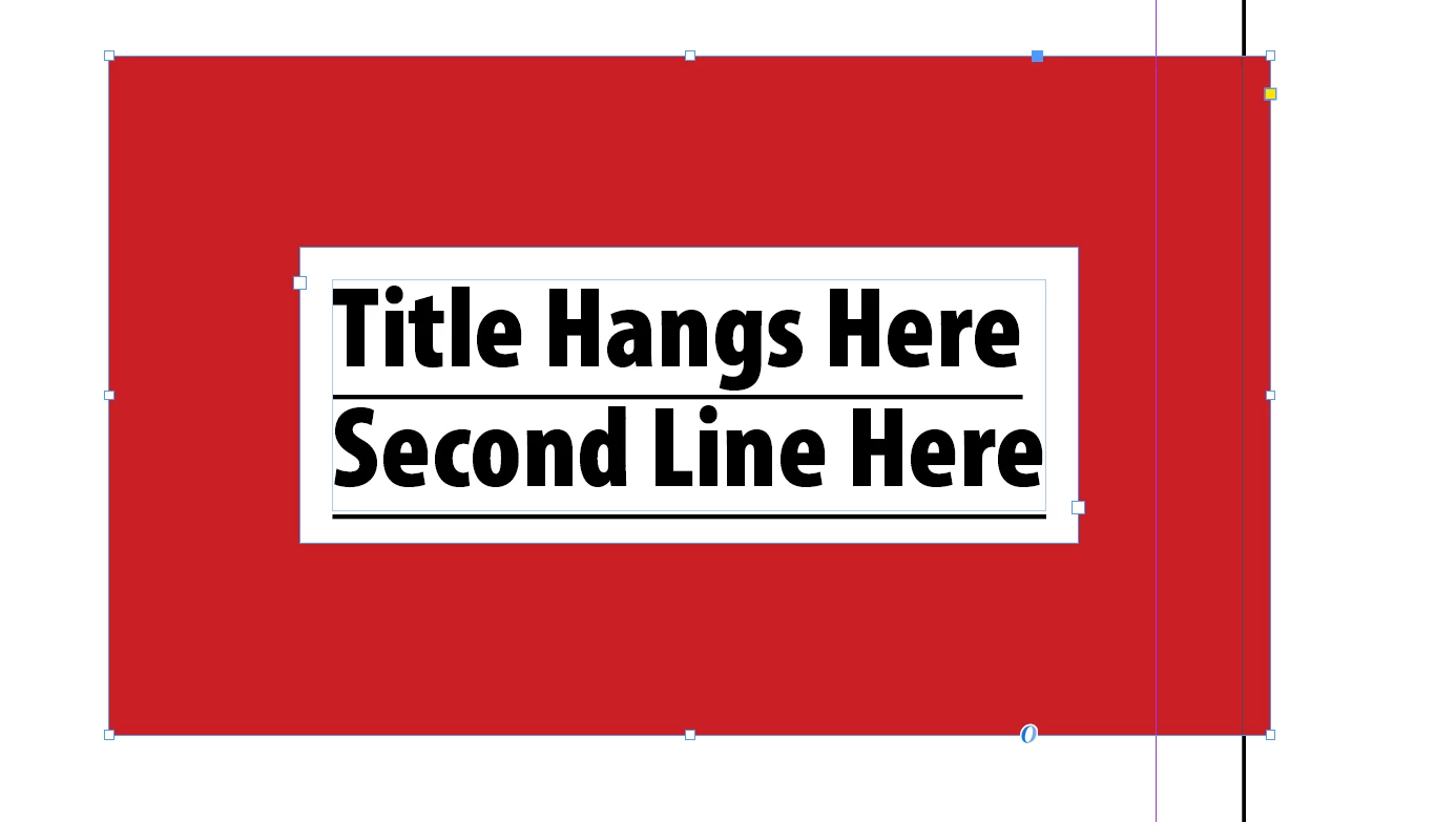

The text has to be in a frame, so why not but the white background (and red border if that's what it is) on the frame?
Then you can use the Underline settings to move the rule down.
An Object Style can be set and linked to the Paragraph Style.
If you don't want the underline on some words, you can use a Character Style to turn it off as needed.
Feb 4, 2025 7:35 AM UTC
In answer to the last post, yes, the red represents a photo. We want to obscure the photos as little as possible. Depending on headline, first line can be longer or shorter than second line by several characters, so we do not want to fill the the frame, but apply a "white box" below the words for legibility as well as trying to streamline the edit so that we don't have to redraw a white box under the text every time a word changes.

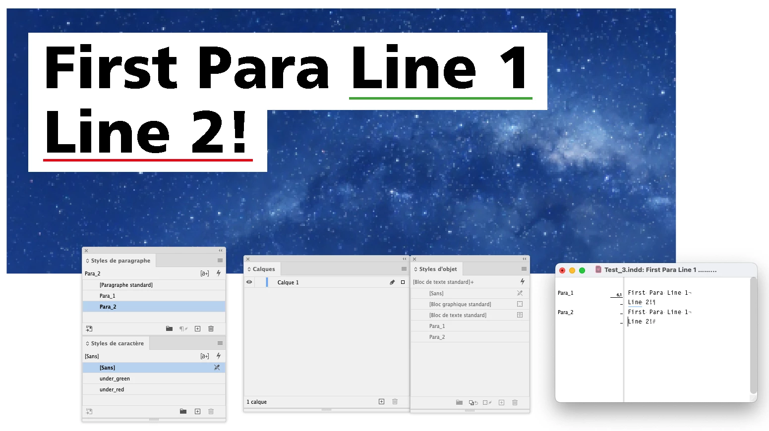

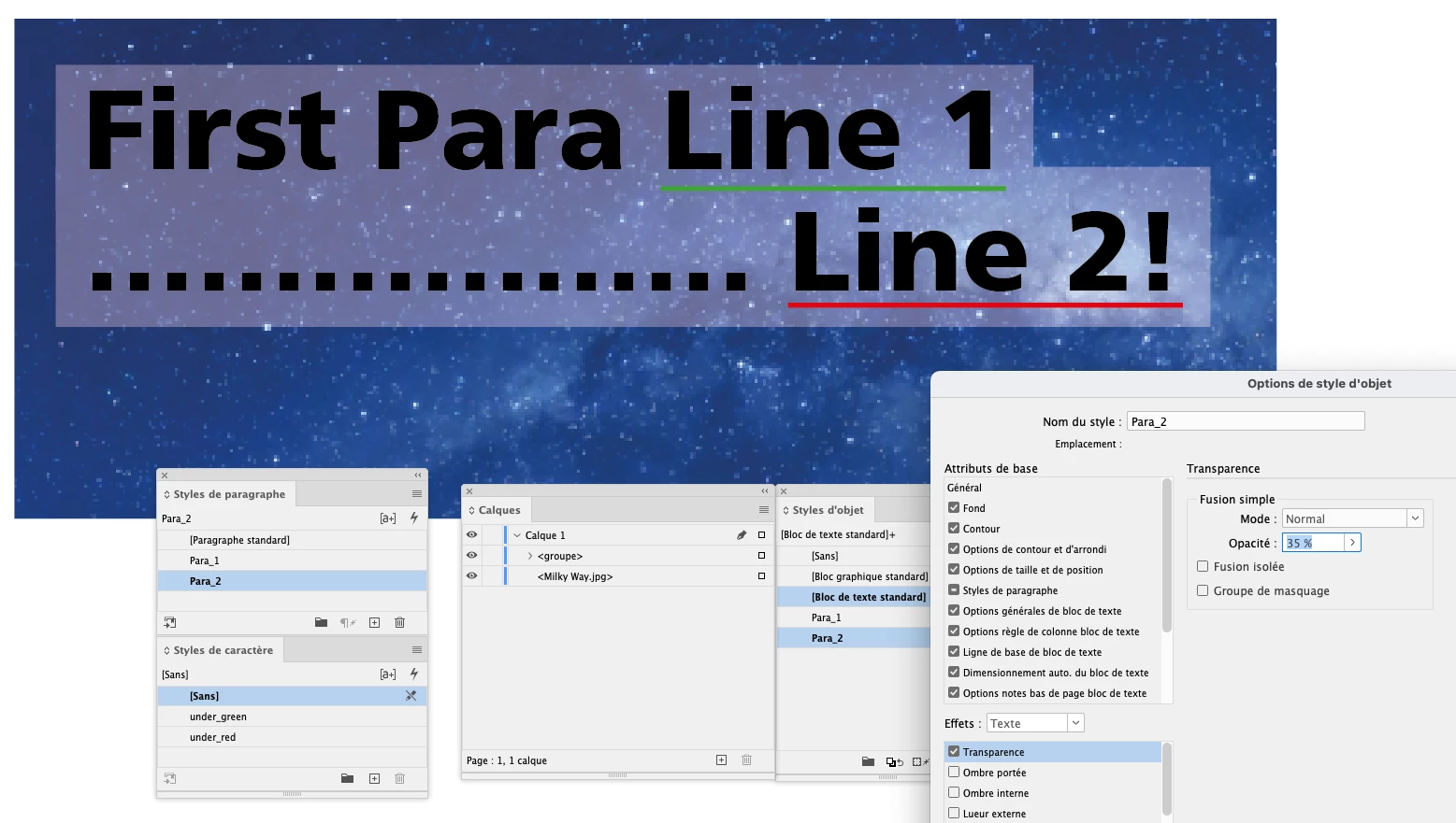

davecourtemanche
Feb 3, 2025 10:48 PM UTC
What about Paragraph Shading & an Underline Character style?
Feb 4, 2025 12:17 AM UTC
Same result, the white 38 pt shading covers the thin rule
davecourtemanche
Feb 4, 2025 12:33 AM UTC
Not sure I understand - in my example, the white is coming from Para Shading (behind copy) and the magenta rule is an underline character style. No covering.

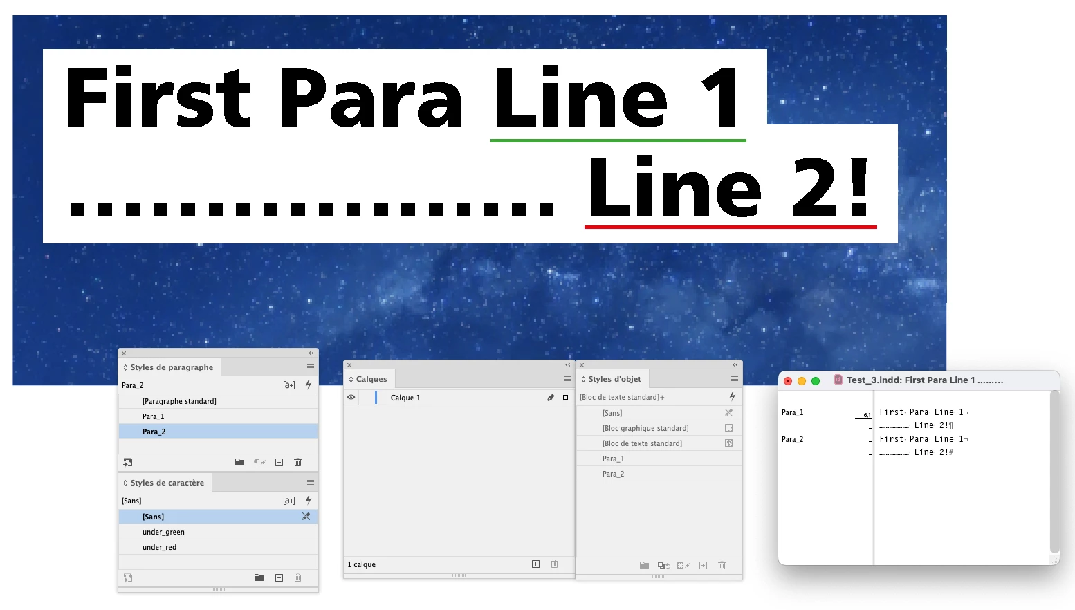

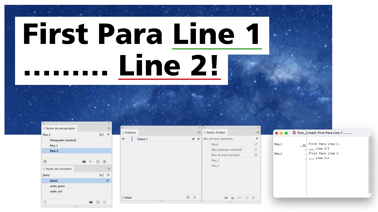

FRIdNGE
Jan 30, 2025 11:14 PM UTC
2 paras + Rule Above + Underlining

Feb 3, 2025 10:12 PM UTC
Tried that, does not work. Assuming from all of the comments there is nothing I am missing regarding an overprint setting. I was hoping so. For seom reason the the second line always covers the first line.
FRIdNGE
Feb 4, 2025 9:59 AM UTC
