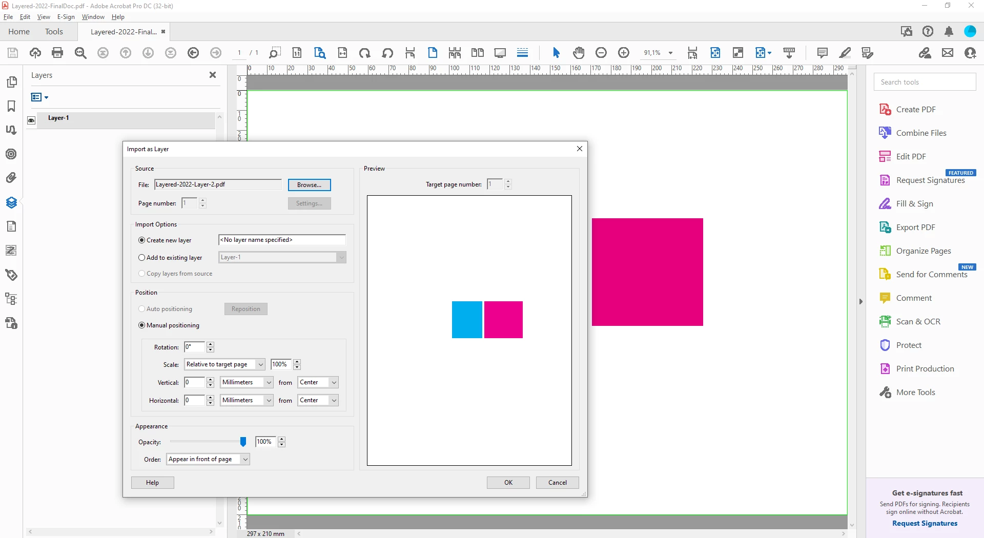

here is another idea.
Export PDFs from InDesign without the layers enabled.
Do that separately for every layer you like to see in the final PDF.
In Acrobat use the function "Import as Layer" to assemble your layers that will be not nested.
Uwe Laubender
( ACP )
Steve Werner
December 29, 2021
I tried playing with that last night, Uwe, but it's very painful and confusing to use the Import as Layer method. Illustrator is a lot easier.

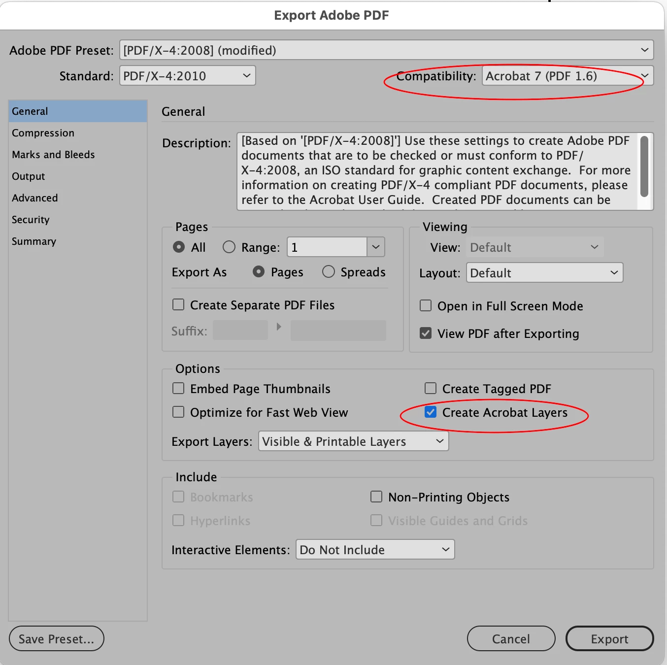

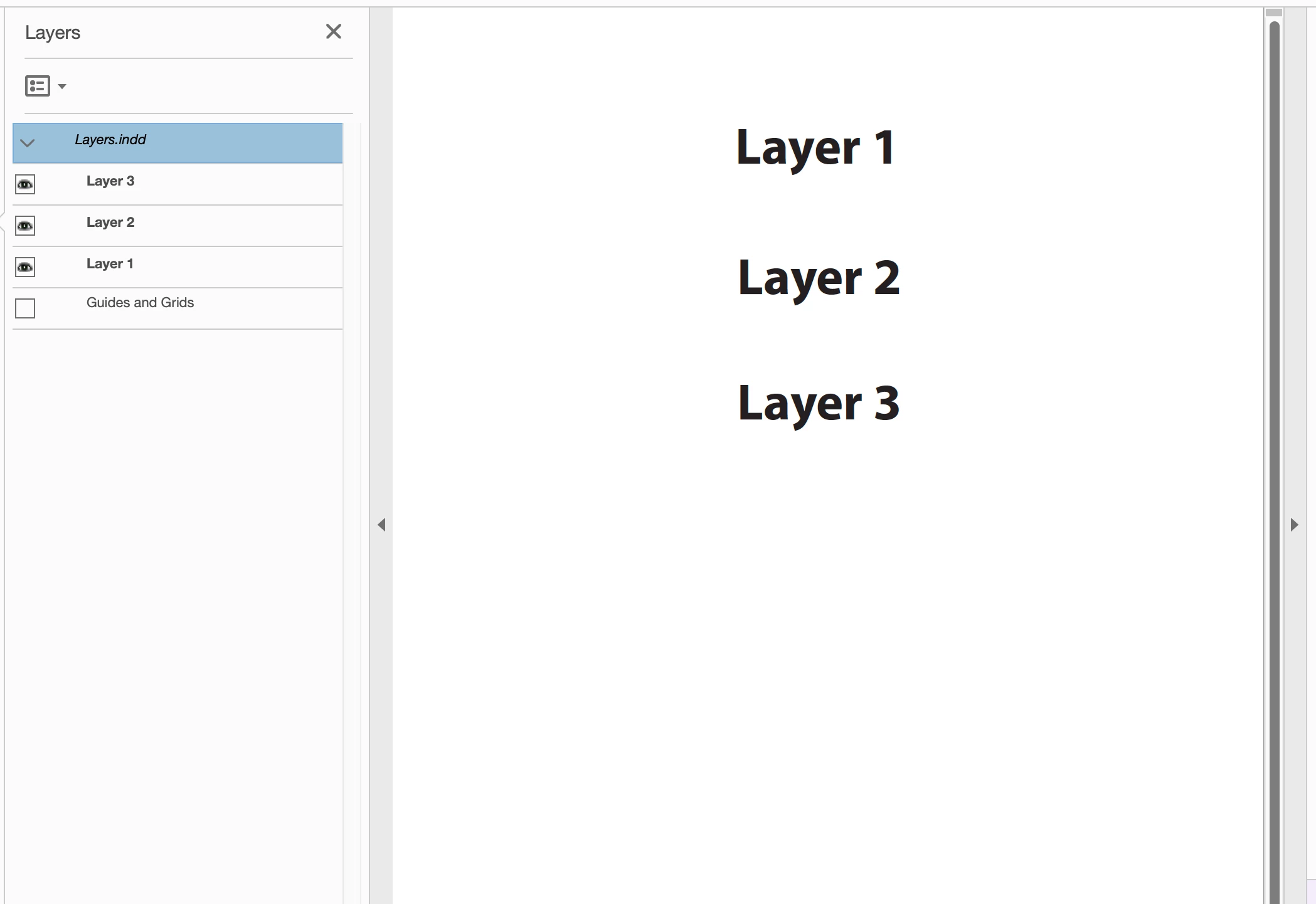

It all depends on the settings you make in the Export Adobe PDF dialog box.
If the PDF Preset you chose has Compatibility (circled) to Acrobat 6 or 7, you'll have the option to turn on Create Acrobat Layers (circed)
If this is checked, you'll see layers in Acrobat in the Layers panel (see below):
If it is unchecked, then there will be no sublayers:

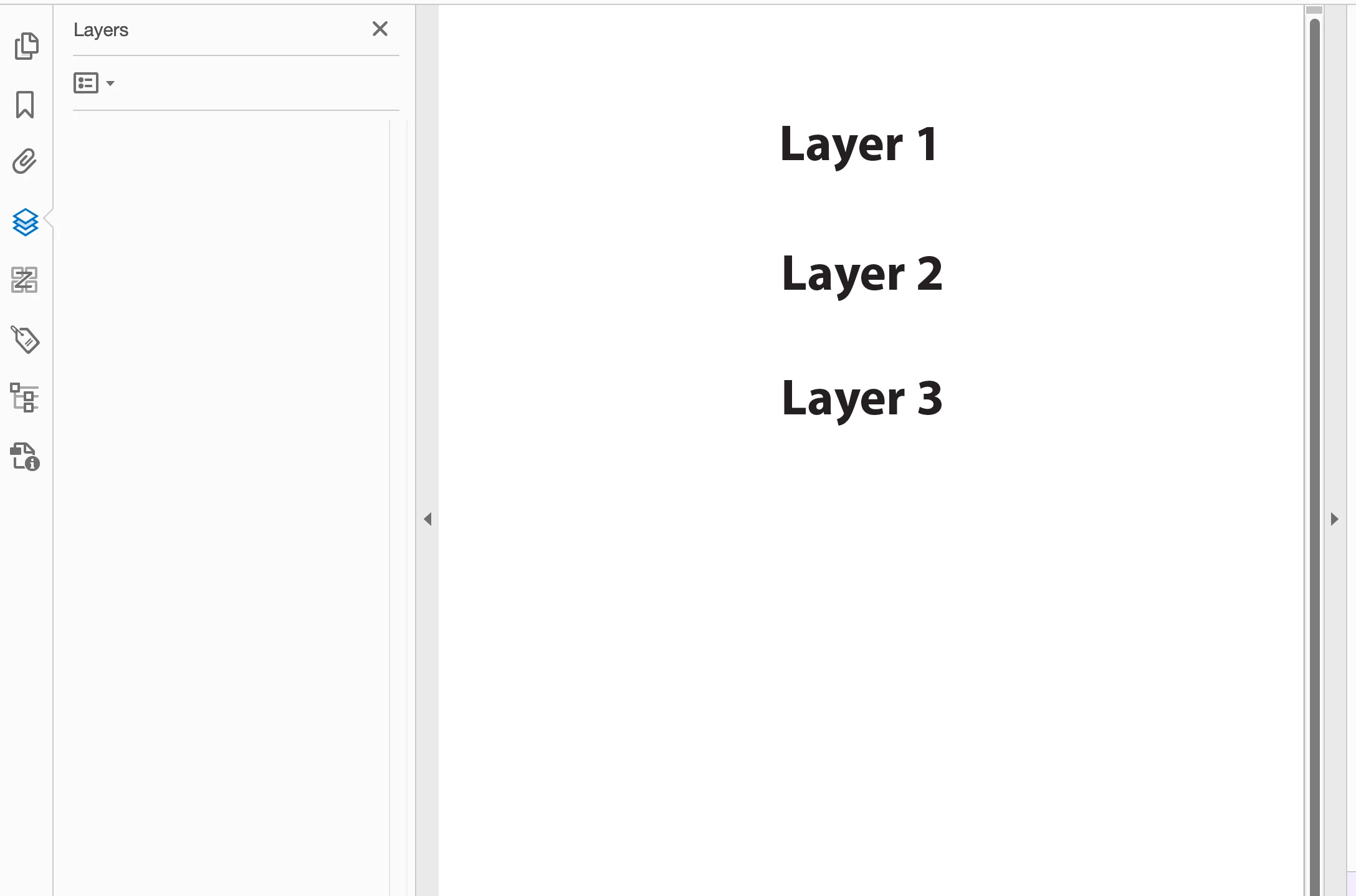

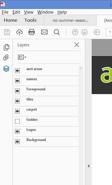

My issue isn't how to export layers, it's how to not have the nested layers (in your example, the layers are nested in a tree, under "layers.indd, in the layers panel). How do I export to have them be separate and un-nested, as in this image:
 The die cutter technician says the software is reading my layers as one layer, because they're nested like in your example.
