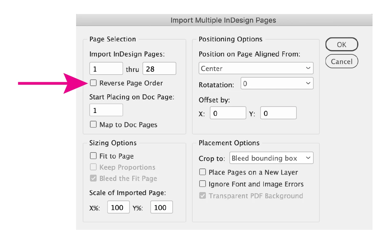

I can think of a few ways to pull this off. The easiest for you, I think, would be to use the Multipageimporter.jsx script. Take a look at the interface:
Seems to me that if you have two 100-page SF novellas, you'd typeset the first one as normal in its own InDesign file, then add one hundred blank pages. Then set up your second novella in a separate InDesign file. Then place the second novella on p101-200 of the first file, while reversing page order and rotating 180 degrees.

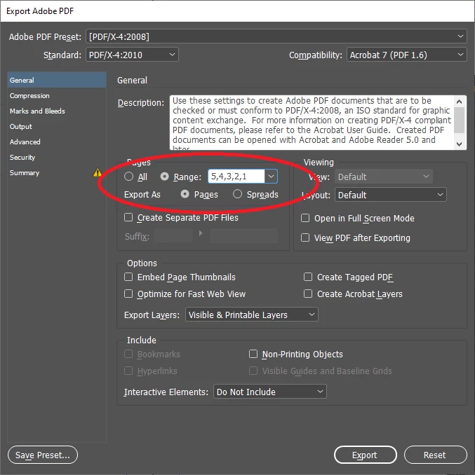

Other options exist... for example, if you'd rather do everything manually, then you could lay out both books normally in InDesign, and then your reversed-book could have each frame rotated by 180 degrees, and then when you went to export your PDF for merging in Acrobat, you could export your pages in reverse order:
That creates a backwards PDF for your merge in Acrobat.
But, if you wanted to use the script, here are the basic steps:
1) Download that script from Github
2) In Indesign, open up your Scripts panel Window -> Utilities -> Scripts
3) In your Scripts panel, find you User scripts, then right-click and choose "Show in Explorer" (or I suppose "Finder" if you're on a Mac)
4) That will spawn a window. You can drag the .jsx file you downloaded and drop it into the Scripts Panel folder.
5) Then, you make your two normal novella-INDD-files and use the importer script to import one into the other, with page order reversed and 180 degree rotation.
