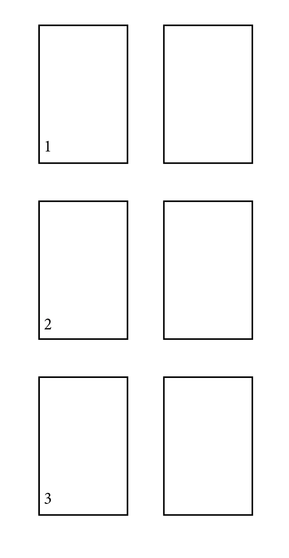

Hi everyone. I have to create a lay out of a deck of cards. I wanted to know if it is possible to tile the front and back of the card without them being attached (so I keep the margins under control) and if it is possible to number only the cards on the right (which would be the front of the card) I attach example. Thank you

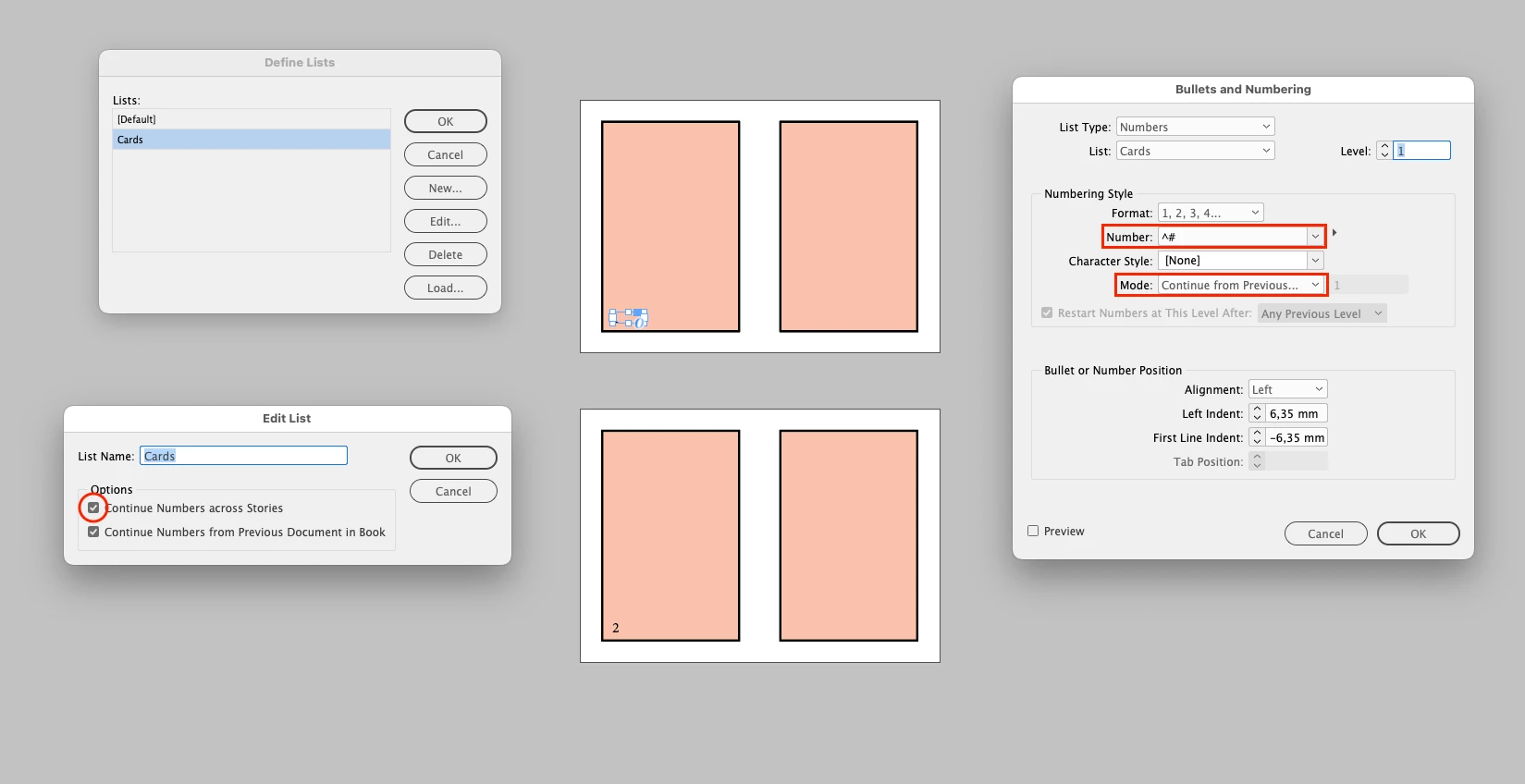

@mathiasmazzetti as Peter pointed out this could be produced as a work and turn job. An alternative for the numbering could be setting it up directly in InDesign with numbering across stories. Create a text frame and activate numbering, add a space character then edit the list and numbering options as in the screenshots below (that will eliminate the dot after the number). You can use either Paragraph or Character Styles for the numbers. That should work, too.
