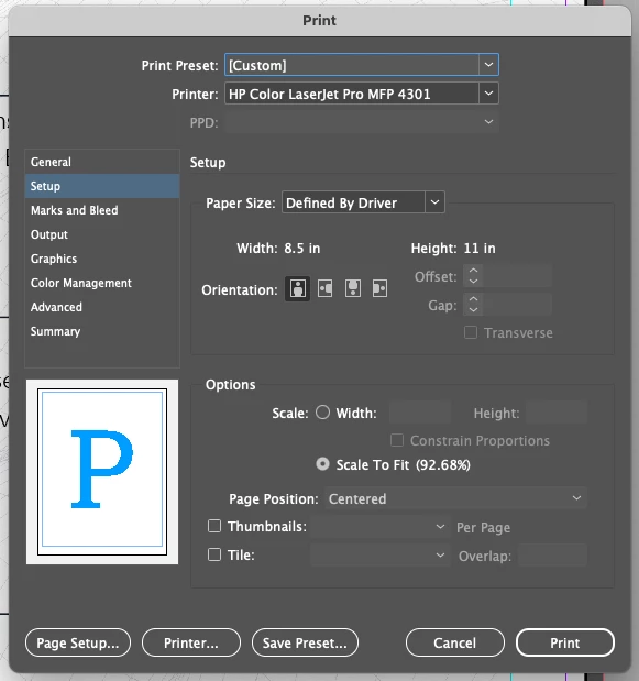

I just wanted to ask if anyone knows why this is a thing. I create a US Letter sized document in InDesign, create the document based on the guidelines provided with a standard bleed, and when I go to print the design does not fit onto the letter size paper in the printer.
For the past 20 years, my fix was just "Scale To Fit"... but why? Why is this a problem?
Am I doing something wrong? Do I need to create a document specific to each printer's margins? Or is this just the nature of the beast?

You say you've included a "standard bleed." That increases the docum,ent size if you select to include the bleed in your print or export settings.
Additionally, your perinter does not have edge-to-edge printing capability if you were expecting that.
Feb 8, 2025 12:11 AM UTC
Standard meaning 1/8th of an inch all around. I ignore this when printing to office printers and such.

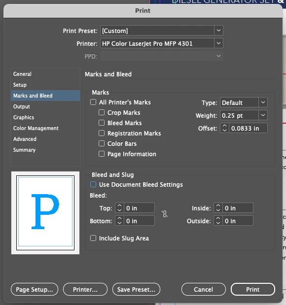

Can you post screenshot of Marks & Bleeds tab?
Because, if you're adding bleeds / crops - your final paper size becomes US Letter + whatever values you've entered there.
Feb 8, 2025 12:10 AM UTC
I've ignored the bleed for normal printing.
