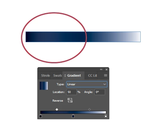

I'm tried to create a gradient that has my primary color in the center and fades to white on the right side and +20% black of the primary color on the left side. When I set this up, the color actually looks lighter than the primary color for a time between the primary color and the +20% black color. I tried adding a mid-way color between the primary color and 20% black but the lighter hue still shows up between them. I tried removing the primary color, but I need it to be represented right in the center. How do I stop the gradient from getting lighter before it gets darker?

    Please check your left and central Gradient stop. Sometimes you can find there two or even more points laying one on another
    What is your white?
    Two of these blue colors - is it tint or new swatch?

    Hm, I shut InDesign down earlier and just restarted it to get this information and now the gradients don't seem to be having the issue anymore. They're smooth from the darkest color to the primary color. Maybe it was just my session of Indesign?

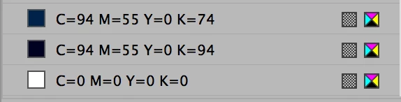

    All of the colors are CMYK, white = 0, 0, 0, 0, the primary dark blue is 94, 55, 0, 74, and the darkest blue was 94, 55, 0, 94. I did not use the tint property on the darkest swatch.
    Here's the exact same setup as the above, now:
    Maybe just a hiccup?

    Can you show the Swatch definitions so we can try to reproduce this?
    1. Is white actually paper or is it white?
    2. Show your Swatch definition for the dark color. Is it Pantone? CMYK? Something else?
    3. Show your definition for the 20%. Is it a Tint Swatch?
