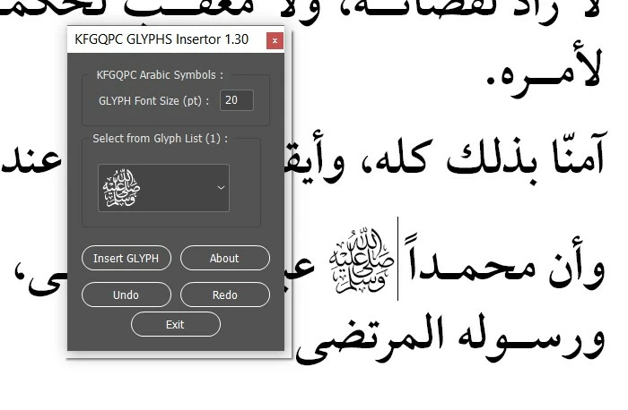

Hi @Manan Joshi , thanks for asking, actually i develop little utility to insert glyph like this :
So i was wondering if i click (Undo) it will only (Undoing) what script is making and not going too far to undo other than script, and thank you a lot
