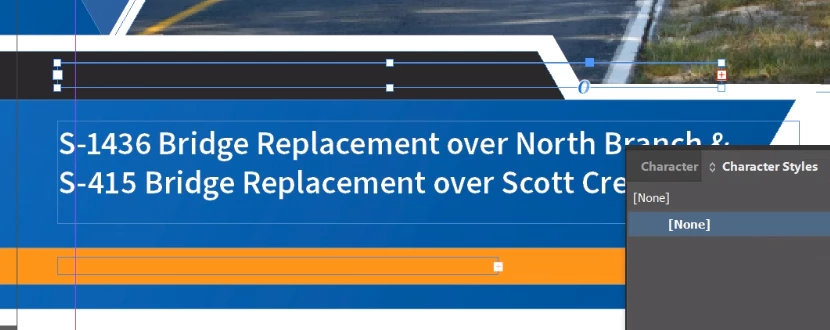

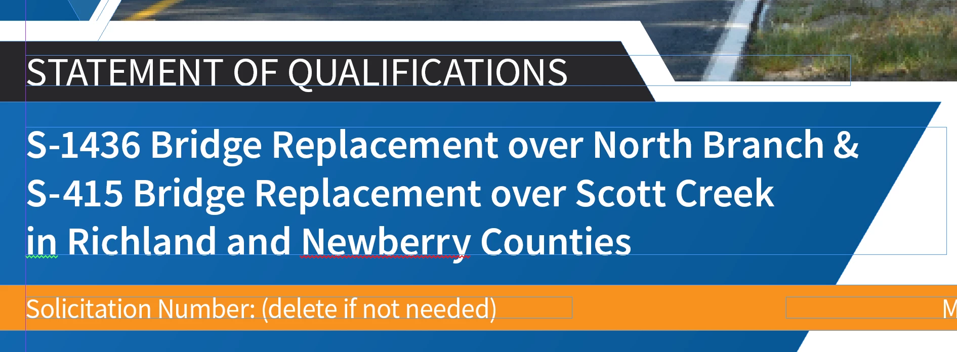

I have created a template for our proposal team to use as a standard. However, when some users open the file, the text shifts down out of the text box because there is extra spacing above the first line of text. For some of us, the text fits closely to the top of the text frame and appears as it should
I don't have the same issue on my computer, and haven't been able to recreate the issue and thereby trouble shoot it to the full extent.
A team member and I have both deleted our preferences to restore the default settings, so we should be starting from the same place.
What setting could I be missing to have it appear the same on both computers?
How it looks correct on my screen: Notice the text line starting with S-1436 is at the top of the text frame.
How it looks on other screens: Notice the extra space above the line starting with S-1436.

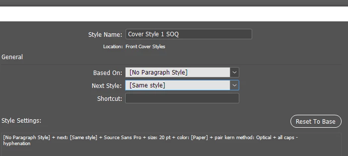

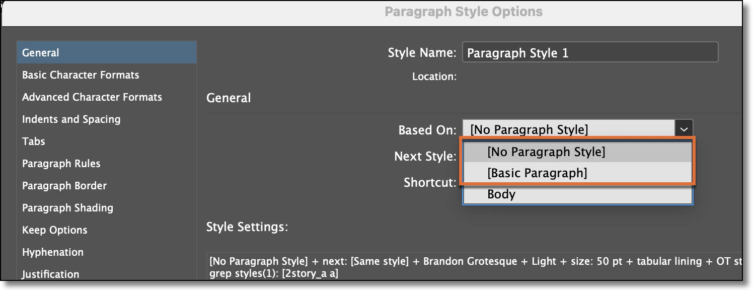

Are the paragraph styles based on [Basic Paragraph] or based on [No Paragraph Style]?
~Barb
erics60158124
February 25, 2021
They are all set to No Paragraph Style.
