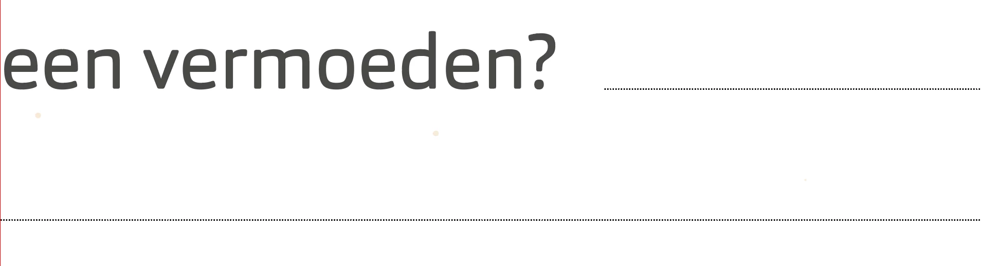

I was wondering if someone can help me create a paragraph style which uses lines as well. Not normal 'rules on/below with the width of the text or column'. I need 2 styles:
The first is paragraph text (with different use of words), which ends with a dotted line tot the end of the frame. The idea is the line is to fill in text. But because every sentence is longer/shorter, I need the dotted line to start after every sentence with an x amount.
The second style needs to be an only 'fill in line' from the left to the right of the frame. It will be used when there will be more fill in text needed.
I don't want to use normal lines, as there are too many needed.
Please see the example image...
Thanks for your iput

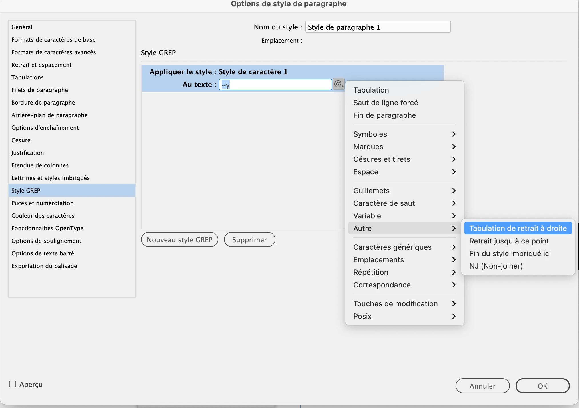

  1. Create a Character style with the line.
  2. Create a pararaph style with a GREP style, when a right tabulator (shift+tab) the Character Style is applied
    3. Write the text with a space (choose any fixed width) and shift+tab, or shift+tab.

It sounds that I'm looking for this solution. Unfortunately I don't know how to make a shift+tab as a shortcode (expression?). Or is it ^/t?

jmlevyCommunity ExpertCorrect answer
November 9, 2022
In my French version, it is ^y. No, that's for nested styles, for GREP, it is ~y

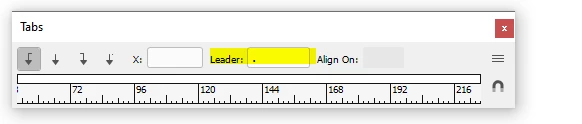

Set any tab stop in the paragraph style you use for that text. Set the Leader to a dot
Then insert a right-indent tab (after 'een vermoeden?' and at the start of a blank line. You can use the same style for both types of line (with or without text).
