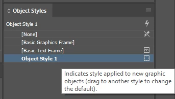

@Uwe27613699agqk
Or you can use ObjectStyles to either apply AFTER you draw your line - or if it's a default and currently selected / active ObjectStyle in the Pallet - it will be automatically applied:
Icon at the right side of the Objext Style name indicates which one is currently the default.
