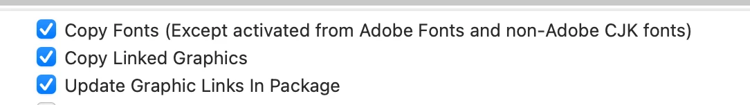

leo.r
Sep 27, 2024 6:16 PM UTC
Just in case: do you have the 'Update graphic links' option selected:
