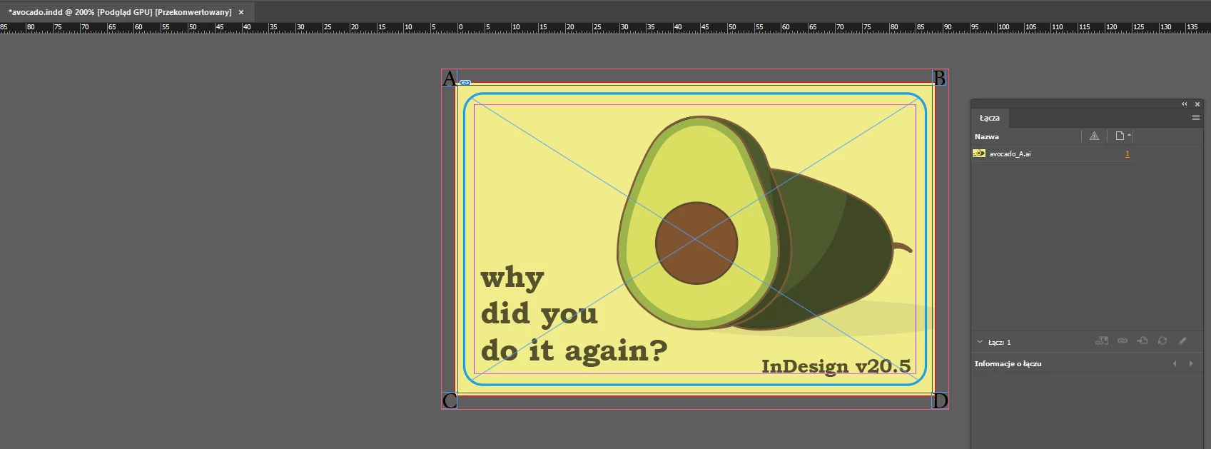

Linked InDesign 20.5 Files Rasterize When Exporting from InDesign 21.0
Good morning,
I’m having an issue with Adobe InDesign 2026 v21.0.
In my project, I have two linked InDesign files – one created in the newest version of the program, and the other in an older version 2025 v20.5.
When exporting to PDF, I noticed that the file originating from the older version of InDesign is exported as an RGB bitmap with a resolution of 72 PPI, while the newer one exports correctly and retains vector data.
In InDesign’s preview, everything looks fine – the issue appears only after exporting to PDF.

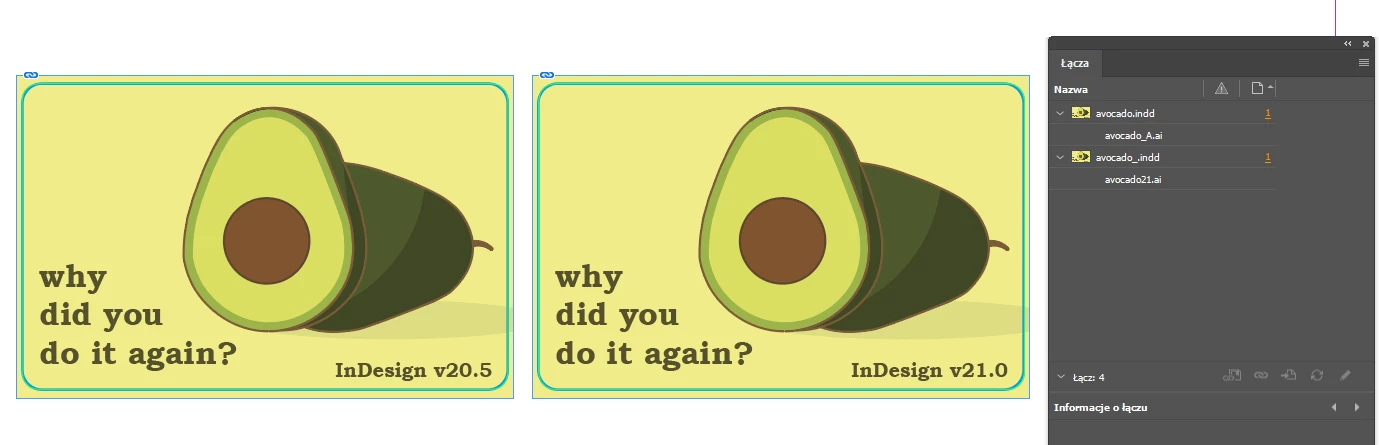

Mai 19, 2026 6:31 PM UTC
MacOS 15.4.1
Two Screenshots of consistent issue with placed INDD files with placed PDFs.
Other issues with Certain Type of Placed PDF files in INDD when Exporting and Printing.

grupa 3 druks45568294
Nov. 6, 2025 1:43 PM UTC
I’m sending the complete set of files.
avocado_print.indd is the main file that contains links to the other InDesign files.
Übersetzen
Nov. 6, 2025 1:52 PM UTC
I can`t send AI files..
The attachment's avocado21.ai content type (application/postscript) does not match its file extension and has been removed.
