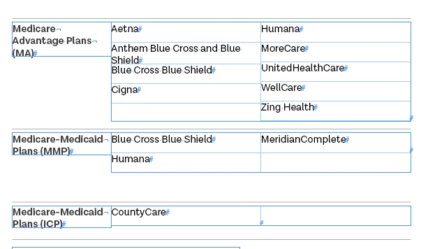

I have three separate tables that I need to link/flow one after another so when the first table fills the second table will start right after the first, no matter how many records are in the first table.
There are two special things with each table.
On the left of the table is a header for that table and then the table actually fills in as two columns.
I have attached a screen shot that shows the tables filled with data but when I try and anchor/link/flow them, the tables overlap each other.
When I anchor the tables into the same text box the text box flows to the same size as the left header text box and if the table has a lot of entries the table grows down outside of the text box which then overlaps the table below.
as seen in the second screen shot.
Any help would be apreciated.

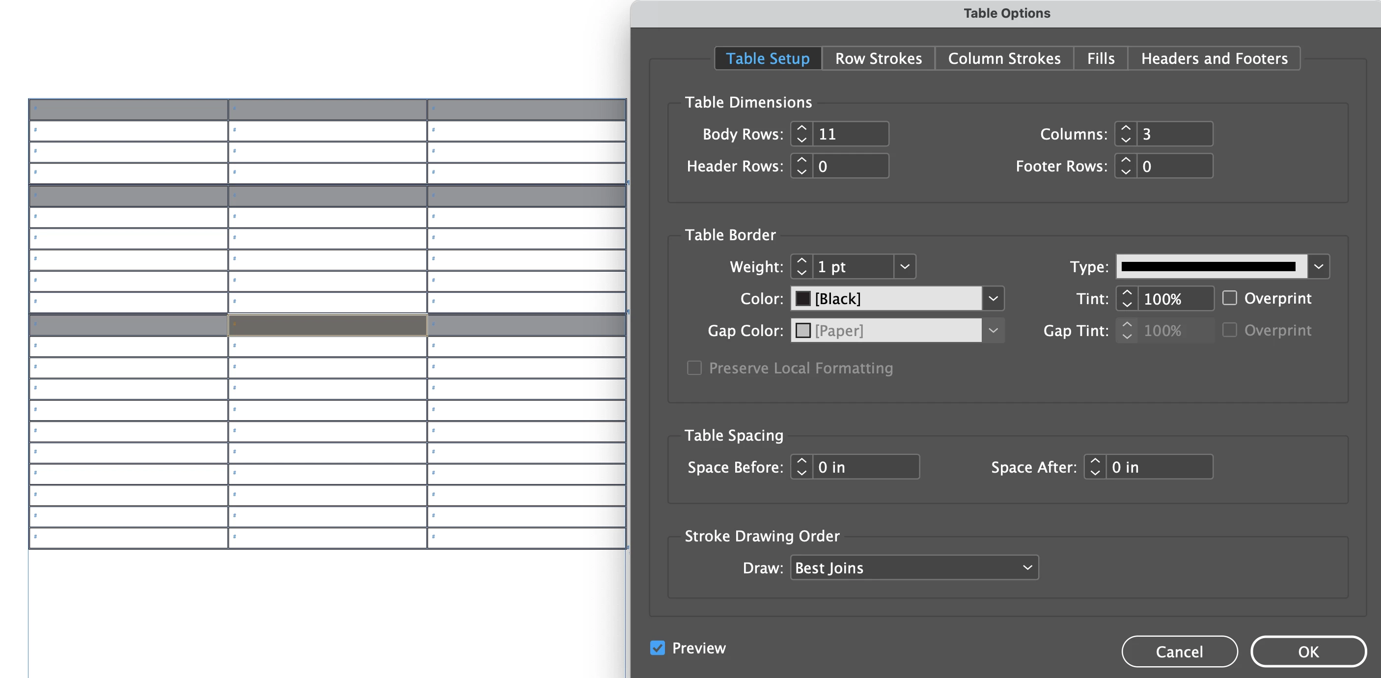

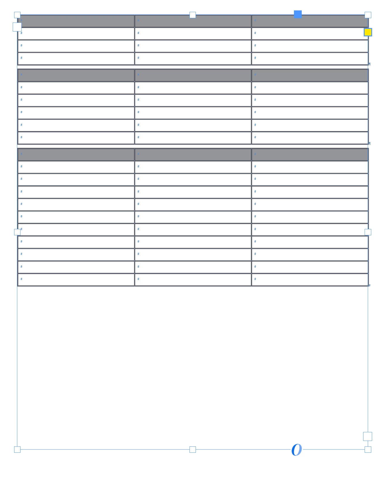

No need for anchoring; you can create all of your tables in the same text frame. If you need them to connect, you can remove space before and after.
SJRiegelCorrect answer
August 18, 2022
Dave Creamer of IDEAS
August 18, 2022
Ahhh. I thought the OP was just using that term for placing the tables in the same frame--not literally anchoring them. Good catch!
August 18, 2022
The problem of the tables overlapping each other is what pointed me to anchored objects; tables in the same frame would not do that.
August 18, 2022
Try setting the leading in the containing text frame to auto. If that doesn't work, can you upload your sample file?
