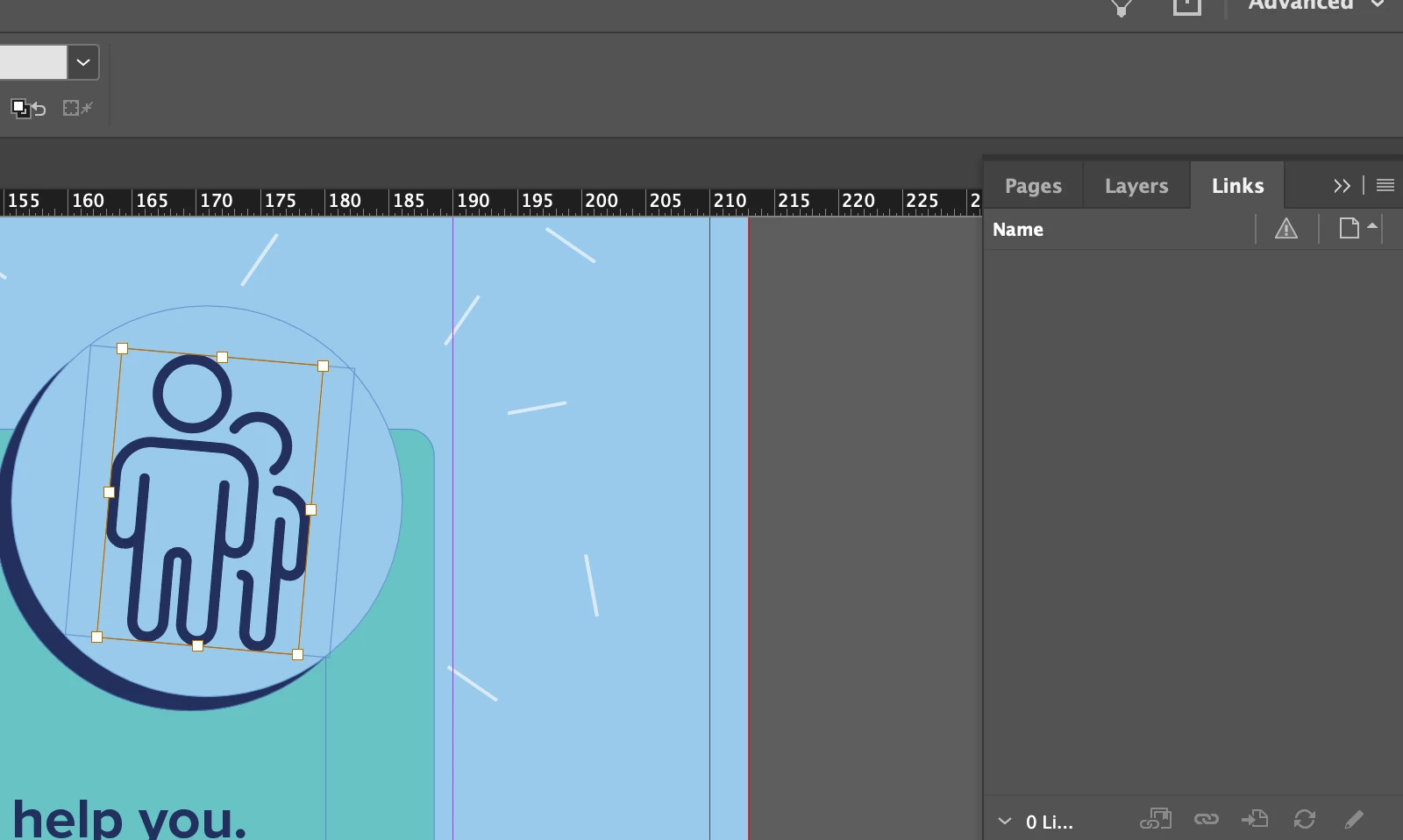

I have received a packaged file from a client with .indd and .idml files. There were no packaged links supplied even though there are graphics in my document, but the links panel is completely empty and shows no linked files, missing or otherwise. This is only happening for this set of supplied files, all other files are showing the links. Obviously this won't fix the fact that my client hasn't supplied any linked files but obviously I just want to know what's going on? (Closeup screenshot attached)
Anyone come across this before?

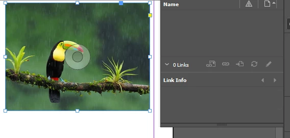

Usually means they have just copy and pasted the images from somewhere else, like Illustrator directly to InDesign.
I copied this image from a web page and pasted it directly into InDesign

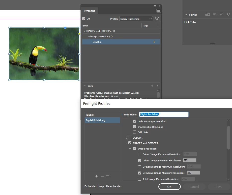

But you can still check resolutions via the Prefight Panel
https://helpx.adobe.com/indesign/using/preflighting-files-handoff.html

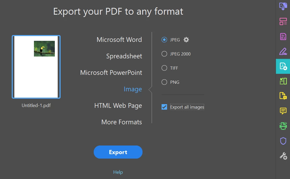

If you want all the images
Expor to PDF and don't add any compression or colour conversion - just export the pdf at highest quality with nothing converted to anything
Open the PDF
And Extract the Images it's the blue icon on the right - and select Export as images at the bottom.
You can then go about linking them.

Unfortunately in this case what makes it strange is the mising graphics are vector. Usually if you copy and paste from Illustrator they remain editable but in this case they're flattened. A quick pdf export, opened in Illustrator, reveals that they are still in fact editable vectors, I just can't touch them in Indesign.
I think I may have to rip them out the pdf and add them back in. Seems like a bug to me.
