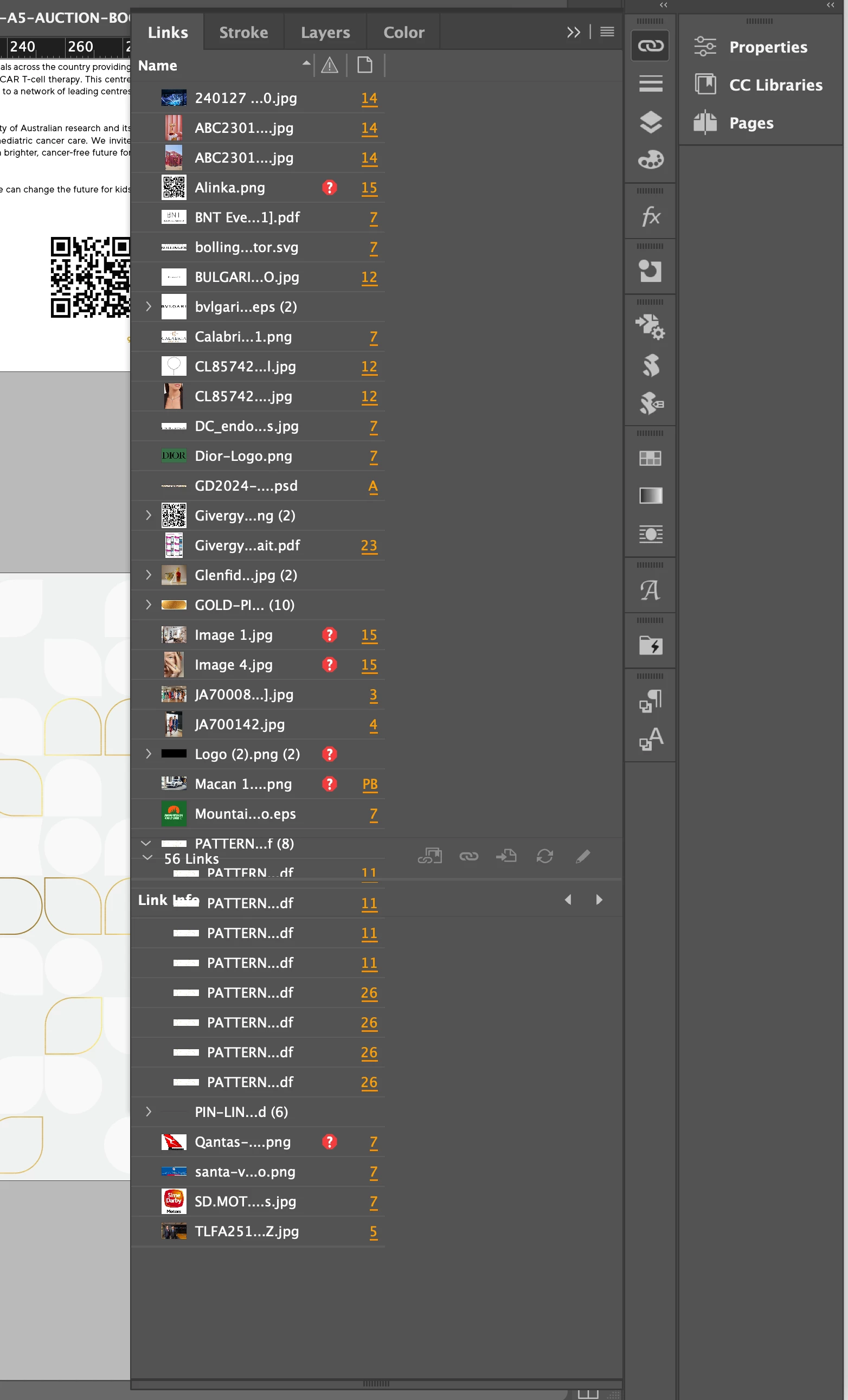

Ever since we moved to InDesign 2024, we've noticed that the Links Panel will often overflow with linked assets and cause the panel to become unusable.
To reproduce this, you first must have a lot of unique links in your document.
Open the document and select one of the assets on the page, such as an image. The links panel will try to highlight the link, but it will get jumbled up and overflow with other links in the document.
I have attached a screenshot of what we're getting.

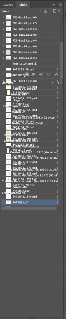

    I also have had this problem for the past year over several versions of Indesign. Links panel overflows info panel and becomes unusable. Reset preferences and change workspaces did not fix.
    MacOS 15.6.1

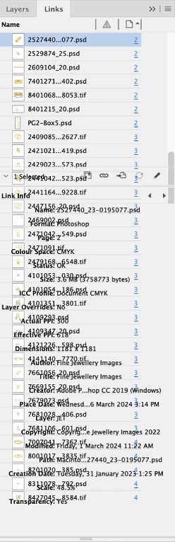

    I have been getting this as well for the past 2 weeks. I work in publishing, I have hundreds of links in some of my documents. It has made InDesign practically un-useable. Did anyone have a work around? I have also left a report on uservoice. Help
