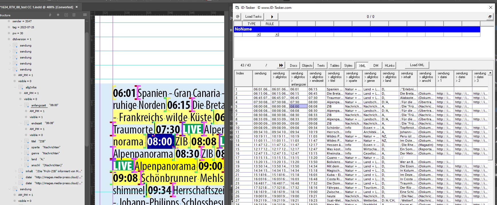

If you work on a PC - and have a lot of those to find / fix - piece of cake with my ID-Tasker.
Before:

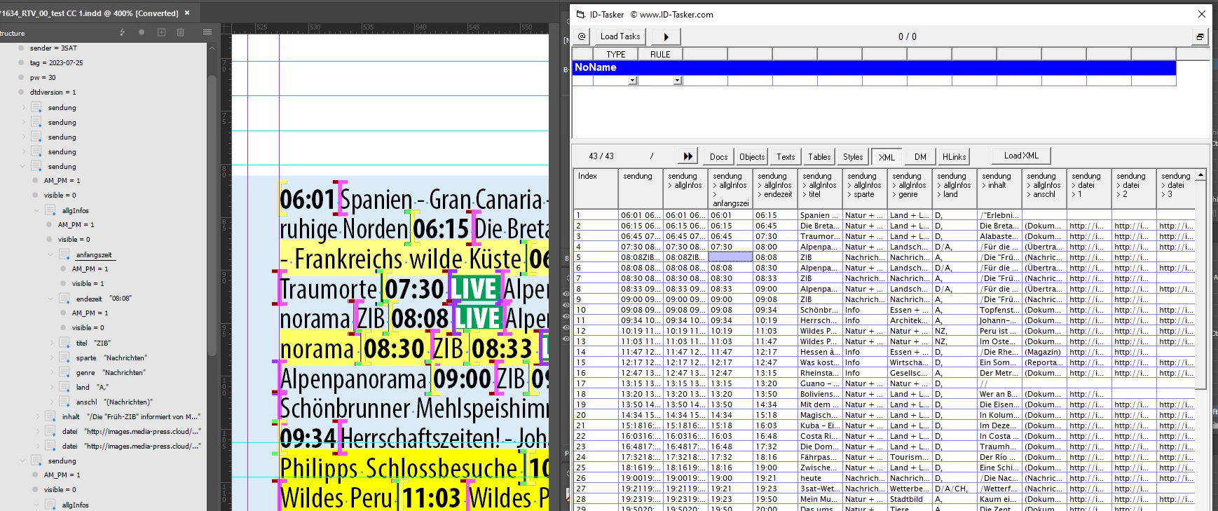

After deleting selected text:
You could use as it a Browser (free) or Preflight (paid) - or even Editor (paid).
IDT converts XML into a "flat" database - and from there - you can do pretty much anything.
And, as always, you can automatically process multiple files.
