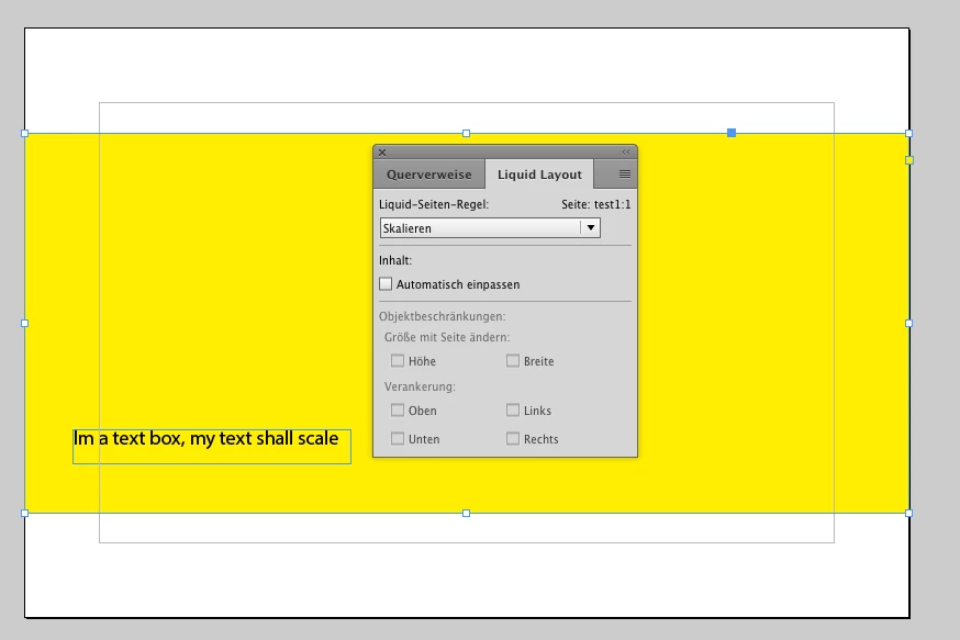

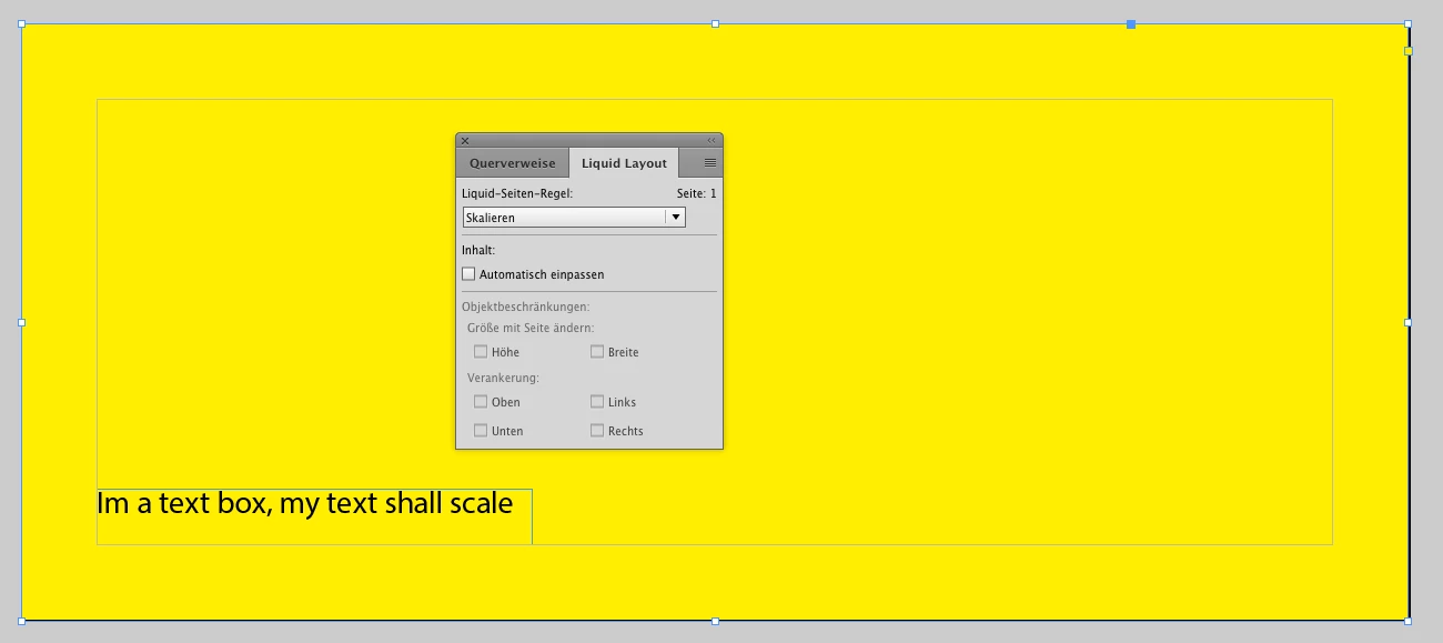

First I tried "scale" and ended up with the background (just a yellow box) wont filling the page, but the text is behaving like I want:

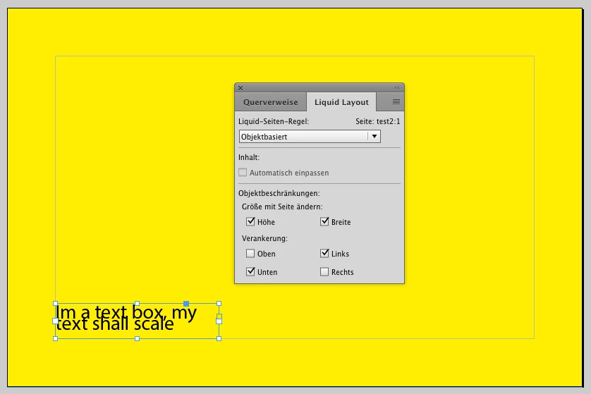

Then I tried the "object based" method, background is behaving like it should, and then I found out that the textbox bounds are scaling without adjusting the text size, resulting in overflow text…(not actually in my test file, but you could imagine that the text should not and cant reflow)
Since this is a simplified test file, my complex final ad has to work with "object based", but the text has to scale…i cant just text2path because it has to be editable.
Is there a solution for resizing text/scaling textboxes in "object based"-liquid layout?

Michael, if i dont get you wrong, but this has nothing to do with liquid layouts and is basic when working with InD. Im not talking about scaling objects, im talking about not having that option with textboxes while it comes to "object based", the text 'shrinks' if I go from A4 to A3…and if I dont want that, im bound to 'scale' everything to keep spaces filled…and thats a problem if the template should work with different values for width and heigth.
As you can see, if I want my canvas to be filled, im bound to liquid layout page rule 'object based' althou the headline is scaling fine.
As I have to choose object-based page rule, my text starts to reflow. I would be fine with the LoremIpsum-text to reflow, but if I have something like a headline (…and i dont want text2path and be able to edit) i should have an option to reflow or scale.
