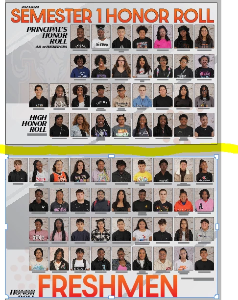

Trying to adjust pages using liquid layout.  When changed layout snaps back to original parameters.
Am I missing something?

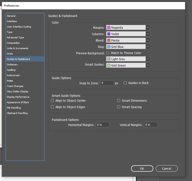

Pages sit upon pasteboard regions. Adjust the spacing of pasteboards by going to Edit > Preferences > Guides & Pasteboards > Pasteboard Options ... Vertical Margins

I set all to 0 and it still is not allowing me to close the gap, very frustrating.
Please advise.

I am trying to eliminate the space (yellow area) between pages.
Can you please help with this?
