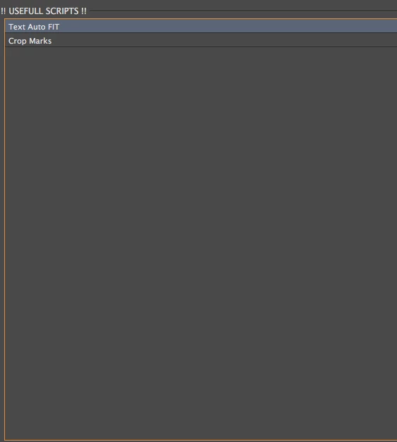

Is it possible to Run a different script from a listbox?  I have a listbox that will have a list of several different Scripts (Most used scripts). and when the scripts are selected from the list i want them to Run.
var Pan1=w.tabs[0].add ('panel {text: "!! USEFULL SCRIPTS !!", preferredSize: [-1, 200],orientation: "column",alignChildren: ["left","Center"]}');
        mL = Pan1.add("listbox", ["0", "0", "600", "600"]);
    with (mL){
      for (var i = 0; i < 1; i++)
        mL.add ("item", "Text Auto FIT" ) // Run this script and the one below. etc...
        mL.add ("item", "Crop Marks");
        mL.revealItem (mL.items.length - i/1);
    Pan1.show ()
Correct answer Stefan Rakete
Hi cbishop01,
for CC change this line:
//mL.onClick = function() {
mL.onChange = function() {
Thanks Stefan

Here is a sample to see if it would work with app.doScript:
var w = new Window ('dialog {text: "Script List", properties: {closeButton: false}}');
var Pan1 = w.add ('panel {alignChildren: "left"}');
with (mL) {
          var listItem1 = mL.add ("item", "Text Auto FIT" ) // Run this script and the one below. etc...
          var listItem2 = mL.add ("item", "Crop Marks");
    var curSelection = this.selection.index;
    //alert ( "You clicked item: "  + this.selection.index );
    switch (curSelection) {
      case 0:
        app.doScript(script1);
        break;
      case 1:
        app.doScript(script2);
        break;
w.show ();
function script1() {
        alert ("run Text Auto FIT.jsx");
function script2() {
        alert ("run Crop Marks.jsx");
cbishop01Author

Yes possible..use selectedIndex and with that selection use #include <script.jsx> or #includepath<your script path>
cbishop01Author
July 12, 2016
Do i add the selectedIndex in the function(){ area?  THe alerts are working but i cannot figure out how to get the scripts to run.  Does it matter if its a dialog or pallet?  Right now its a dialog window.
