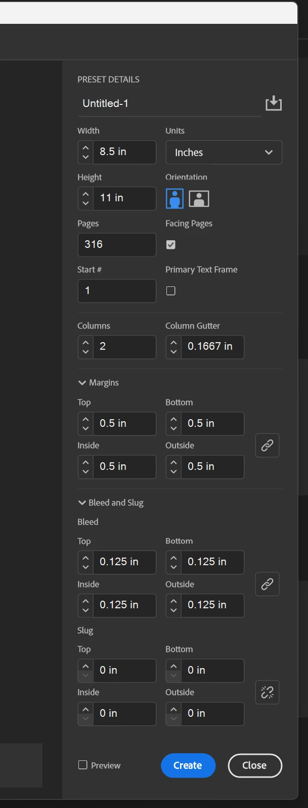

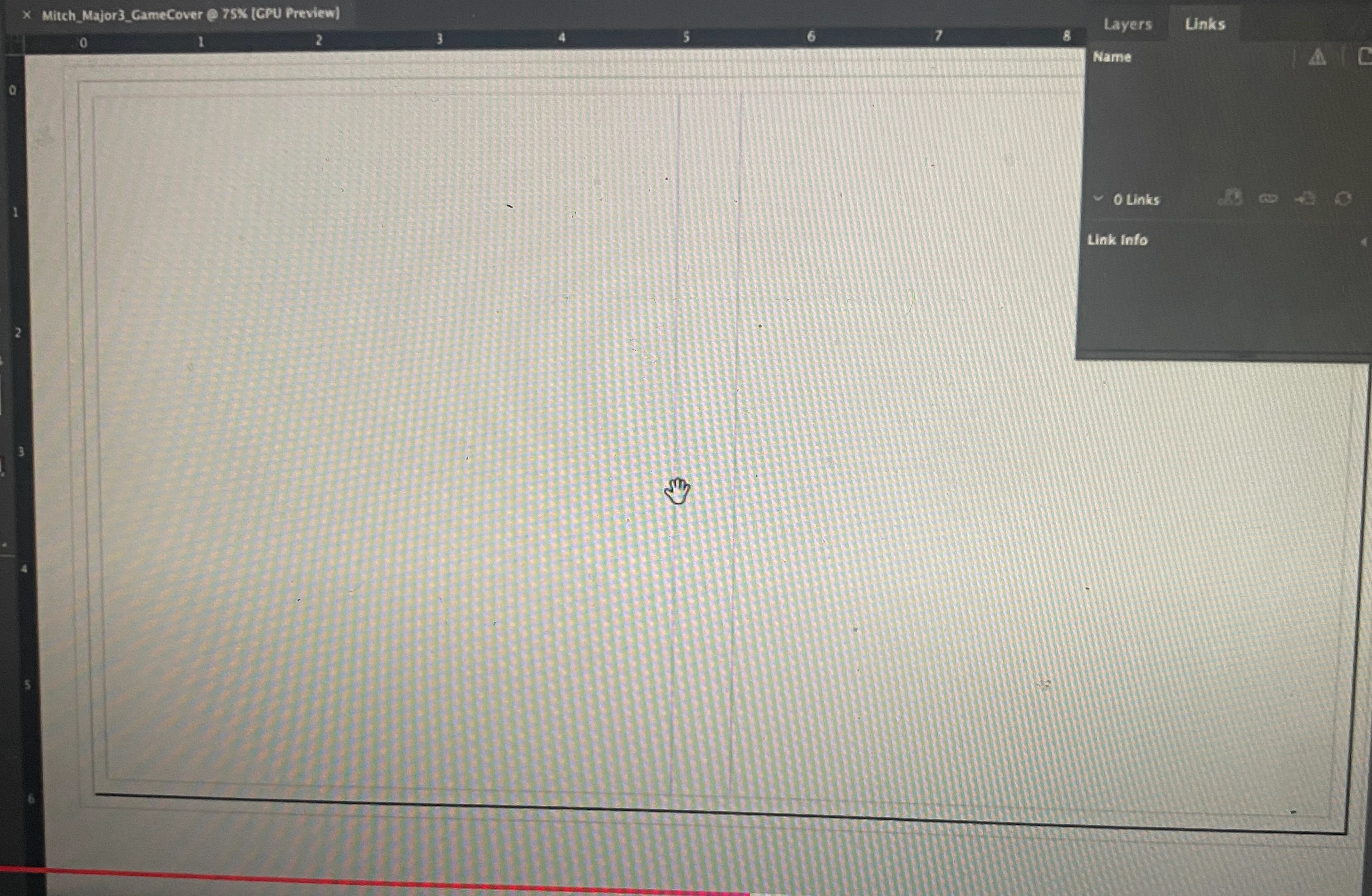

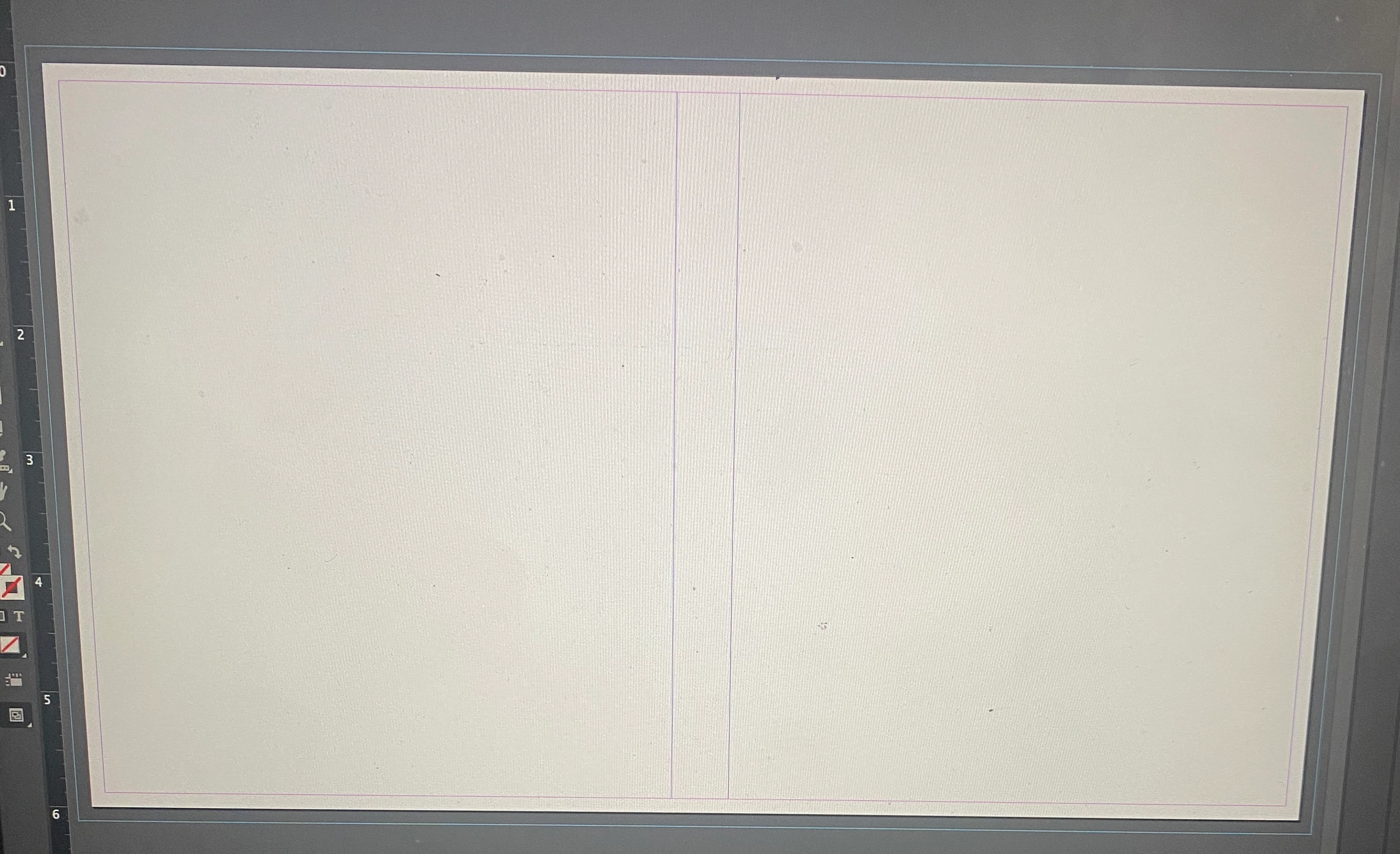

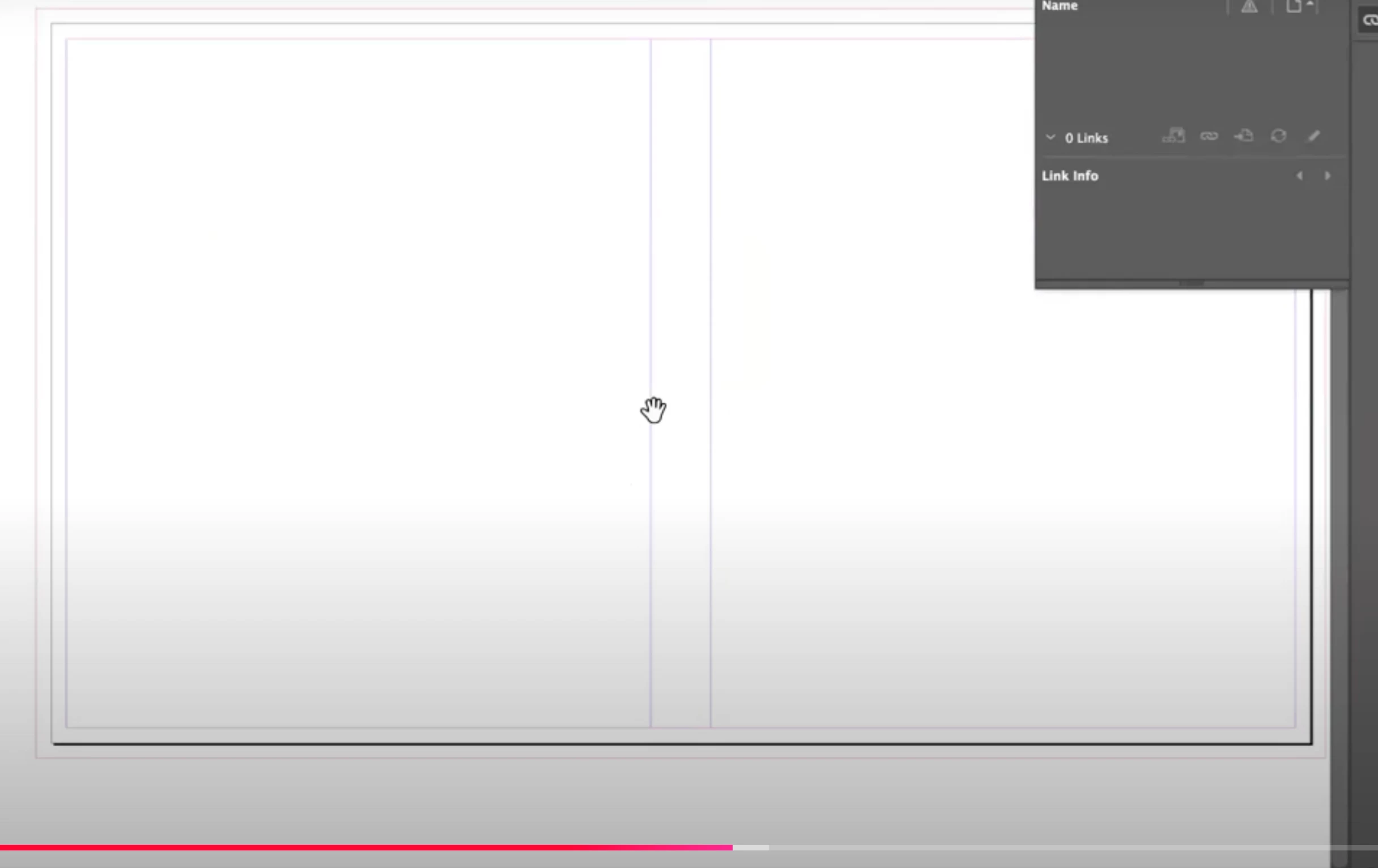

I need to set this template up for an assignment I'm doing. I put the exact same units in from the tutorial video for the assignment but the live area and margins still aren't visible on my document.

By default, margins are pinkish color and ruler guides are blue/cyan. It looks like you just have margins set. Consider learning how to do a screen capture rather and taking a photo of the screen.

Show your setup screen:
