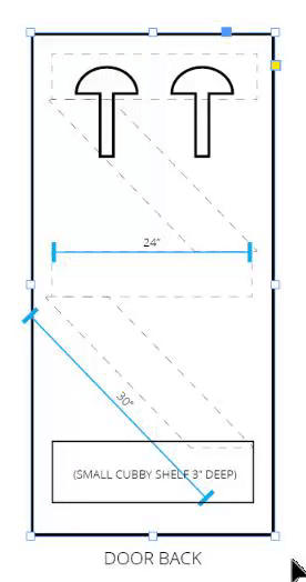

Hello, I seem to be missing the lock/unlock icons. I've gone through tutorials and forums to figure out why I can't just unlock the items I lock. It works sometimes on new projects, so I know how to unlock an object, but the lock icon just isn't visible in some projects. I've looked at forums that tell me the problem is in my "view" settings, but none of them have worked. The GIF below demonstrates that the unlock icon won't show up on an item that I've locked using ctrl + L.

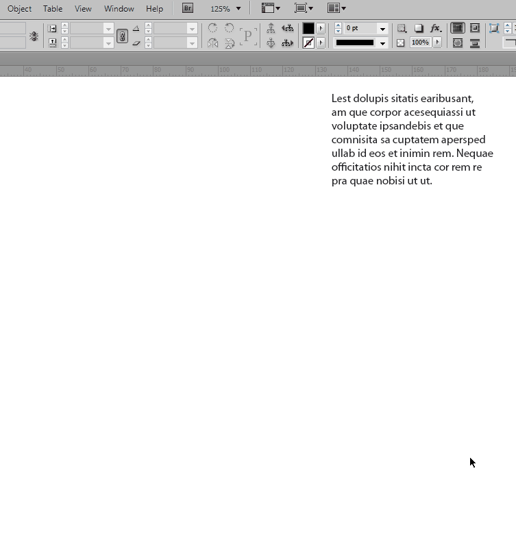

    Just another, the last thought: in your animations I'm not able to see actual 'Frames Edges' despite you show them turned ON from menu. I thought, object outline hides it. Now I'm in doubt.
    What if you: create text frame, lock it, ensure showing of Frame Edges is on (just like in my sample). Are you still seeing frame edge when object is not selected? You should, with 'lock' icon on it. Two things prevent frame edges from showing up even when they are set on:
    1. Overprint Preview mode (not your case, I see it is OFF).
    2. Screen Mode set to Preview. Ensure View > Screen Mode > Normal is selected.

    View > Extras > Show Frame Edges
    September 25, 2017
    Thank you for the thought, but that didn't change anything. The exact same thing happens, and I tried your suggestion twice
    winterm
    September 25, 2017
    Aren't we talking about this?
