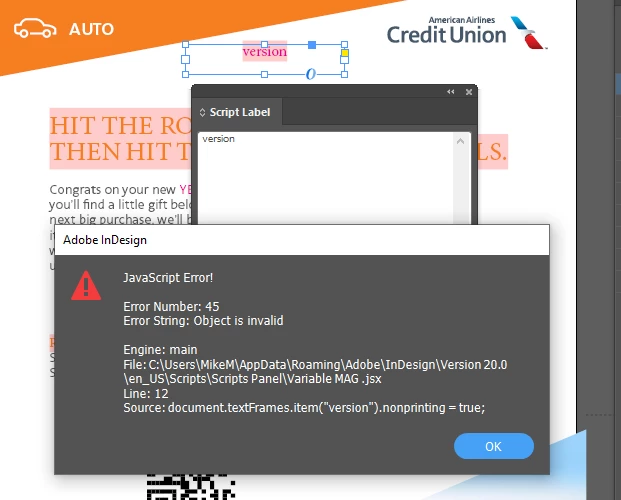

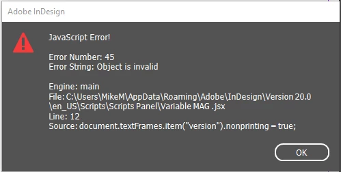

Make a text box attribute non-printing in InDesign v20.1 using JavaScript
I had so much success with my 1st post (question) Thanks @rob day Next question. Have a text box at top of page that is the document version. For proofing to client, I need this to print so client can see what version they are looking at. But when printing the live print I need to make this texy box non-printing. Looking for a script that can make text box non-print.  I have tried this script:
document.textFrames.item("version").nonprinting = true;
I have the text box labeled using script label as “version” (with no quotes).
I am getting below error:

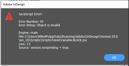

I also tried the below script:
var version = doc.textFrames.itemByName("version");
version.nonprinting = true;
Getting this error:

Hi @WCMProduction ,
in your specific case I would avoid the Script Label panel.
Instead I would simply name the text frame "version". Either do this using the Layers panel or by scripting when the text frame is selected:
app.selection[0].name = "version";
Then your code will work as expected:
app.documents[0].textFrames.itemByName("version").nonprinting = true ;

May 9, 2025 6:41 PM UTC
Are you sure you really do have a text frame named "version"? Your second script does work for me, unless I'm using a non-existent name, in which case it returns the same "Object is invalid" error.
