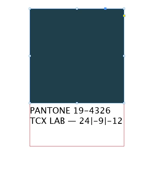

Hi, I am trying to use a script that will add a text box underneath the swatch box in a document. I found an applescript that does this, but it also adds the LAB value and I only need the pantone value. Can anyone help with this?  Screenshot below shows what I am getting
I've also attached the applescript

It should work—the script expects a selected rectangle. If you change the application tells to id "com.adobe.indesign" it should work with any version. Also, the original question was how to remove the color values from the label—this would do that:
tell application id "com.adobe.indesign"
	set myDocument to active document
	--set units
	set horizontal measurement units of view preferences of myDocument to points
	set vertical measurement units of view preferences of myDocument to points
	--make a layer and style sheet for the document if it doesn't exist
	tell myDocument
		try
			make new paragraph style with properties {name:"Labels", applied font:"Lucida Grande", point size:5, left indent:0}
			set myLabelStyle to paragraph style "Labels"
		on error
		end try
	end tell
	--get all the page items
	set myItems to selection
	--get the fill color and make a label at bottom
	repeat with x from 1 to count of myItems
		set myFill to fill color of item x of myItems
		try
			my MakeLabel(myFill, item x of myItems, myLabelStyle)
		end try
	end repeat
end tell
--make labels (the cmyk color, the object, the label style)
on MakeLabel(myColor, myRectangle, myLabelStyle)
		set cv to color value of myColor as list
		set n to "— "
		repeat with a in cv
			set a to round a rounding up
			set n to n & a & "|"
		end repeat
		--get the label text
		set x to (count of characters of n) - 1
		set n to characters 1 thru x of n
		set myLabelString to name of myColor
		--set myLabelString to name of myColor & " " & space of myColor & " " & n
		--set AppleScript's text item delimiters to "LAB"
		--set myLabelString to text item 1 of myLabelString
		-- make the label box below the page item [y1, x1, y2, x2]
		set {a, b, c, d} to geometric bounds of myRectangle
		tell parent of myRectangle
			set myTextFrame to make text frame with properties {geometric bounds:{c, b, c + 25, d}, contents:myLabelString}
			tell myTextFrame
				set first baseline offset of text frame preferences to leading offset
				set applied paragraph style of text 1 to myLabelStyle
			end tell
		end tell
	end tell
end MakeLabel
