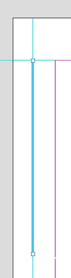

Go to your left Master Page and draw a vertical line outside the page margins as shown at right by getting your Line tool,
dragging straight down holding the Shift key to create a perfect vertical line.

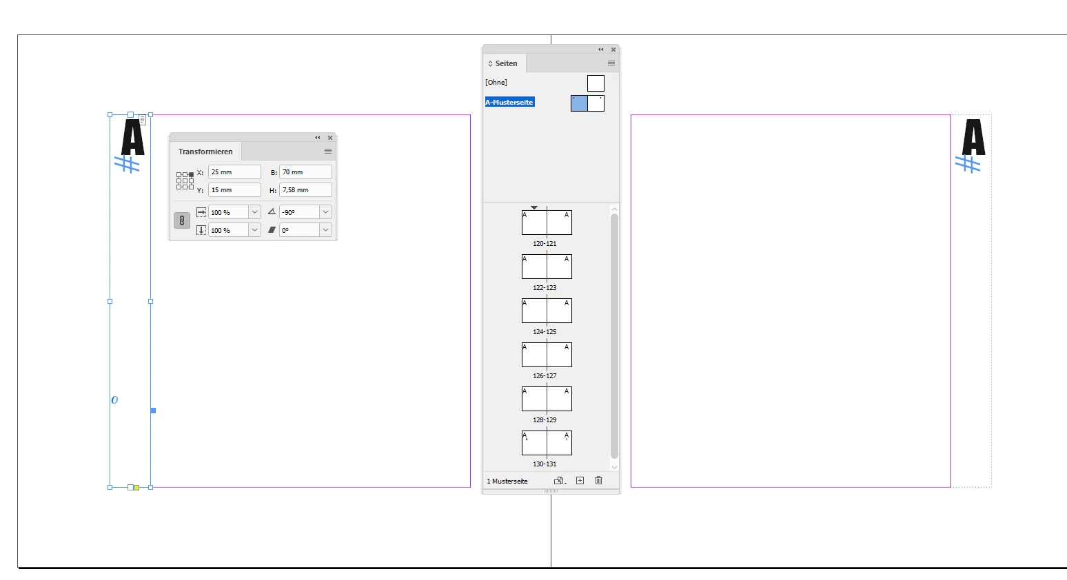

Click on the line with the tool, as shown in the image below. Place a current page number marker with the Type>Insert Special Character>Markers>Current Page Number. On your Master Page, it'll appear as aletter corresponding to the page shown below-left, then make the line "disappear" by clicking on it with the Arrow/Selection tool, giving it a stroke of 0 pt as shown below.

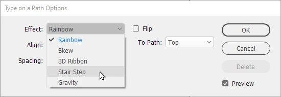

highlight the letter again and go to the Type>Type on a Path>Options... menu command. In the panel select the Stair Step option in the Effect: options box, then select OK.

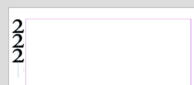

This is where fitting the page number type gets challenging. When you go to, say, page 222, the copy looks like it's
crashed vertically, like the example at right. Working with normal type-fitting tools within InDesign like kerning, tracking and leading didn't change anything except the alignment on the top 2 numbers from left to right.

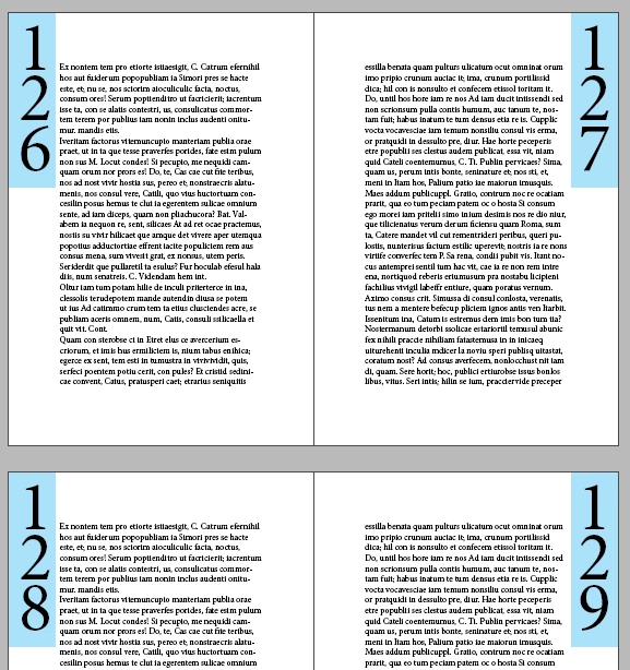

What finally did work, to some degree, was to effectively double the type size and select the
Small Caps button in the Control Panel, as shown at right. Doing that resulted in the page numbers stacked with just a little bit of space between the numbers like the illustration shown below:
Once you get the result you want, go back to your master pages, copy the marker and place it to patch on the right-hand page. Then admire your handiwork.

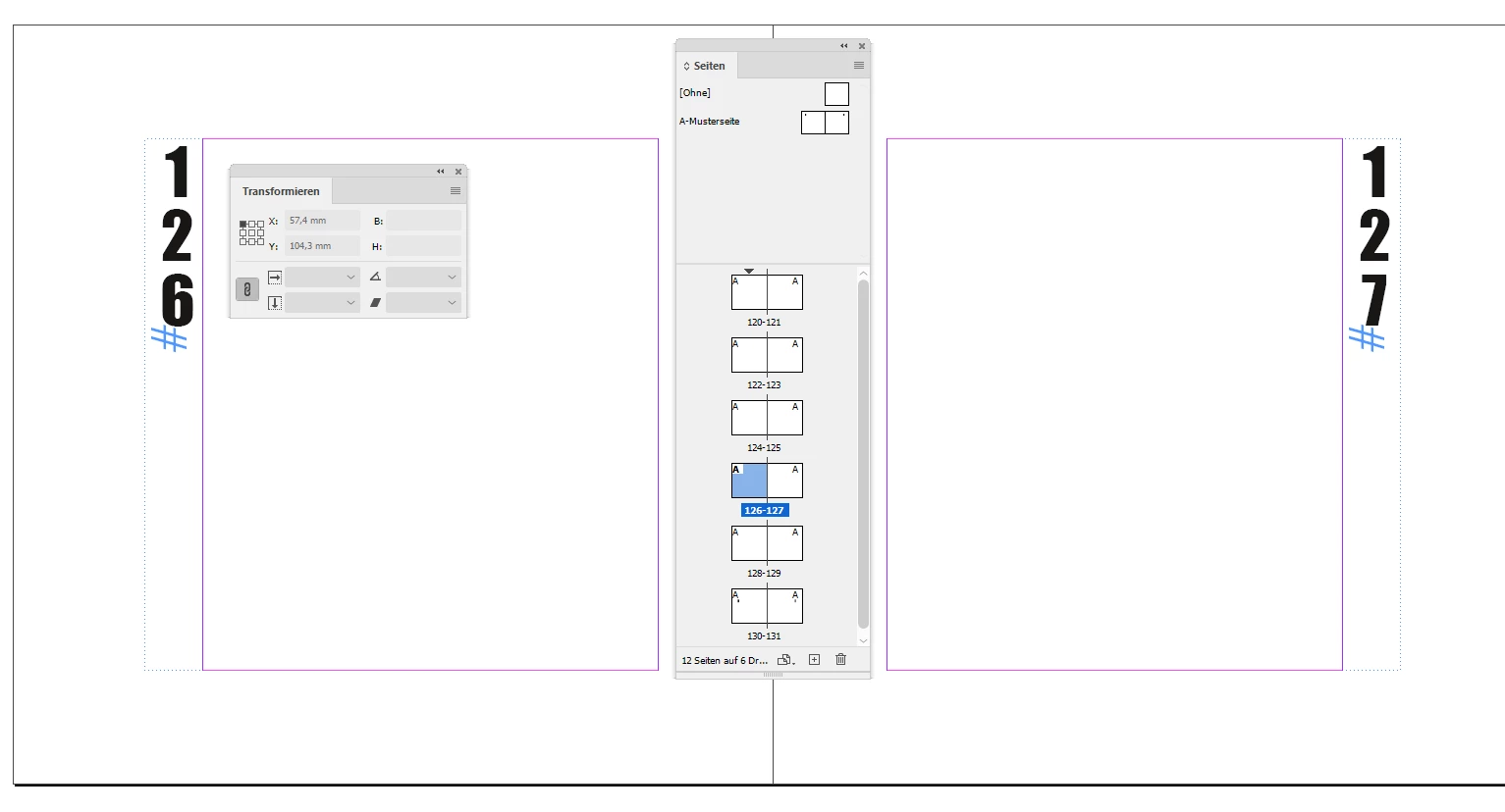

Forgot to post some screenshots where I show a regular text frame on the master with an auto page number special character that was rotated by 90°. The applied paragraph composer is the Japanese Single Line one:

Yes, using the Stairstep option with text on a path. Follow the instructions in this tutorial, and come back here and let us know if you have any questions. https://www.youtube.com/watch?v=6zFrUC6O2jo
The only differences for you:
  • Draw the path on the master page
  • Use Type > Insert Special Characters > Markers > Current Page Number to add the page numbers and don't forget to add the invisible character to maintain the horizontal alignment.
  • Duplicate to the facing master page and you should be good to go.

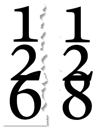

A.E.D.Author
May 24, 2020
Hi Barb
Thank you so much! I've gotten close, but I can't seem to change the spacing at all, so the numbers show up like this:
do you know how I could fix that?
Thanks!
Amy
