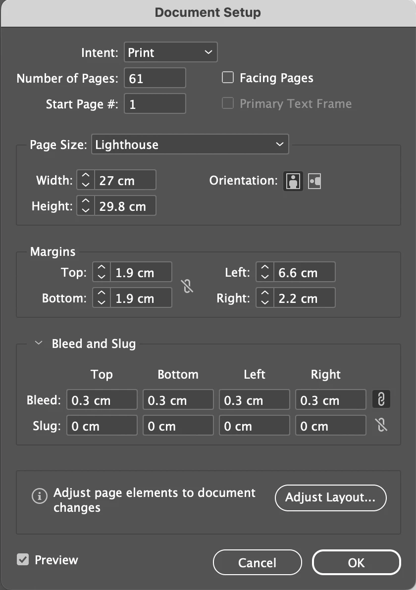

I could use some help printing to a non-standard paper size to a defined area within the page. I am printing individual pages from my document.
I’m using an Epson P700 printer. The paper measures 29.8 cm high and 27 cm wide. I need a margin from the left of 6.6 cm, from the top and bottom of 1.9 cm, and from the right of 2.2 cm.
In my Document Setup, all this is entered. Visually, I see all this, and it looks good. It all measures correctly, using a ruler on my screen.
I have placed lines at the edge of all my margins to check my setup. I also placed a vertical center line. Visually, everything looks good on my screen.
When I print, I have lines printed outside of my defined margins—3 mm to the left, 3 mm above the top and 1 cm inside bottom margin.  The line on the right is not printing, probably because the printer thinks it is outside the margin. And, a center line is 1 cm too far to the right.

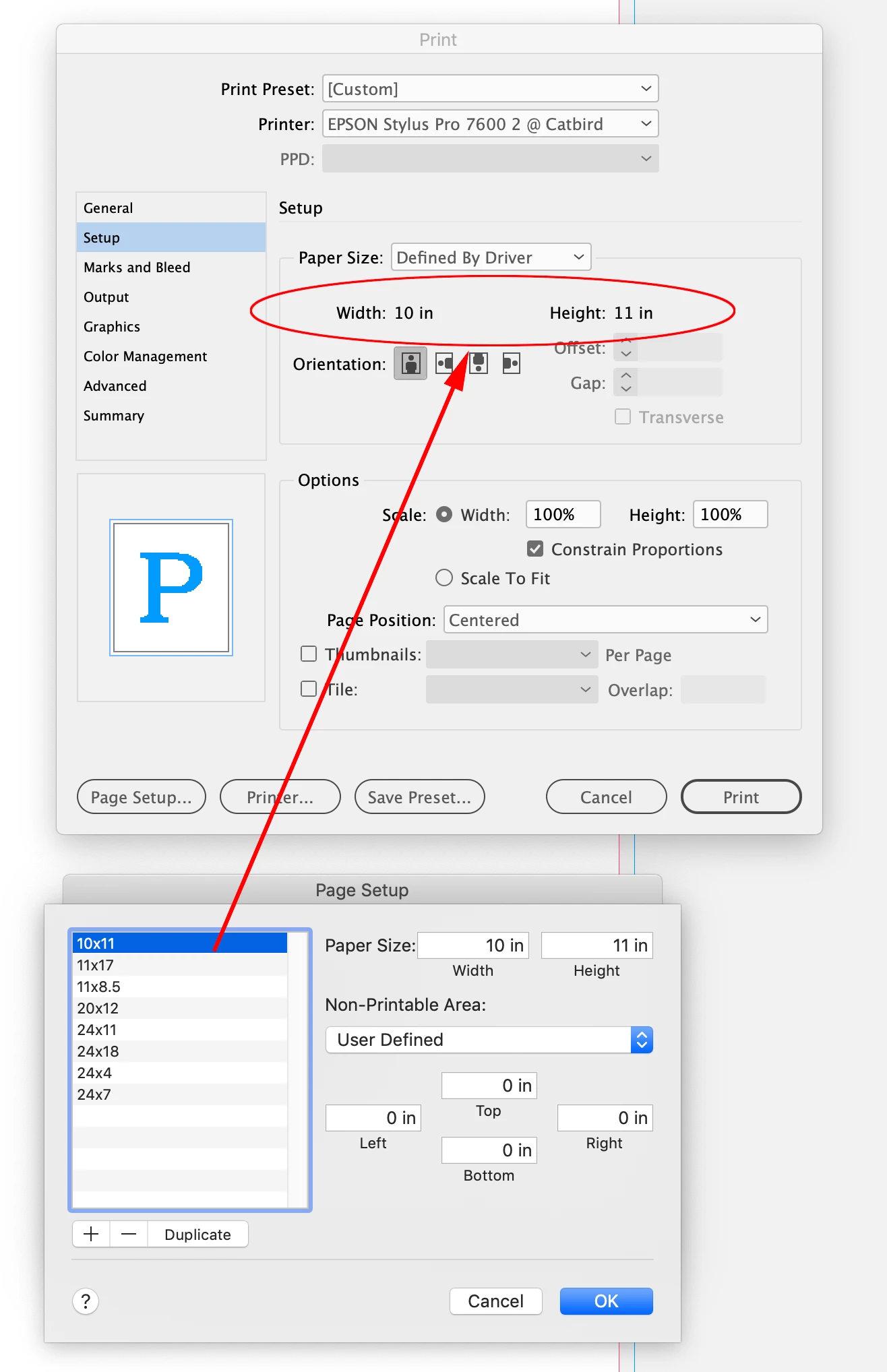

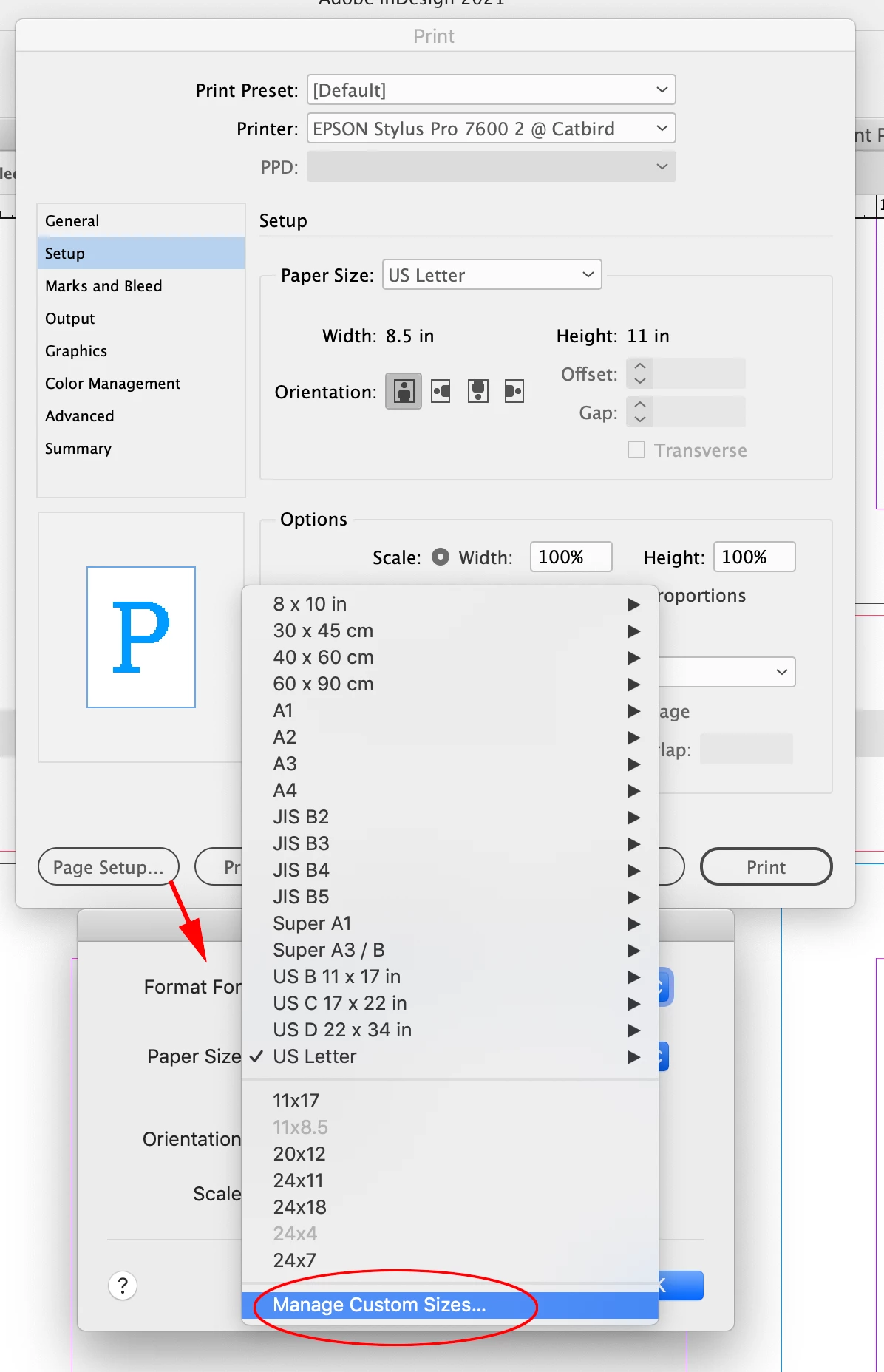

The P700 has a keypad in which certain setup features are entered, including the paper size. Please remember I'm using non-standard paper.
If the driver allows it Page Setup should give you an option to setup a custom size, which can then be selected as a Paper Size:

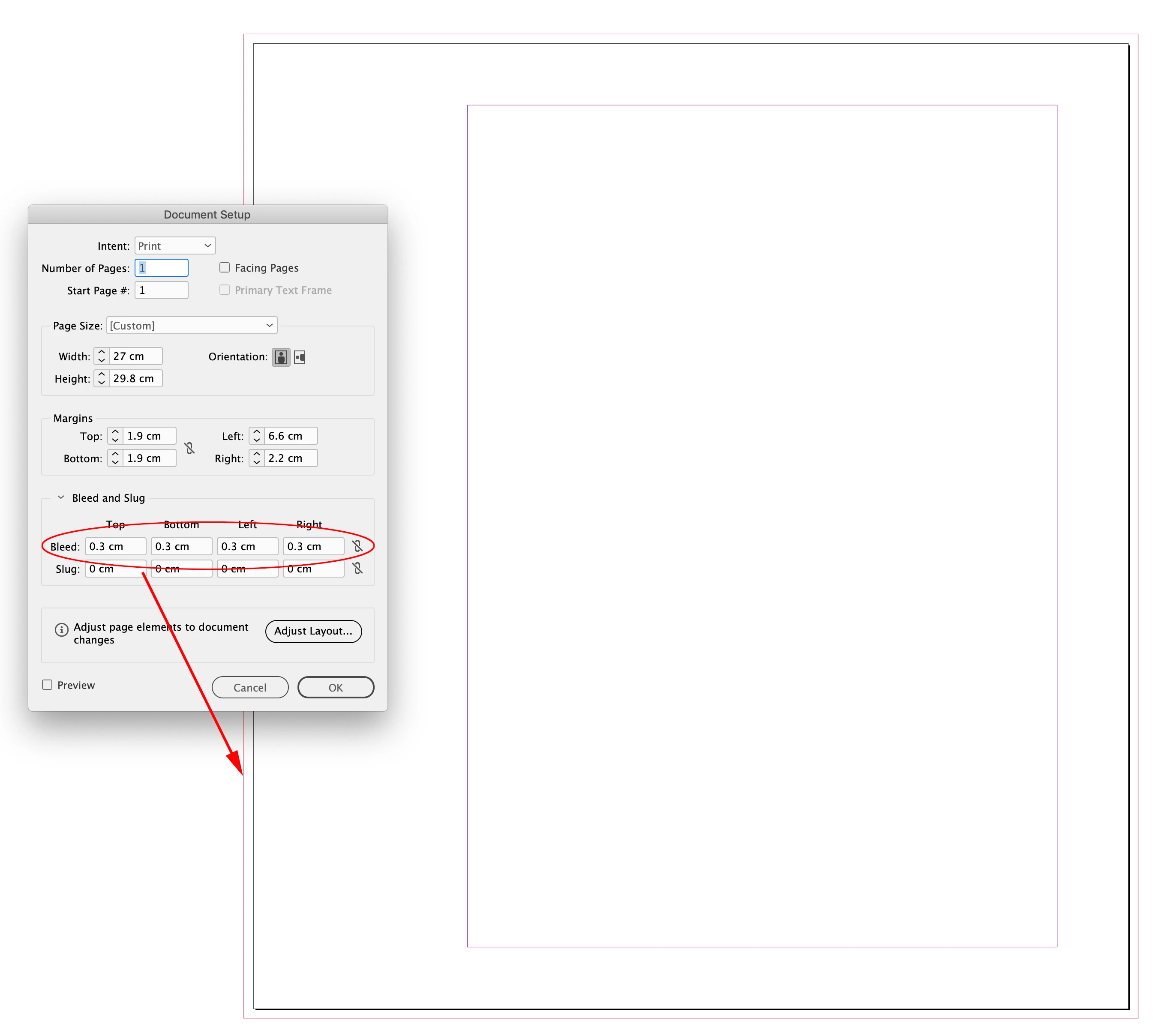

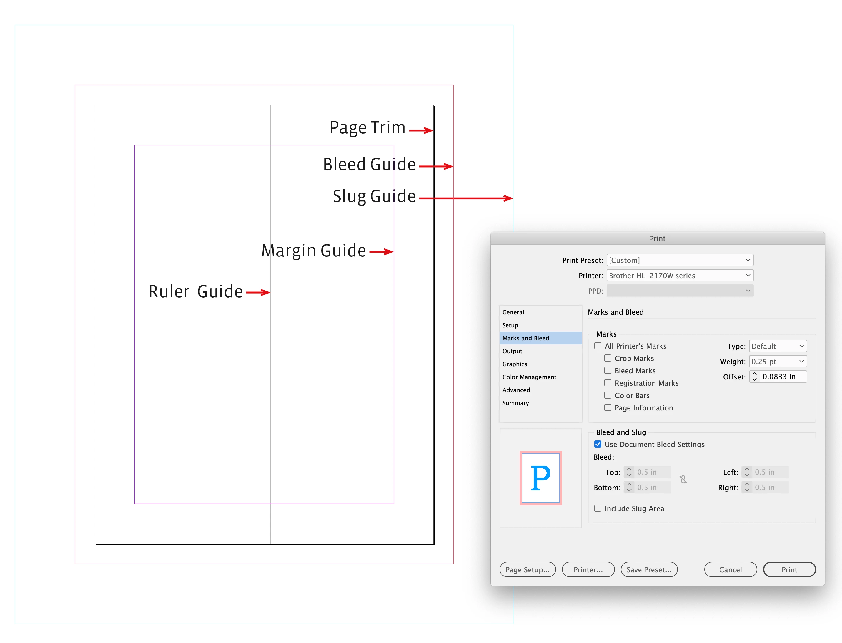

Hi @ldhaber135 , Also, you can choose to include bleeds or not in the Print dialog’s Marks and Bleeds tab (see Bleed and Slug panel)
October 29, 2023
Thank you very much. I have removed all bleeds, and it makes no difference.  (I think that is because the bleed affects the paper edge, not the placement of items within the field to be printed with the margins set in from the edge.)
I do appreciate your response.

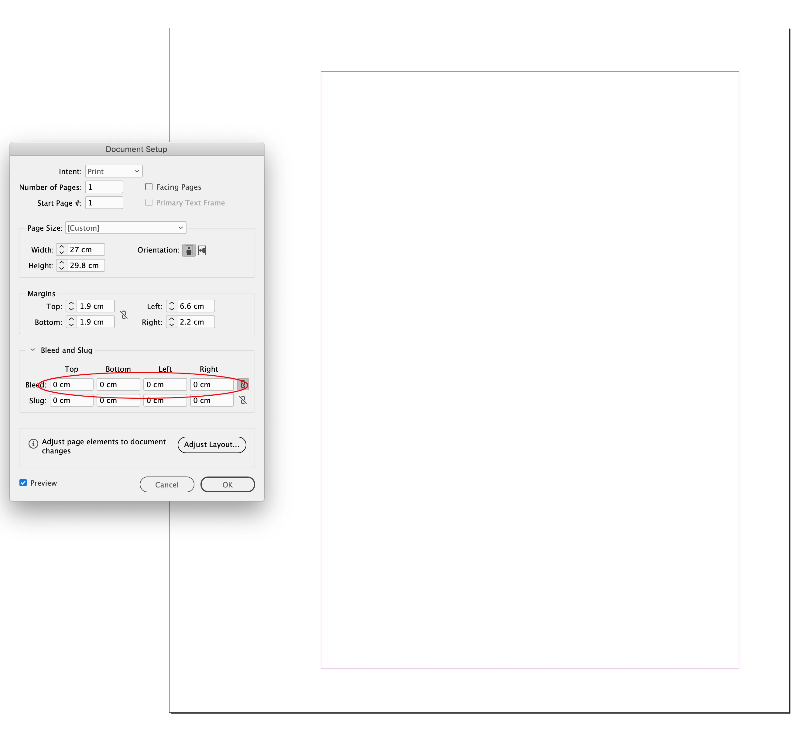

rob day
October 29, 2023
How did you remove the Bleeds? From Document Setup or did you set them to 0 in the Print dialog?
Robert at ID-Tasker
October 29, 2023
You've extra bleed 3mm.
