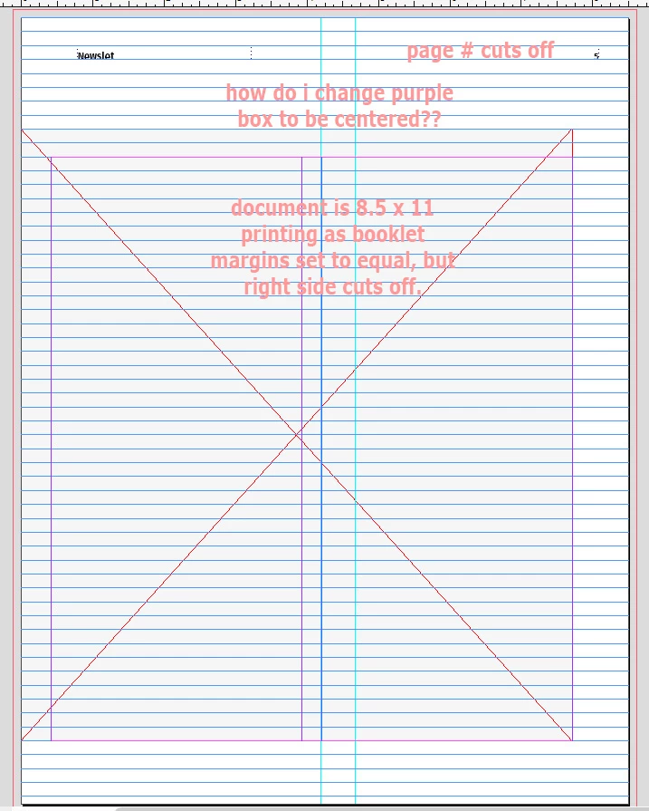

I have a whole bunch of spreads based off one of two masters in a document that will likely be printed and put in a binder/displayed online as a PDF. On my screen in InDesign, each spread appears to have an equal right and left margin. Document and print setting also show equally sized margins. However, when I print, the margin on the right side is bigger for both pages in a spread. I've tried changing the liquid layout settings to no avail. I also tried toggling "facing pages" which did nothing. The masters also print with uneven margins, so it must be either an issue with the master spreads, a document setting, or a print setting, I think. Any suggestions of settings to change would be much appreciated!  Thanks.

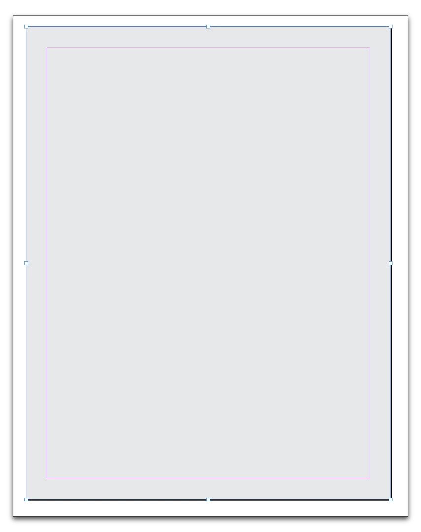

To see if it is the printer, create a new document. Add a light gray rectangle that covers the entire page, and see how it prints. Is it centered, or off-set to one side or another? If so, in addition to Jeff's suggestion, the printer may have centering controls.

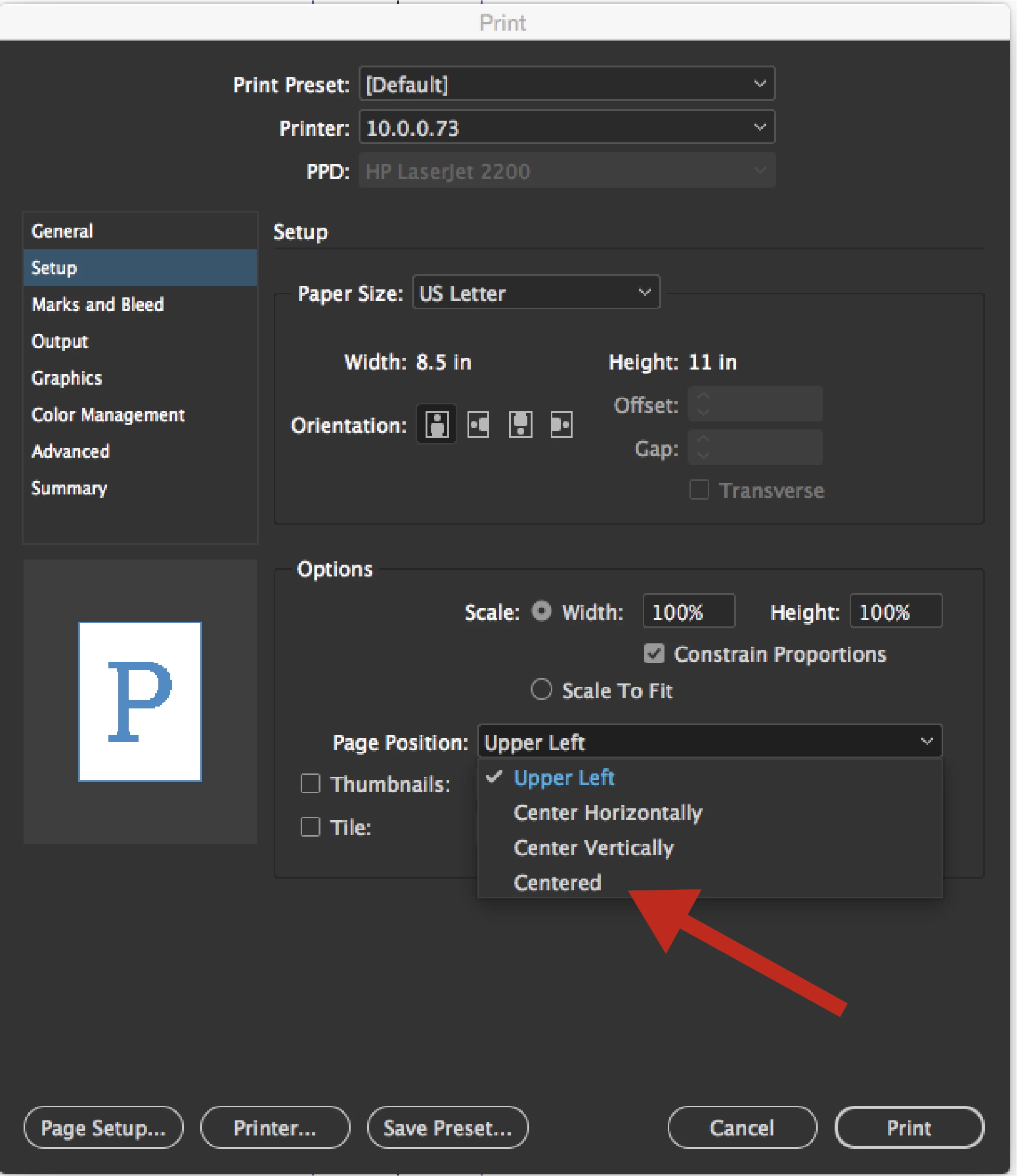

If you are referring to printing on a desktop printer, you should make sure you choose Center in your print options under Setup, Page Position.
See screenshot.

Hi, thanks! I have actually already done this to no avail, but this is a good suggestion.
