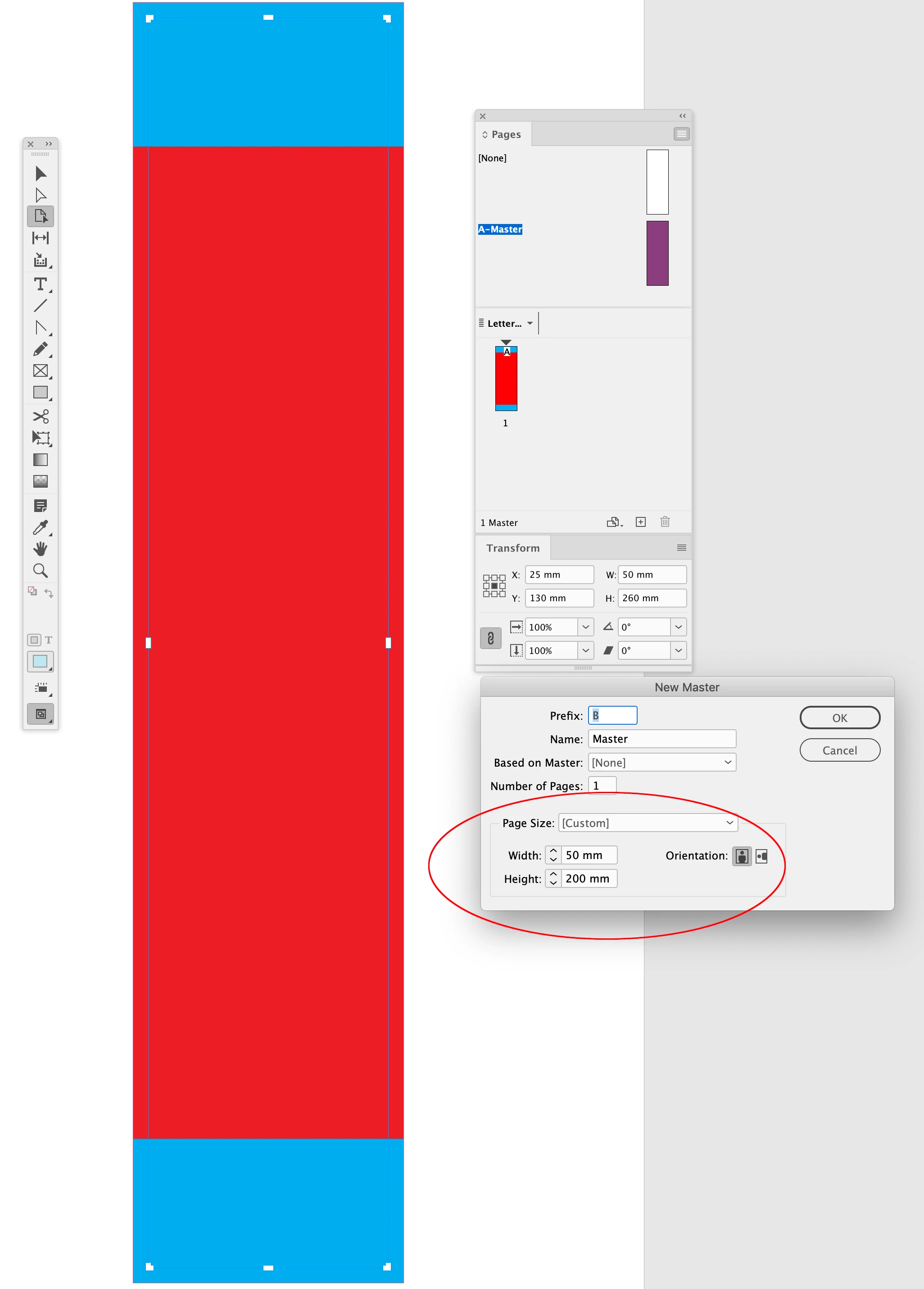

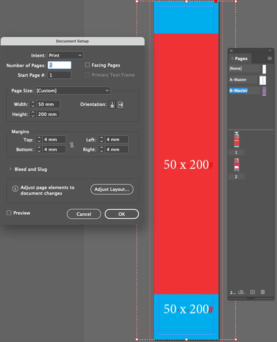

I have an InDesign Document which, when I choose "File ----> Document Set Up" shows as 50mm x 200mm (see red area on attached screenshot) whereas in fact the canvas size is 50 x 260 (blue area).
What is going on here can anyone explain? This has caused huge problems when printing!

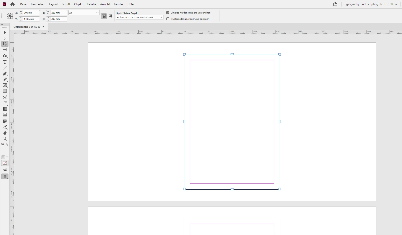

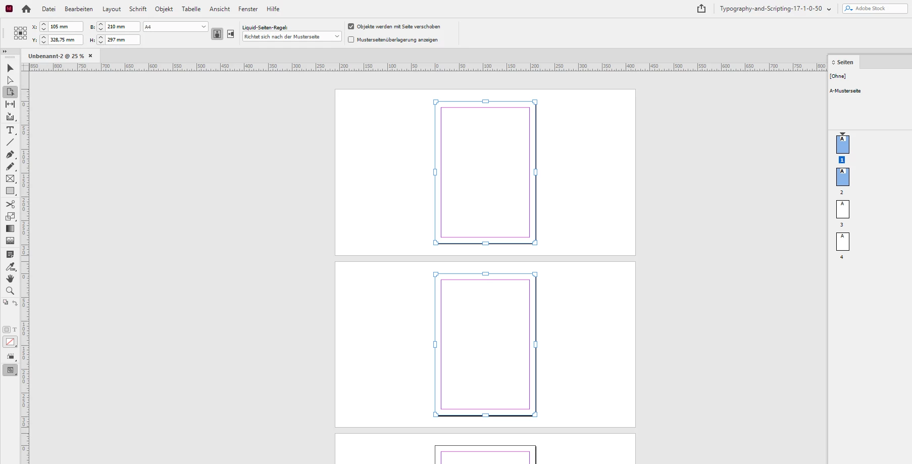

If a page is selected you can see the size in the width and height fields of the Control panel like that; from my German InDesign with one A4 size page selected with the Page tool:

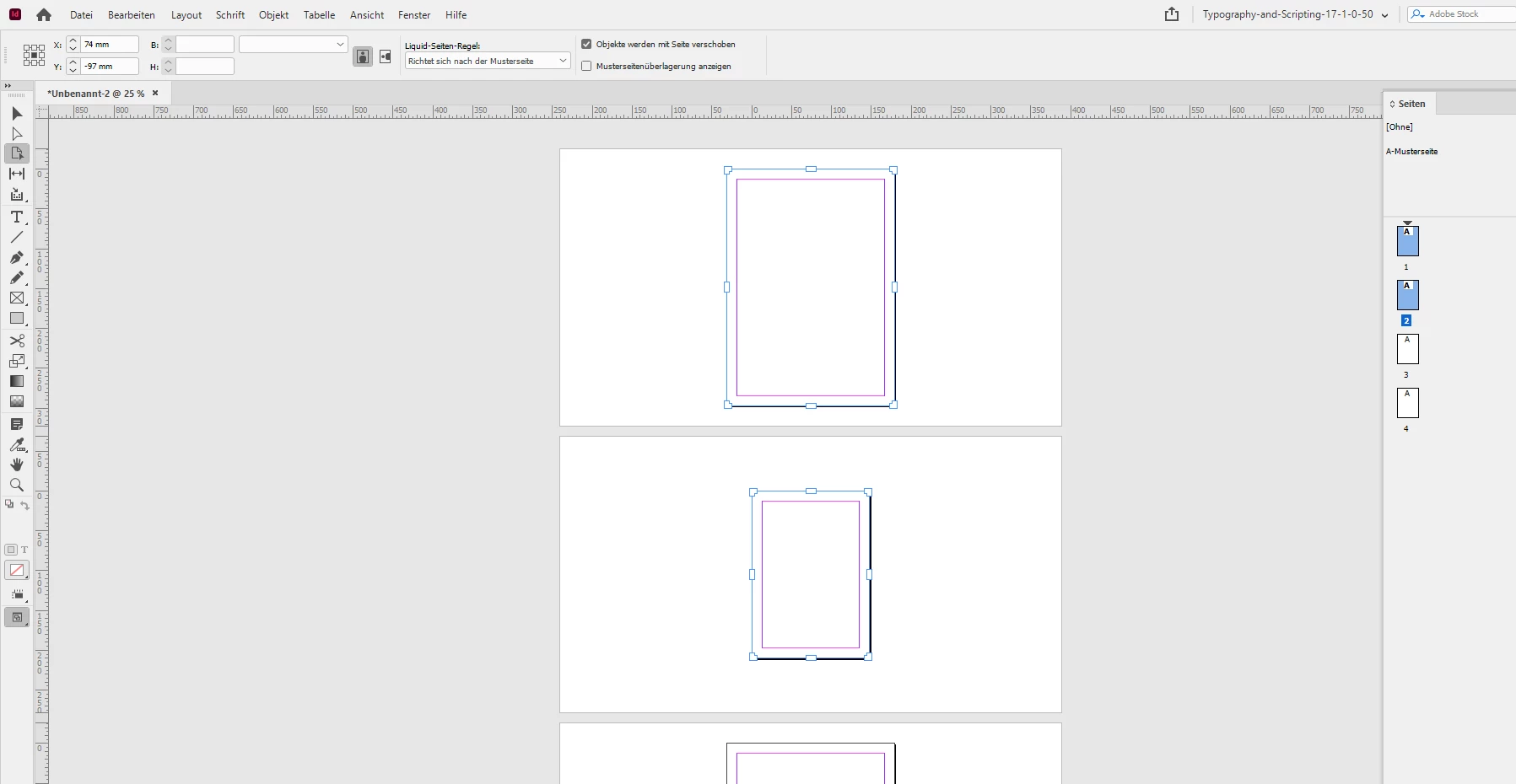

If two pages were selected with the same size you still could see the same numbers:
Now, here are two pages selected with different page sizes:
Access the Control panel (like all other panels) through the Window main menu.

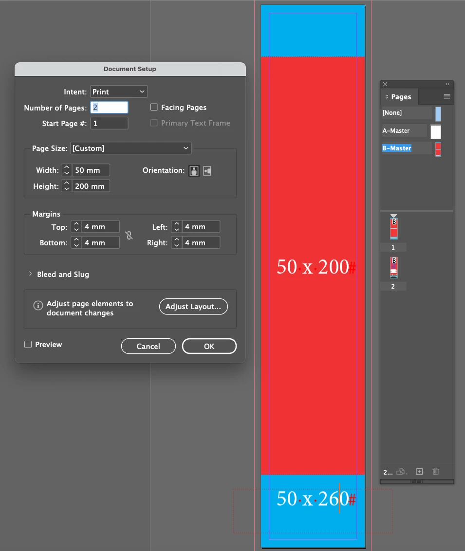

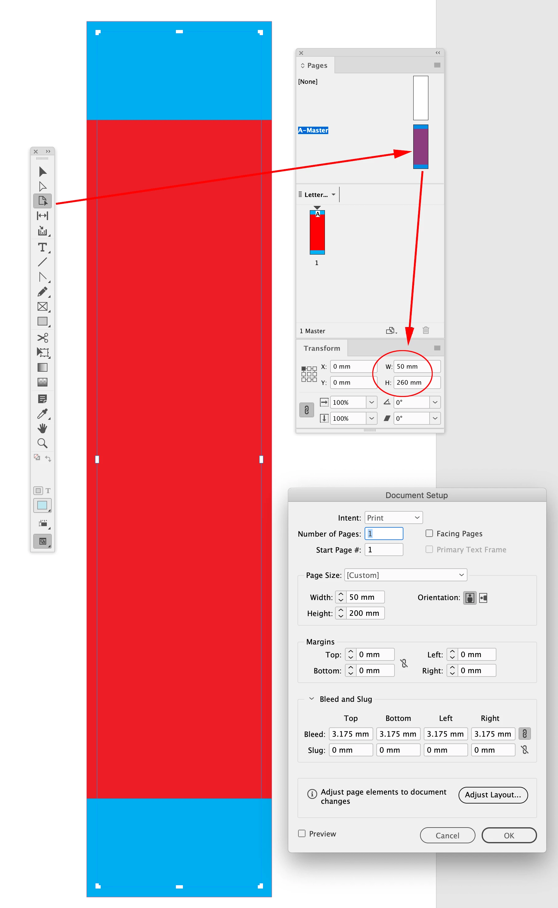

The explanation:
Someone did a new document with page size 50 x 200 mm.
Later the Page tool was used to change the size of an individual page to something else.
Select the page in the Pages panel and switch to the Page tool.
You should see the actual size of the page in the Control panel.

I suppose really, my question is if I have a Master Page dragged into my working document and then I do a "Document Set Up" - why doesn't this give the correct size?
Any clarification appreciated.

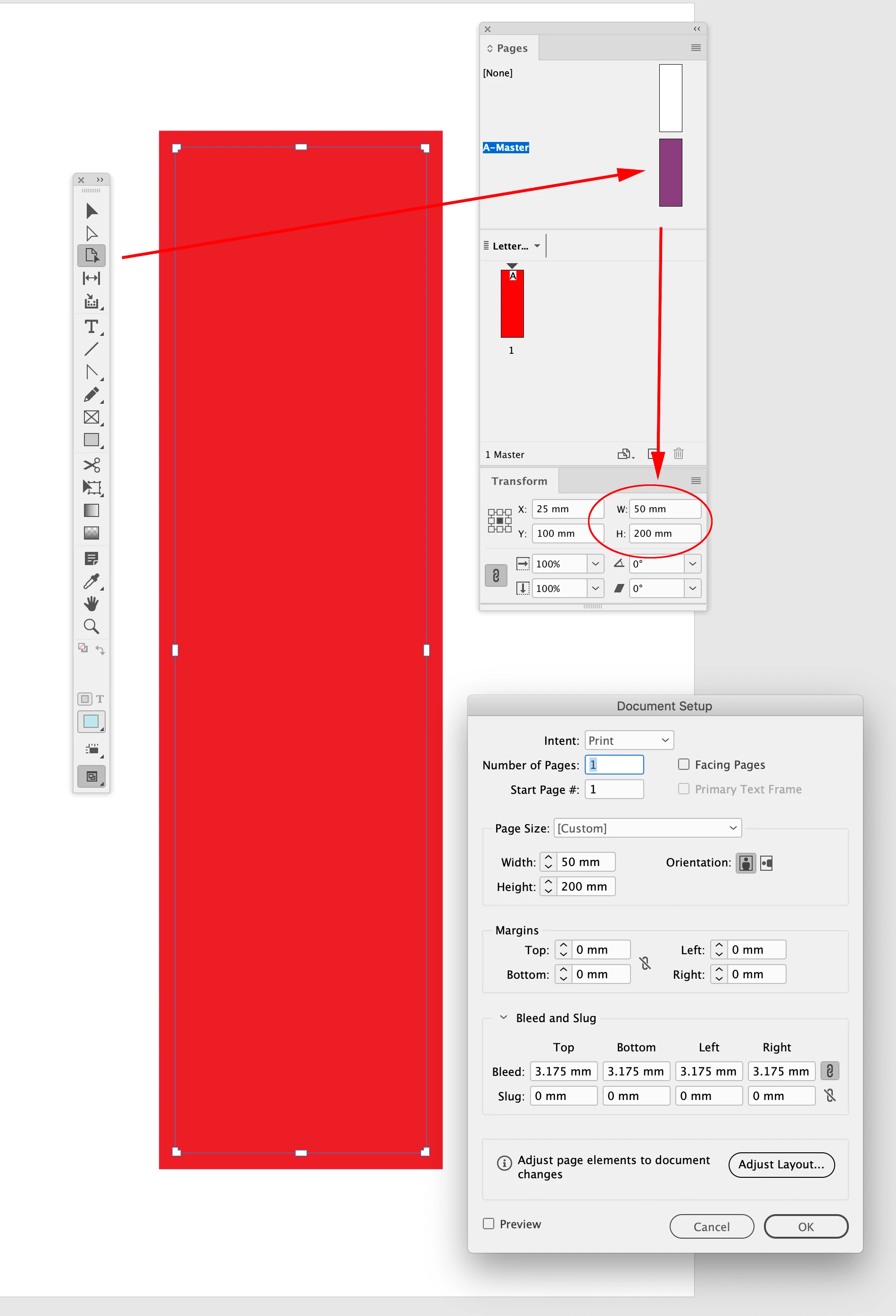

Hi @KieranBrennanDublin , A document can have any number of different sized pages—you are not limited to the Document Setup’s default page size. Here I have the A-Master page selected in the Pages panel with the Pages tool active, and I can set that master to any size:
or I could reset it to match the Document default
If I create a New Master the Page Size defaults to the Document Setup Size, but it could be anything:
April 6, 2022
Sorry please see THIS image!
