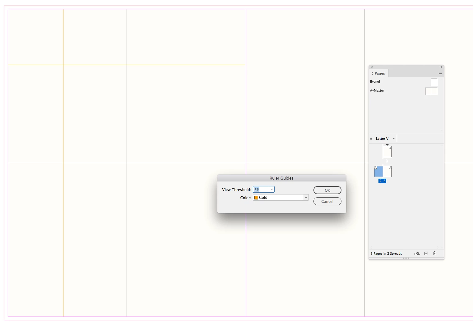

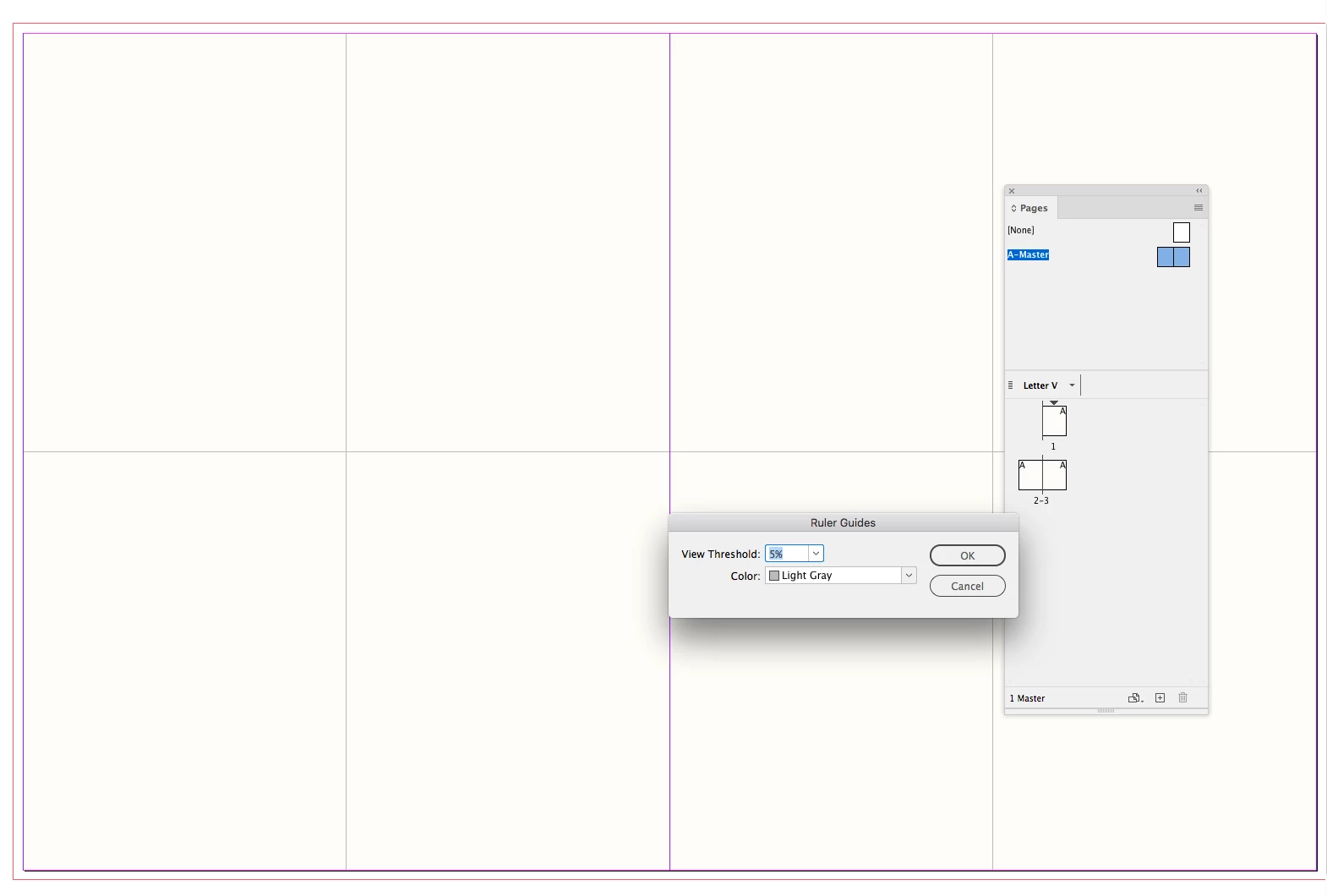

You set the color of future guides via Layout>Ruler Guides>Color, but there isn’t a way to change the color of an existing guide other than via scripting.
So you could set the guide color before you start creating the guides for the Master pages, and then set a new color for page guides once the Masters are set. Not sur if this helps but something like this:
Master guides set as Gray:
And then as Gold for the new guides added to pages:

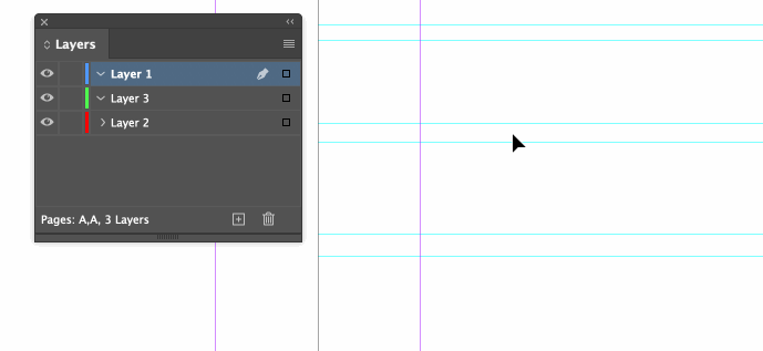

Ruler guide color—document-wide—is controlled in Layout > Ruler Guides. They will always all be the same color.
The only workaround I can think of is to put the master page guides on their own layer, with a unique layer color. The guides will still all use the color defined in the Ruler Guide dialog box, but if you select a guide, they will be highlighted using the layer color. They will also highlight when you hover over them.

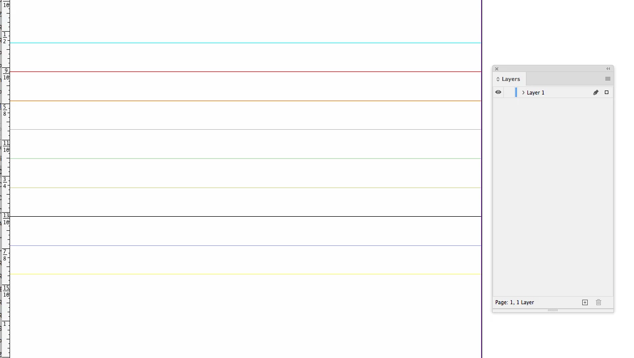

August 28, 2020
—They will always all be the same color.
Hi Barb, just to clarify, a document could have different colored guides. When you change the Layout>Ruler Guides Color, any added guides get the new color. So here I have 8 guides with different colors:
