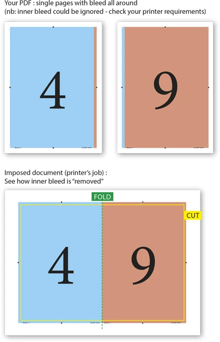

Anyhow, you should definitely stick to facing pages document (except if you design a document that will be spiral bounded) and export it as "Pages", not "Spreads". Off-topic: I also suggest you ask your printer his PDF preset...
The inside bleed should not matter, since it will be "ignored" during the imposition phase, which is your printer's job.
See this illustration for better understanding of the process:

Anyway- as per my original question, I'll just take it that it shouldn't matter. If we give them the file with the bleed all the way around, and it looks like the first figure, it shouldn't matter. They asked us to extend any objects that go to the edges of the pages, so I can do that on the outside easily, but again, the inside shouldn't matter.
If I've got that correct, then thanks a bunch! That's the confirmation  of what I'd thought in the beginning.
