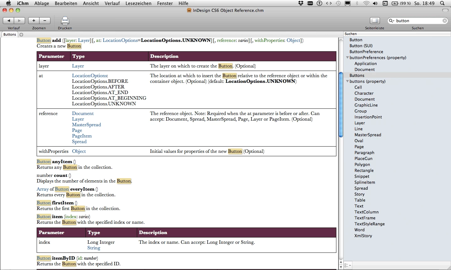

If you search the DOM documention you'll find no verticalJustification on textFrame objects.
Why? See into InDesign's UI. How would you set vertical justification of text in a text frame?
That's an extra dialog with three tabs in CS6.
And an indication that you cannot do it directly on textFrame and have to dig deeper. Object textFrame has also a property textFramePreferences and if you follow the link in documentation, you'll notice that all the properties you see in that extra dialog are waiting here. Have a look into the UI first ( from my German InDesign CS6 ):

I followed the links in the documentation.
TextFrame > TextFramePreference > VerticalJustification (enum)
Here we see that verticalJustification has 4 possible values.
And all the 4 values can be expressed by their name or by their value.

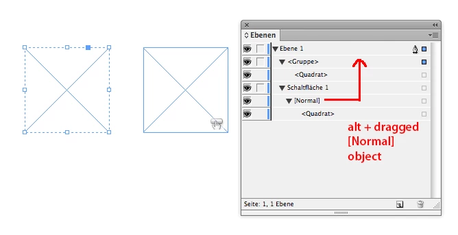

How can we identify that group as group in the UI?
Simply select the button and hit Shift + esc on the keyboard or select contents from the available menu commands or select [Normal] from the  Layers panel. The lighter dashed lines of the selection suggesting that a group is selected. A group with a special name:
Will it keep its special name, if we copy/paste that group or alt + drag to make a duplicate?
No. The pasted groups's name will be an empty string and the Layers panel is showing the default generic name of the object.
Or it reveals the name of the group again, the name that you assigned to the group before you converted it to a button.
Btw.: If the generic name of an object is used in the Layers panel the name property of the object is returning an empty string.
After alt + dragging you can see a rare object on the page.
A group that consists of one object only:
The State object of a button
I mentioned the state object at the beginning of that post.
So back to the button, select that and ask for:
app.selection[0].states.length // Result: 1
And this:
app.selection[0].states[0].pageItems[0].getElements()[0].id // Result: 224
Aha! The first page item in the first state of the button is the same group that we detected before.
So both statements below point to the same group object:
app.selection[0].states[0].pageItems[0];
app.selection[0].pageItems[0];

There is no method converToButton() in the DOM ( document object model ) for pageItems.
Therefore you have only two options:
1. Construct a button from scratch with method add() for a Button object.
2. Use the menu command with a selected pageItem in the document.
Since you like to work with InDesign CS6 best download Jongware's DOM documentation.
For ease of use, especially searchability, see the chm files. I'm on a Mac so I need the iChm app to open and navigate the files. You are on Windows and I'm sure there are similar apps or native ways to open chm files.
Just a view on the method add() of Buttons:
You see all properties of a button object listed under Button.
Downloaded from:
Indesign JavaScript Help
Below a link to a function that is working with a menu action for converting an object to a button.
Marc Autret:
Re: How to convert textframe to button
It is still working with InDesign CS6 and should also work with the latest CC 2017.1.
