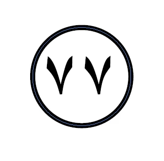

I have a circle of 8mm and I would like to write a number inside it from 1 digit to 3 digits.
Single digit will be in different font size, double digit in a different size and 3 digits in a different size.
The issue I am facing here is that I can see lot of space inside the circle but the moment I increase the font size, there is a an overset text. I have also changed the baseline to fixed.
Screenshot and idml attached. What can be done to increase the font size without overset text.
I am planning to use Numbering list option to populate the numbers inside the circle.
Thanks

@Abhishek Rao Thanks. I am uploading a small video of few seconds. I need numbers in bigger size. The circle is big enough bigger font size but unfortunately it oversets.

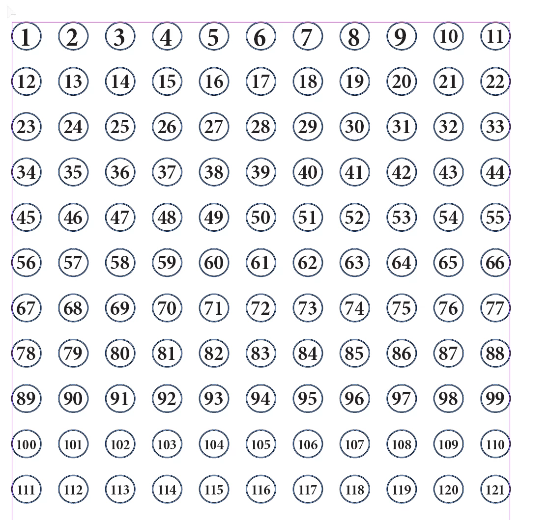

If you want it truly automatic,  you can't using auto numbering.
I created a series of linked frames using the up/right arrow when creating the frame. These will be auto linked. I "eyeballed" them to be square.
I converted the text frames to elipses and added a stroke.
I created a long number list in Excel and exported as CSV.
I imported the CSV file into the first frame. (I had to show all files to import.)

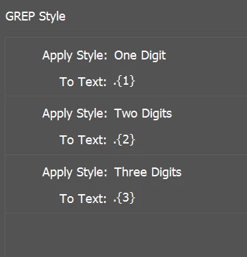

I created three character styles: one digit, two digits, and three digits.
I used your paragraph style to create a GREP style (see below).
I then adjusted the character style's type size and baseline shift.
Files attached.
To add more numbers, copy and paste the circles from one page.
Select all the text in the new batch of cirles and delete.
Go to the last consecutive number and link the out port to the first blank in port.
