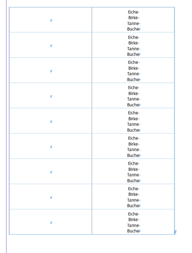

In this case, it works on one of the columns. If I select the other one, the script doesn't do anything. It doesn't matter which column I start with.

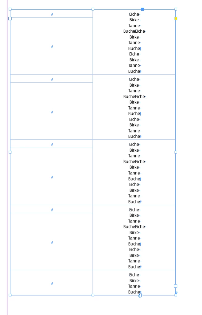

In this case, it behaves completely unexpectedly. It merges some of the cells but not correctly. This is the result:
Any ideas why the script behaves like that? Any help is much appreciated!
