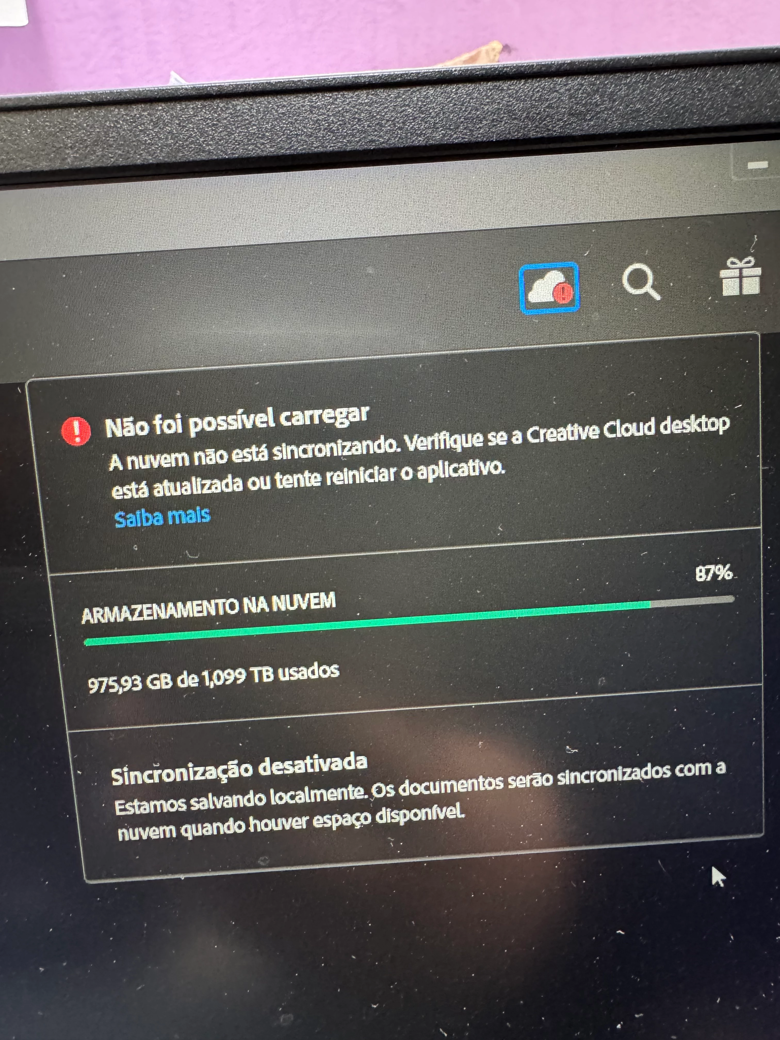

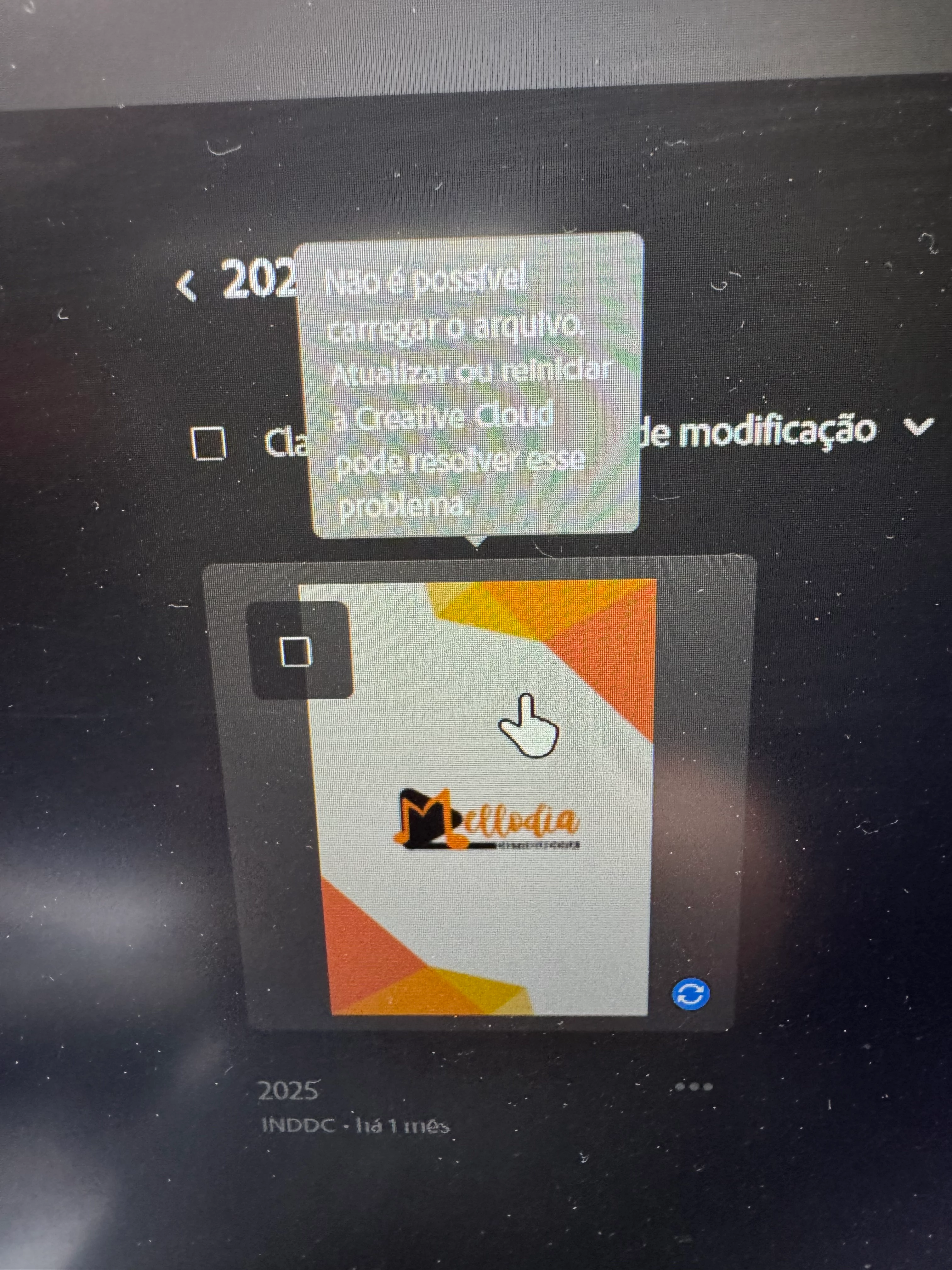

Meu arquivo nao abre em outro PC
Estou fazendo um catalogo extenso em um PC e comprei outro para continuar o trabalho, porem o arquivo nao abre e minha nuvem simplesmente nao esta atualizando mesmo tendo espaço.  Ja tentei tambem usando outra nuvem, e passando os arquivos por pendrive, com todasa as imagens linkadas. O suporte da Adobe nao conseguiu me auxiliar. O que poderia estar acontecendo e como posso arrumar esse erro?

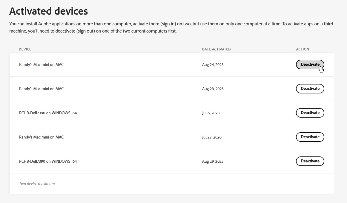

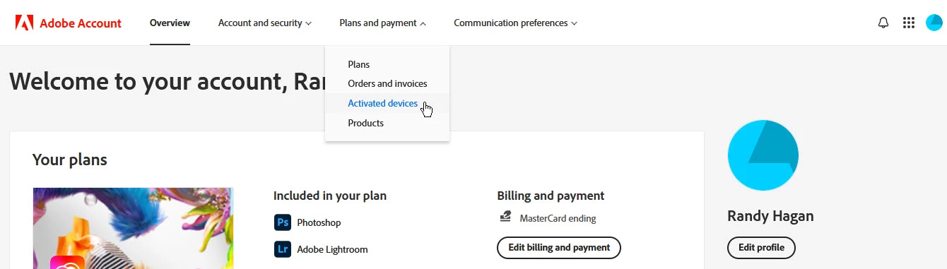

As far as the updating goes, did you sign out of your old PC before you tried to install/update Creative Cloud on the new one? If so, all is not lost:
  • Sign into your Adobe Account from Adobe.com. I apologize for the information showing in US English, but I'm hopeful that the information is positioned the same for your language within Adobe's web presence in your country.
  • Under the Plans and Payment pull-down menu select the Activated Devices option. Again, I'm hopeful that the information for your language is positioned similarly, even if the language in the illustration above does not correspond with your language.
  • This opens the Activated Devices page for your account. Don't be surprised, as shown below, if you see multiple instances of your old system listed on the page.
  • Delete all the references to your old PC, then go to your new PC's Creative Cloud Desktop application and sign in with your Adobe ID (generally, your email address for the account) and your password. Hopefully this will let you get into your system, download updates and use them on your new system.
Hope this helps,
Randy

I have the latest version in both computers, but unfortunately in my older computer the package button is not available/clickable. Do you know how can I make it available for me?
The error just says that my cloud is not  synchronized  because it's unable, even that in my other computer is saying it's all synchronized and updated.
