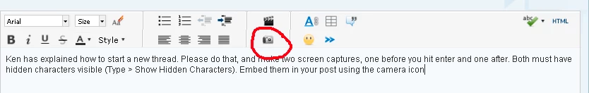

    Attachments are disabled. You have to come back to the web page and use the camera icon to embed an image in your post like this:
    Take a look in Event Viewer (Control Panel > Administrative tools...) and see if there's any other info, too. It sounds like a failed install.
