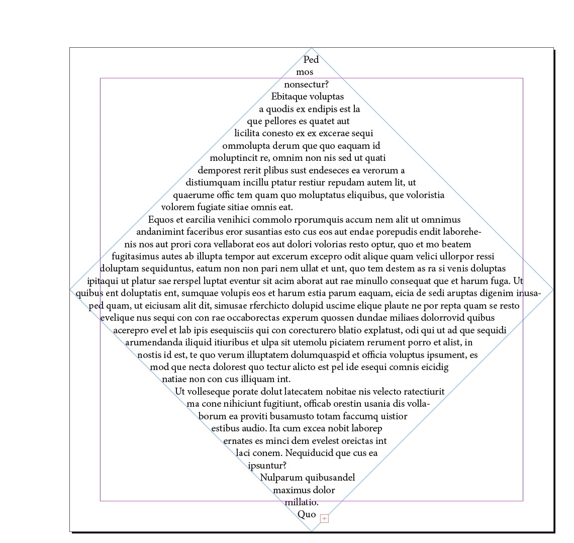

Hi anaisc47344472,

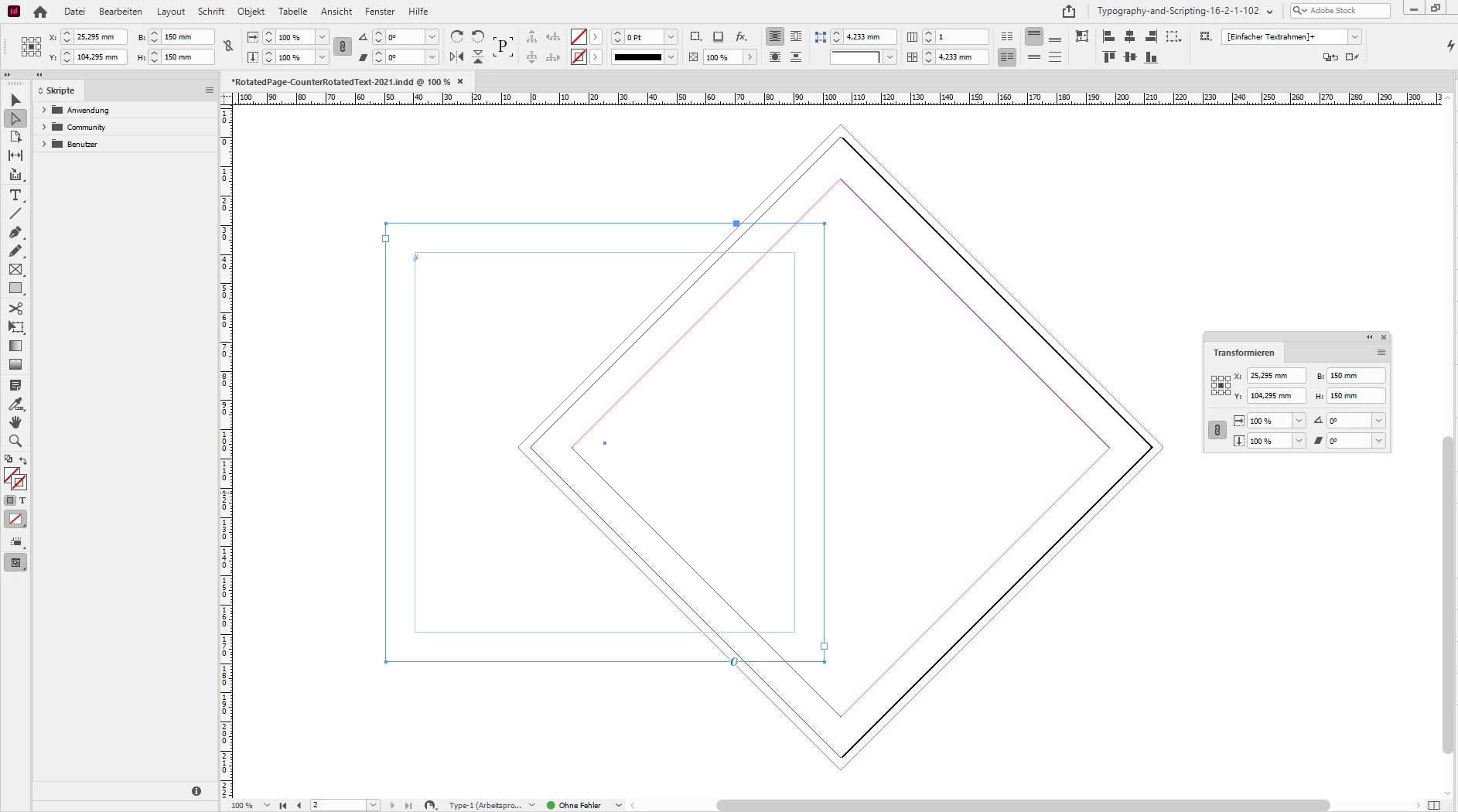

also possible: Rotate the page to 45° before you add the contents.

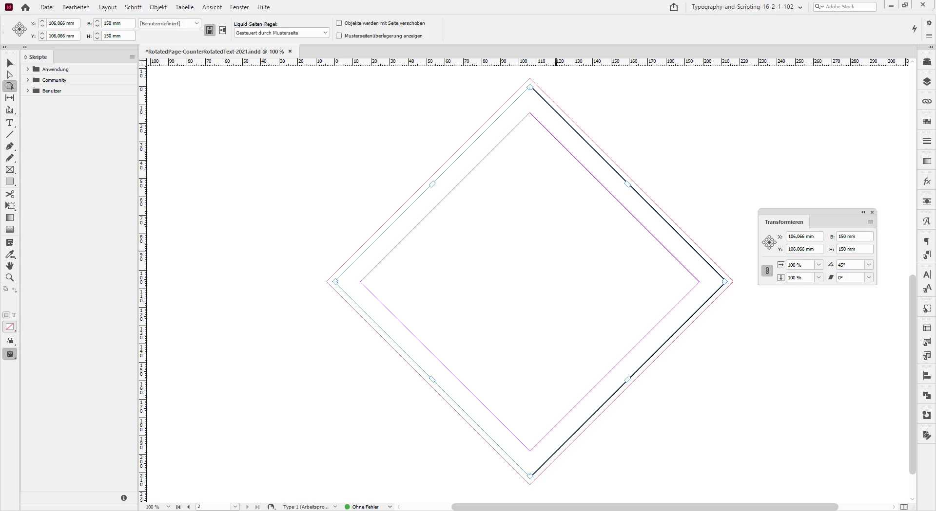

Use the Page Tool and the Transform panel for that. Then add a text frame the size of your page, rotate it with the Direct Selection Tool ( the white arrow ). Now insert your text. Export as PDF with all marks you like.
From my German InDesign:

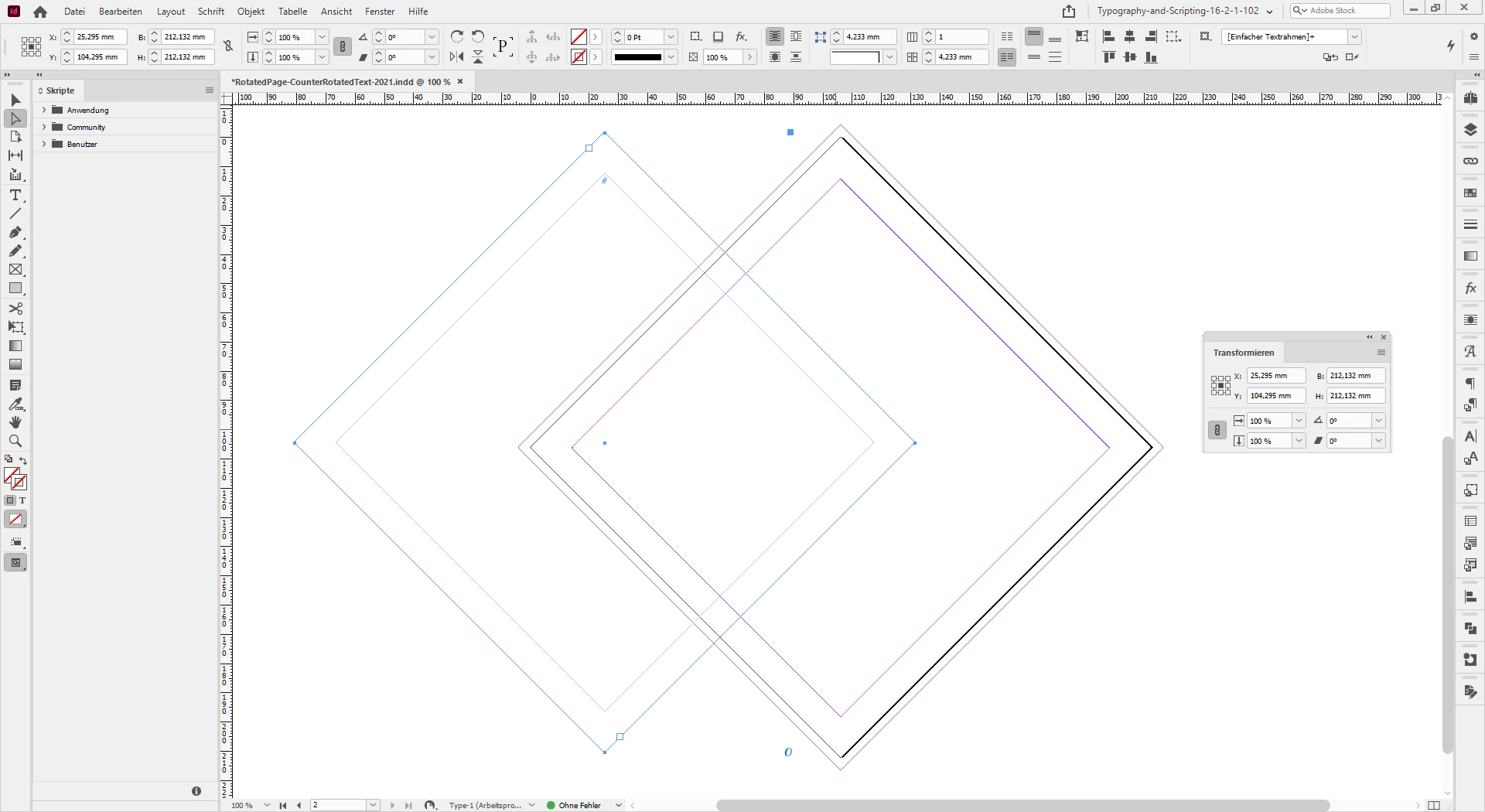

Page Tool selected the page.
Page rotated using the Transform panel.

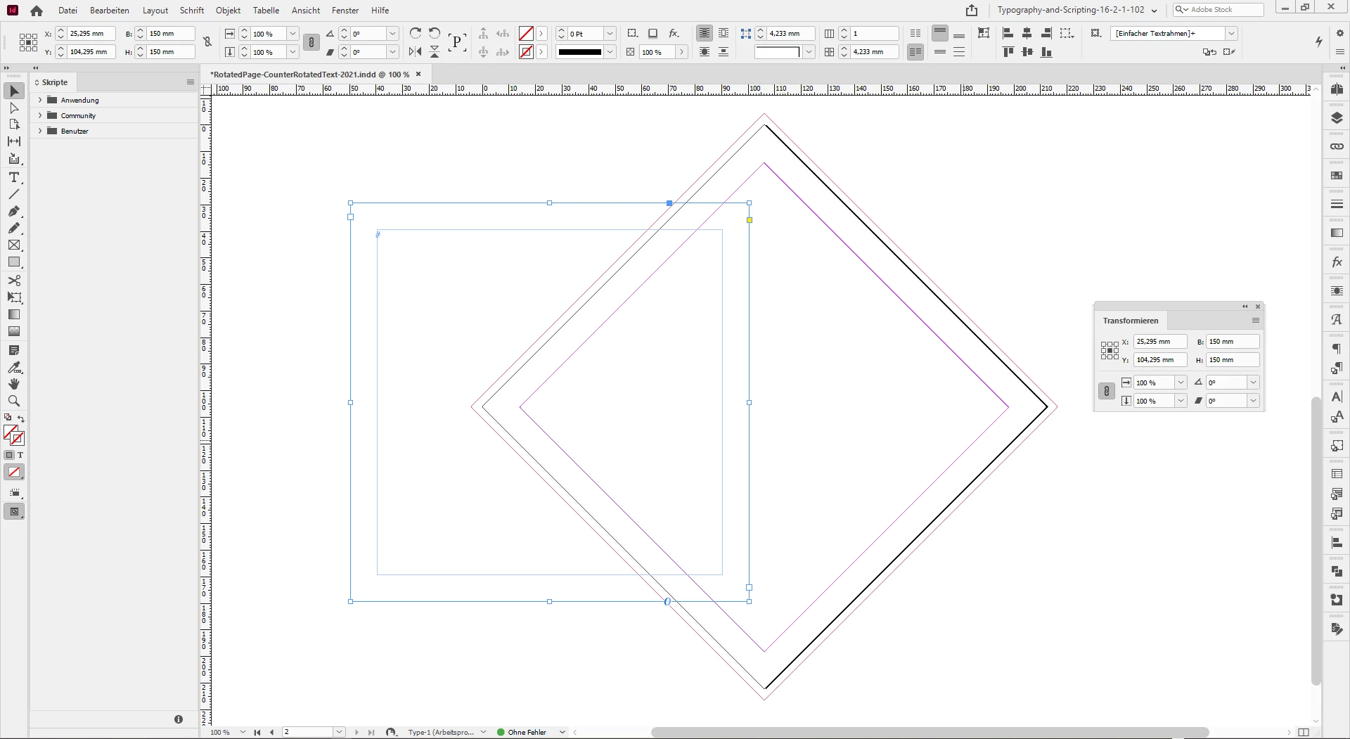

Draw text frame the size of the page with insets the size of the page margins:
Switch to the Direct Selection Tool ( the white arrow tool ) :

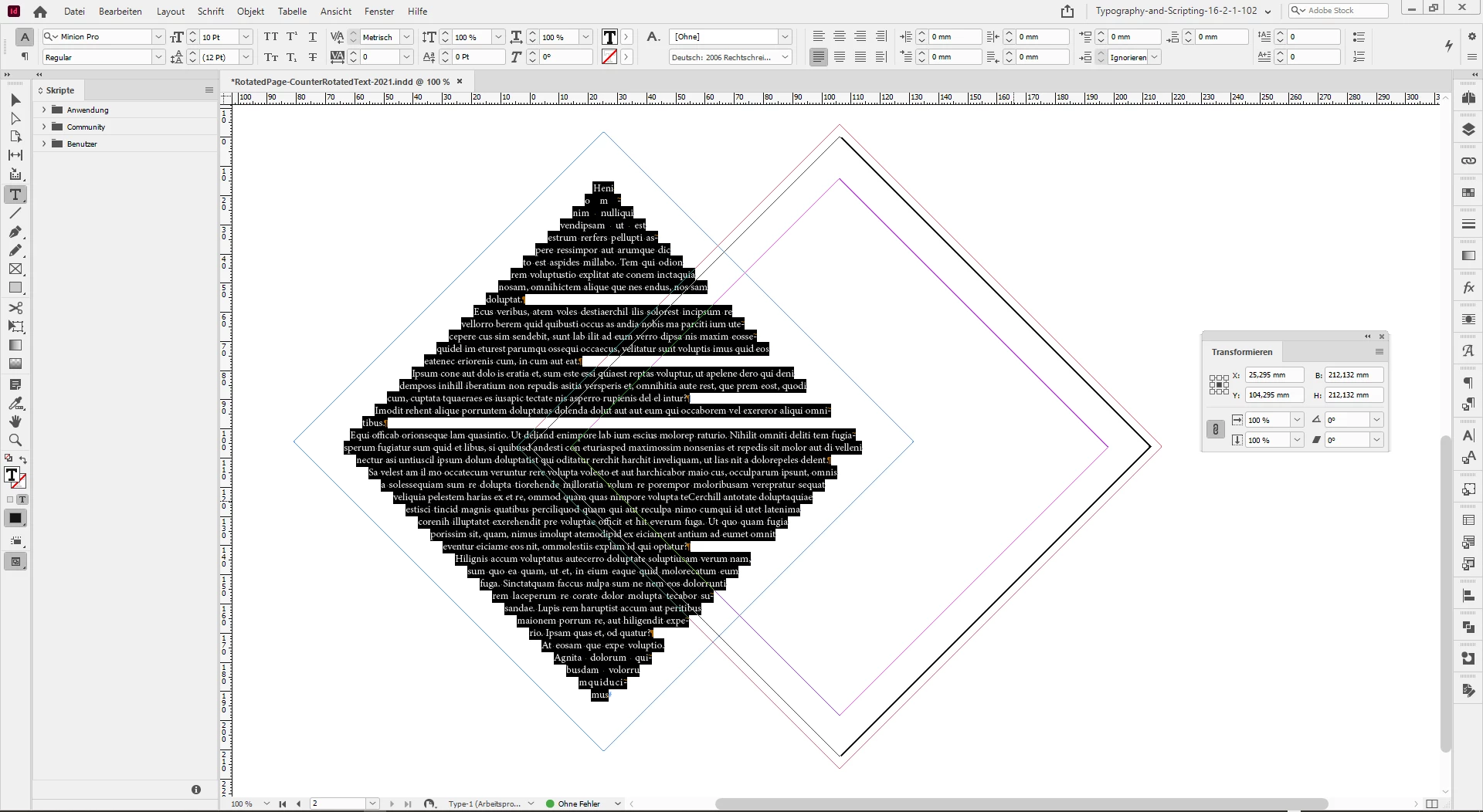

Use the Transform panel to rotate the frame's path points to -45° ( or to 45° if you prefer this, just test this ) :
Fill the text frame with contents:

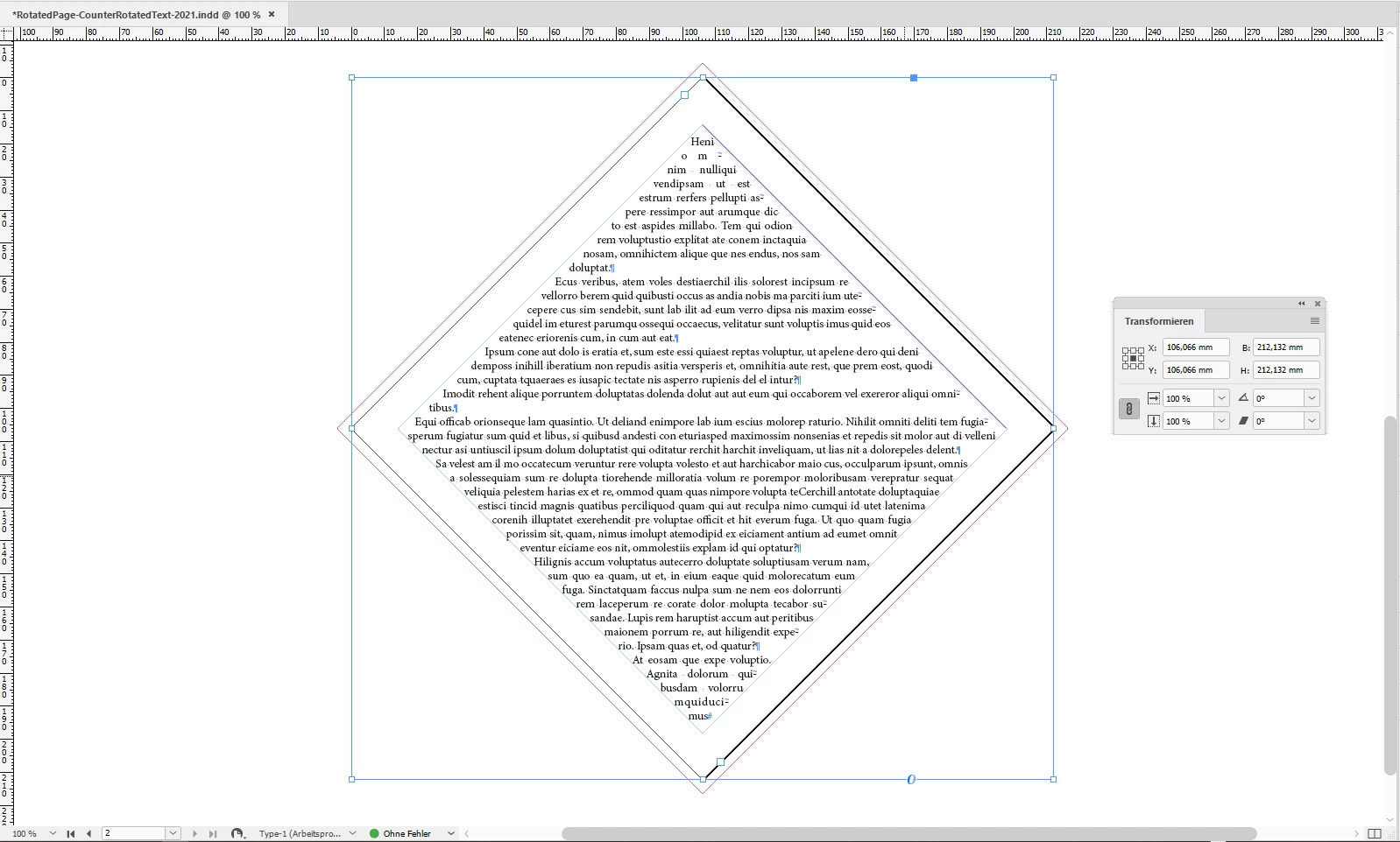

Align the frame with the rotated page:

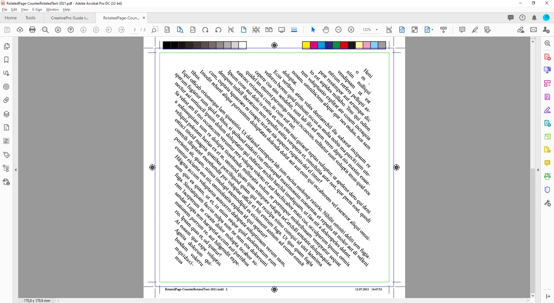

Export the page to PDF with all print marks if you like.
PDF opened in Acrobat Pro:

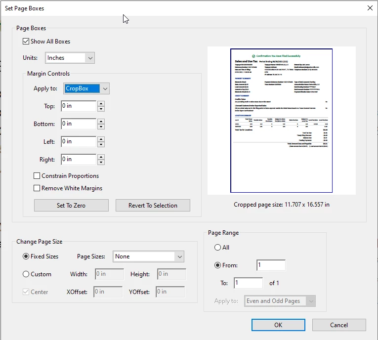

@jmlevy Question for you: on adding the manual cross-section crop marks, would you suggest placing these in InDesign or on the PDF after export using Acrobat? Not sure what the math or settings would look like to do that properly. Apply to Art Box maybe? Thanks!
