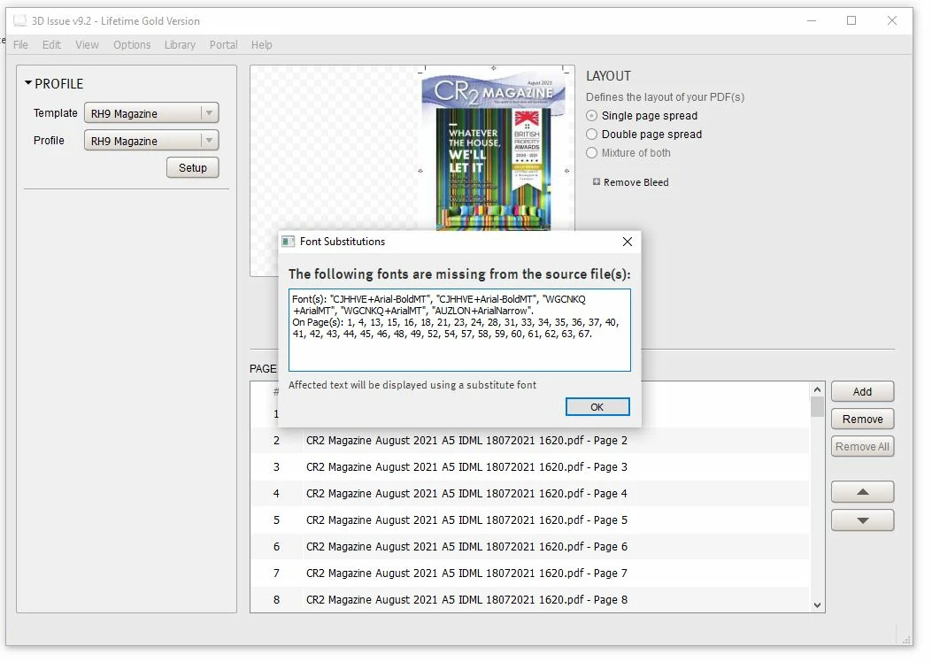

Since 2014 I have been using InDesign to create monthly print publication magazines. I export to High res PDF’s for my printer and then package the files into a folder with fonts and links. I use the PDF created in Packaging to create an online flipbook (3DISSUE) for my website.
For the first time ever  the 3DIssue software is now  reporting missing fonts – although strangely only replacing some of the text with a different font. Checking the properties in Acrobat shows the fonts are embedded.
3Dissue are saying the fault must lie in the PDF ( they very kindly sent me a link to a 2017 Youtube video showing how to embed fonts in Adobe Acrobat Pro)
Any thoughts anyone?

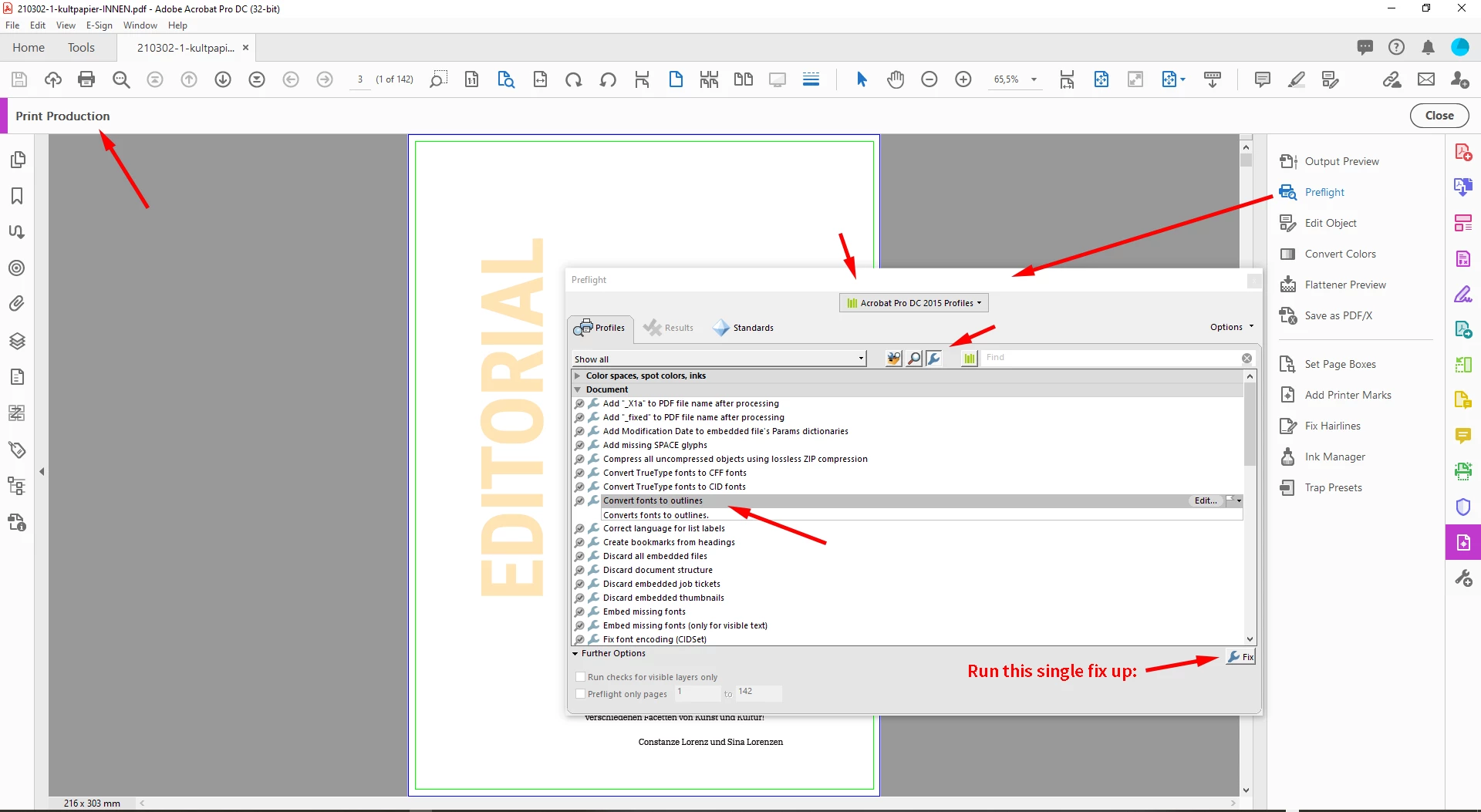

the only workaround I can think of is to convert the fonts to outlines using Acrobat Pro:
Uwe Laubender
( ACP )

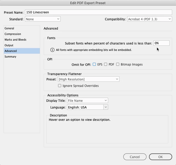

But if you're new to 3DIssue, the variables will be harder to find because the new production workflow is chock ful'o'variables. One thing I get from the screen captures you provided is that you're using a lot of indicated TrueType fonts, and that they are entirely subsetted. It might be worth it to:
1) try embedding the entire font into your jobs (change the threshold for embedding fonts in your PDF Export Preset from 100% to 0%, as shown below:
The downside is that file sizes will grow dramatically, because every font you use will be embedded in the job. Depending on how your pubs are designed — and whether you're building custom advertising for your pubs — this could be much larger.

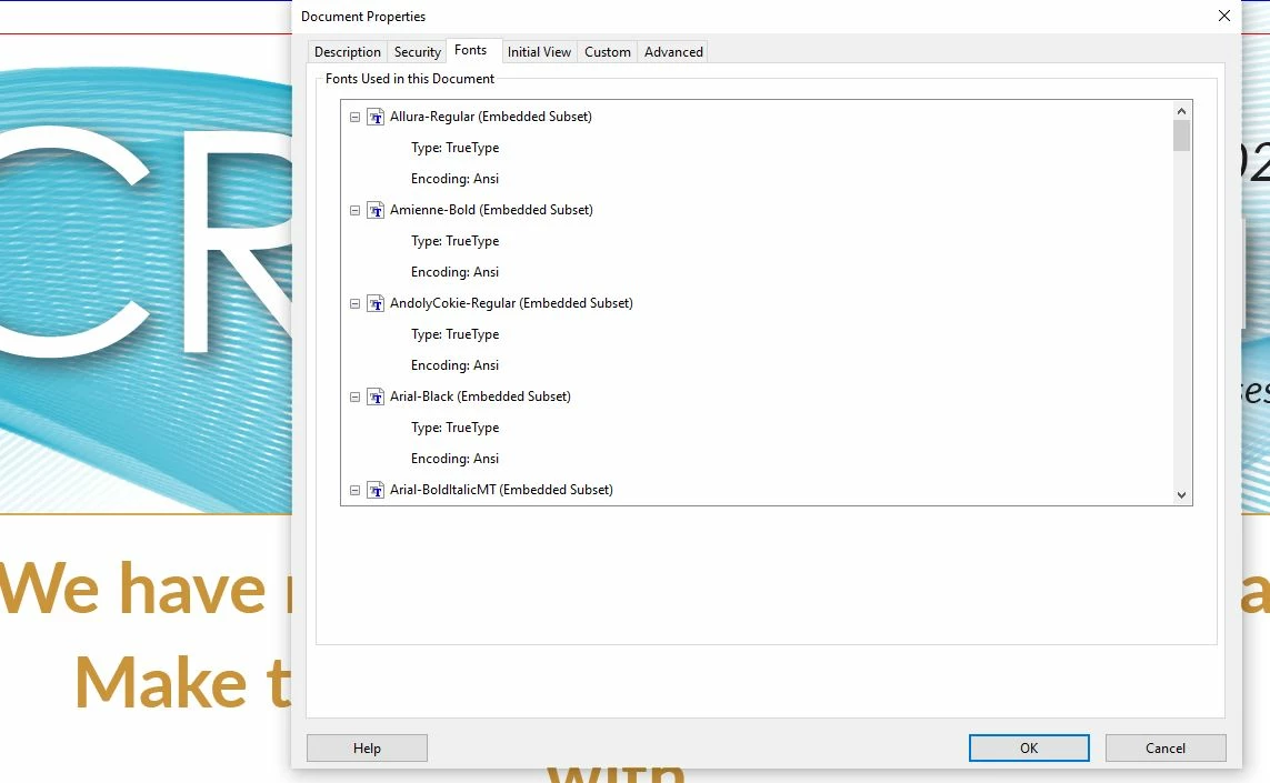

Can you show us a screen shot of the Document Properties for one of the suspect files?
TubbsdadAuthor
August 3, 2021
This is the missing fonts message in 3DIssue and the Adobe Acrobat properties check - the thrid screenshot is the online version of the Potting Shed Feature and the 3DIssue software has replaced some text in Arial with Minion Pro or Times New Roman - but not all of it?

Randy Hagan has some excellent pointers. Another thing you could try -- in the Export Adobe PDF dialog box, click on Advanced on the left side of the dialog and under the Fonts heading, select zero where it says 'Subset fonts when percent of characters used is less than:"
TubbsdadAuthor
August 3, 2021
Thanks will try that
