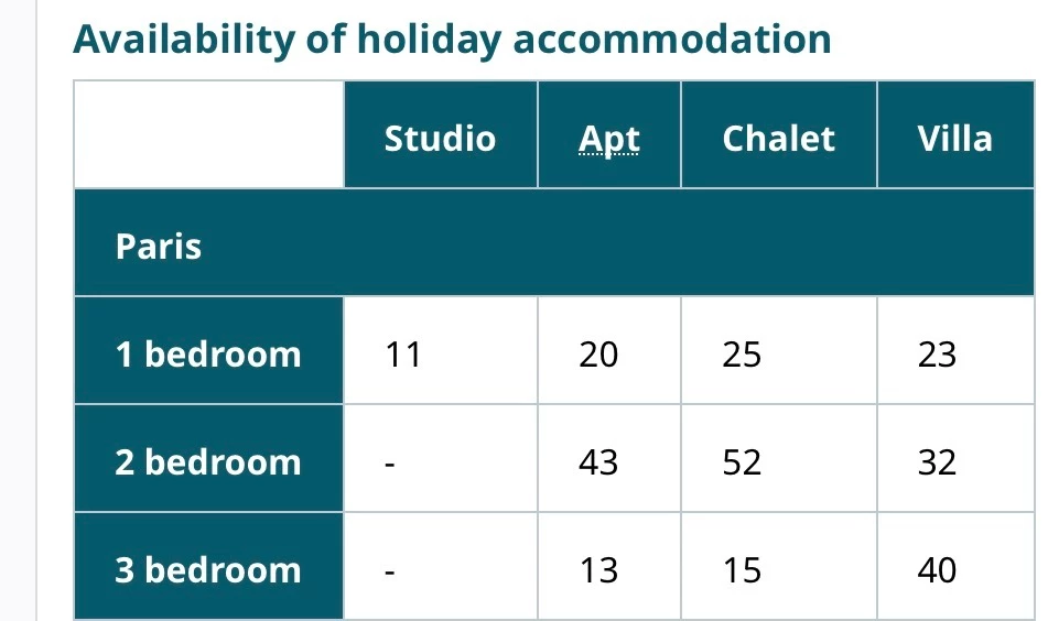

    ​@Ramanjulu24343519g94g  your points:
    1. Not exactly, straight forward non-complex table headers do indeed not need the ID’s cell association, but it does not hurt either; so simply always creating them could be simpler to program than some ‘decision’ on when needed or not needed.
    2. Yes, see the examples that I gave, Row headers are needed but InDesign’s option to convert parts of the column is now impossible.
    So maybe instead of thinking on Row and Column level as complete blocks, think of it at CELL level, convert selected CELLS to a row/column header (like MadeToTag does!) Combined with associated ID’s for TD’s it solves empty header cells (for instance the left upper intersection when blank, see example above) that need to be TD and not TH, and it would make complex TH and TD cell tagging possible in tables like the examples on W3 org.(Although the design of this example should be simplified, the advice given also there, but sometimes clients won’t allow you to do so 😞)

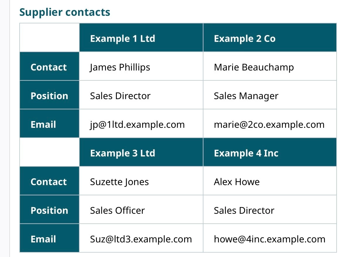

    Frans v.d. Geest
    Sep 4, 2026 1:55 PM UTC
    ​@Ramanjulu24343519g94g What would InDesign do with this one example on the w3c page for instance?
    Sep 4, 2026 1:42 PM UTC
