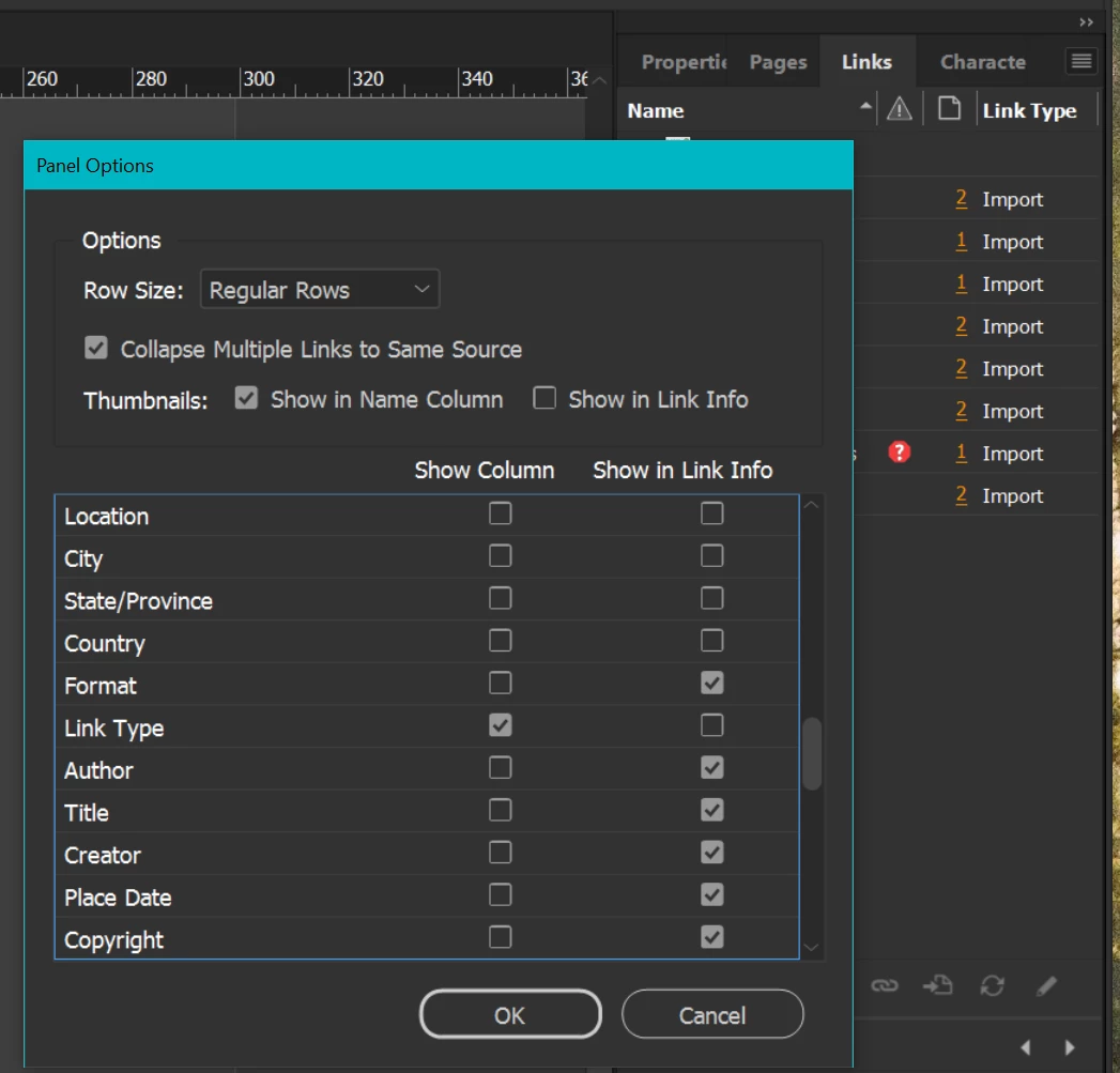

I have found that this worked:
Window > click Links > On the side panel that appears on the right, click the burger menu icon that is directly to the right of the Links tab > Panel Options > On the list that appears, scroll down to Link Type > click Show Column and Show in Link Info > click OK at the bottom of the pop up. Then you should see the warning column, page link number, and link type appear.
