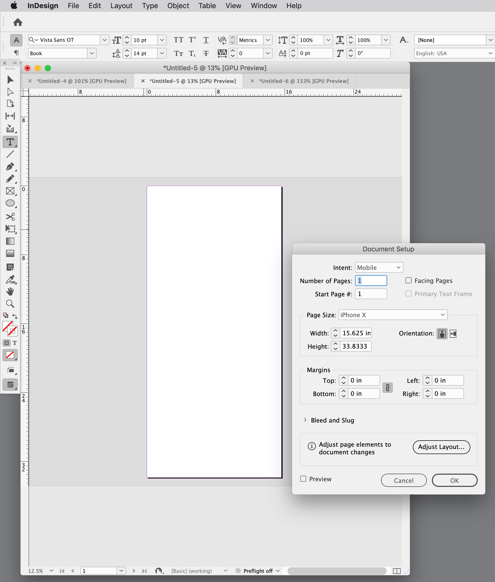

Hi @vickyb30597743 , An InDesign page is a vector object, so it has no resolution. InDesign does have a Pixel Ruler Unit, but it has a static output dimension of 1/72", so if you change your iPhoneX page’s ruler units to Inches and check its dimensions they will be 15.625" x 33.8333":
By default InDesign also defines the print output size of a point as 1/72", so you are forced to set the body text large relative to the 15.625" x 33.8333" page.

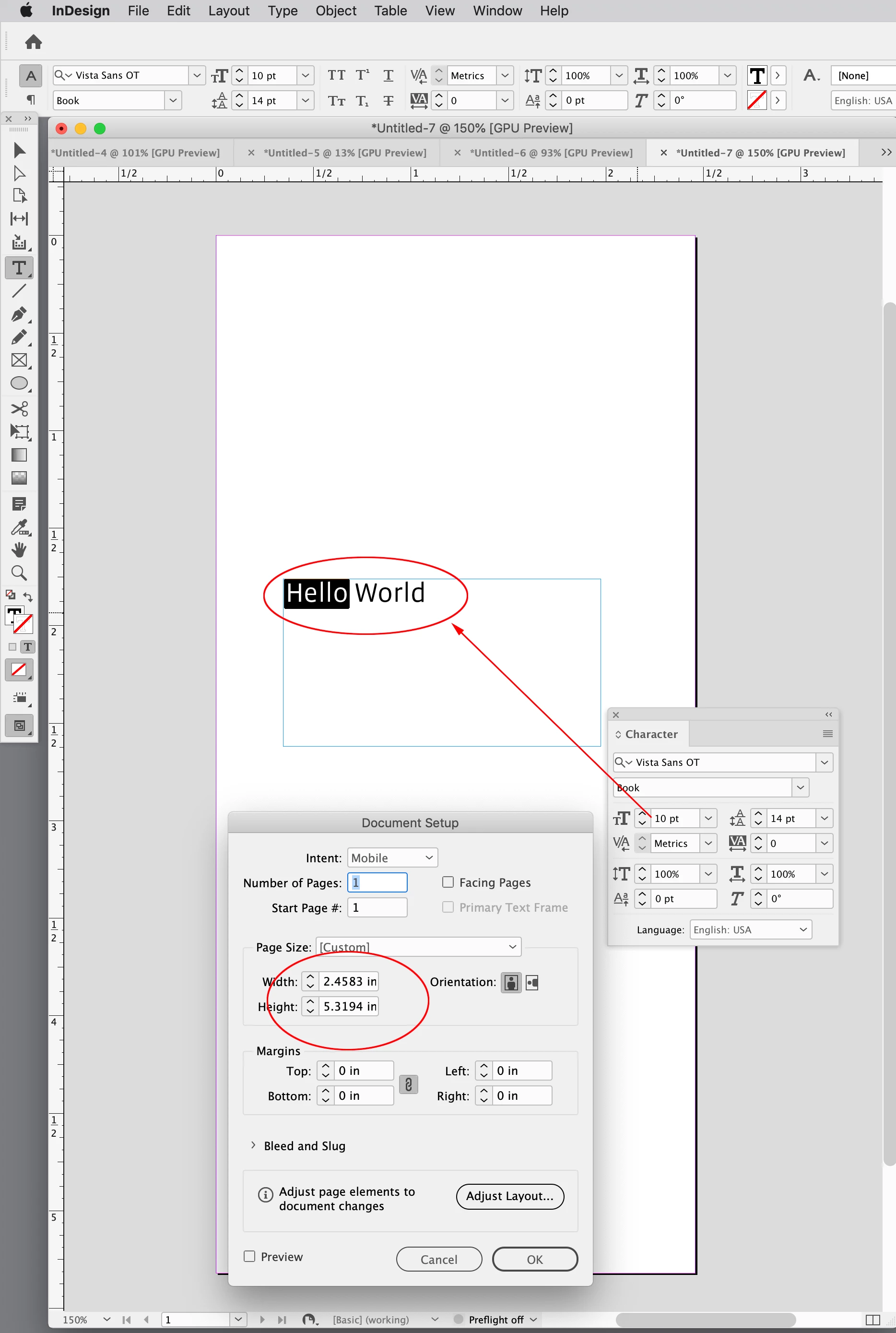

You could set your document up to the iPhoneX physical dimensions—its resolution is 458ppi, so a document at the physical dimensions would be 5.319" x 2.456". In that case your body text set as InDesign pts, would be relative to the iPhone’s physical size:
