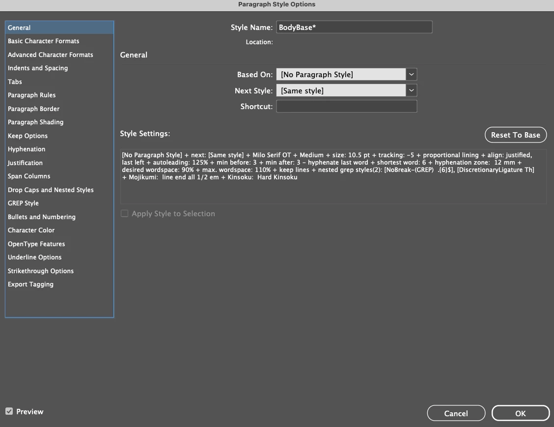

Recently, I'm finding "Mojikumi: line end all 1/2 em + Kinsoku: Hard Kinsoku" is being spontaneously added as the last settings in my Para Styles, and I do not have, nor have I ever had, any Asian language installed for InDesign.
Whatt's going on here? Does anyone know?

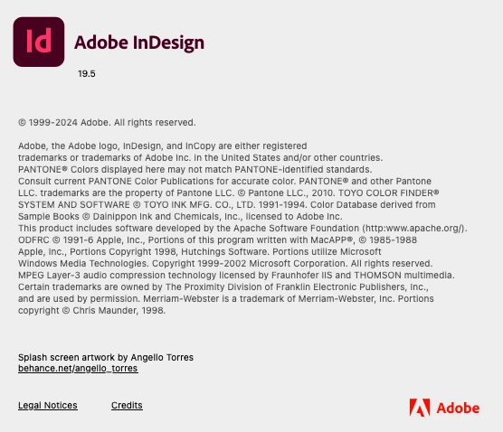

Hi @stevenp64515577,
Thanks for reaching out! To help troubleshoot this issue, could you please provide the following details?
1. Which version of InDesign are you currently using?
2. Could you share the details of your OS?
3. Is this issue specific to one file, or is it occurring across multiple files or even newly created ones?
4. If possible, could you share a screen recording demonstrating the issue? This will help us better understand what’s happening.
Additionally, was this functionality working correctly for you earlier? Let us know so we can assist you further!

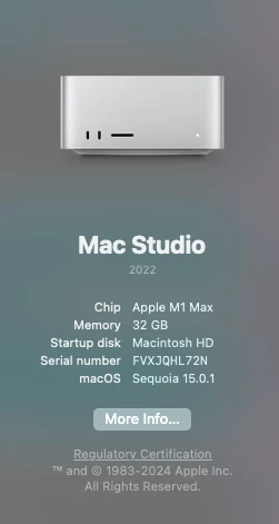

1. I'm running InDesign CC 2024 (last I tried, 2025 was terribly sluggish) on MacOS 15.0.1.

4. Not sure how I could provide a screen recording because I have no idea of when it happens. I've attached 3 screenshots to show the InDesign version, MacOS version, and the Para Style this is showing up in.
5. Sorry I cannot be more specific. What really irks me is that there is no way to remove the settings without blowing up my style.
