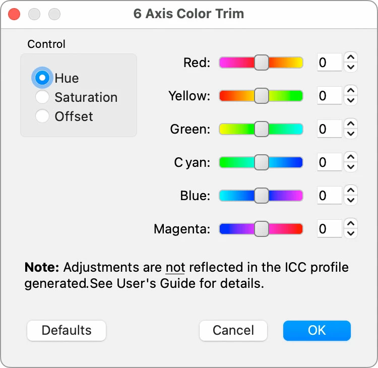

On my old NEC SpectraView, this can be done using the 6-Axis Color Trim feature in the SpectraView software. The dialog box tells you that these adjustments aren’t included in the display profile, which makes sense because you’re doing this after and outside of the standard calibration (i.e. “you’re on your own”).
