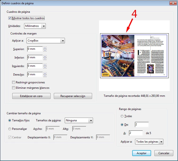

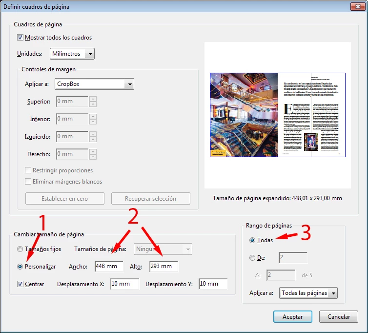

July 8, 2019
If you have already done many PDF and you don't want to remake them to add the slug area (best way to make it right away), you may add that space by altering the CropBox in Acrobat (not Reader).
Just go to tools in Print production area and select "Set page Boxes). There, change Page size as custom (1), Add the needed excess (20 mm for 10 mm, etc.) to the new page size (2), select all pages (3).
There you are (4)

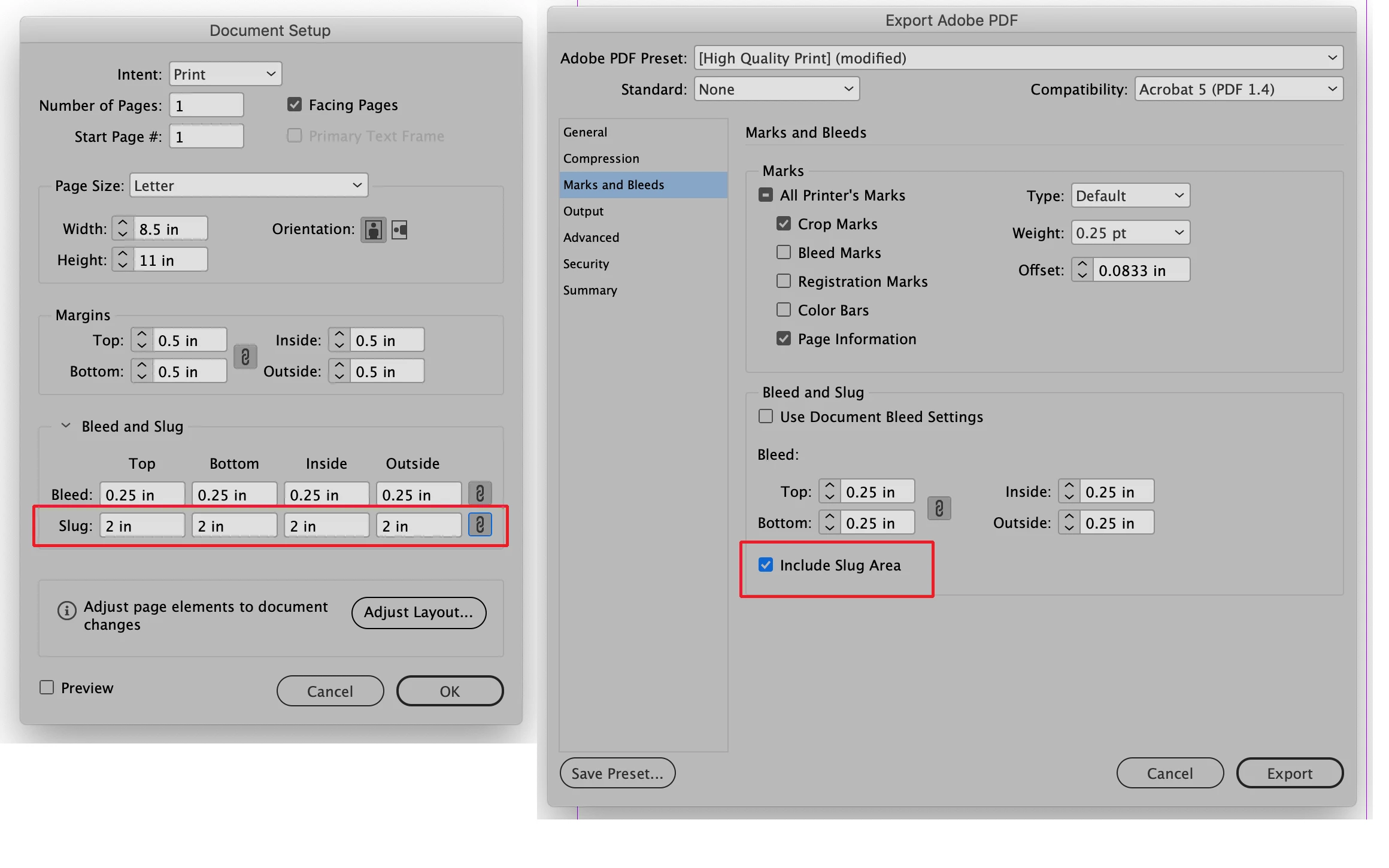

You can add the white space you need without affecting the bleed by adding a slug area to your document. Whatever amount you define your slug as will be the amount of white space that will appear around the image area in the PDF. Use the Document Setup dialog (File>Document Setup) to set the amount of slug needed and then when creating the PDF go to the Marks and Bleeds section of the Export Adobe PDF dialog window and check "Include Slug Area".

Thank you for this, great idea, but it still gives me bleed. I want the page to just have white around the area, no bleed. The document does have bleed for printing but I want the customer to just see the trimmed area in a white surround with slug below. Any thoughts? My customer can't visualise the finished item with bleed showing.
Bill Silbert
July 8, 2019
All you have to do then is make the bleed settings zero and uncheck Crop Marks and Page Information (see the right picture of the Export Adobe PDF window in my first post).
