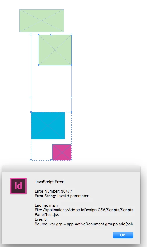

     I want to move selected objects into new layer. Unable to move the object if if is sub selection of group.  How to handle this case?
     My process is
     1. I need to select  all  objects the right side of the page using bounds.
     2. Move into new layer
     Issue : If i move selection objects as it is design is affecting due to order of the objects (ie., textframes & rectangles).  So i group it and moving into layer. Its throwing issue, when a object is inside the group could not able to group it.
     If i ungroup and proceed, properties (ie., effects) of the grouped object is getting lost. How to handle such case..

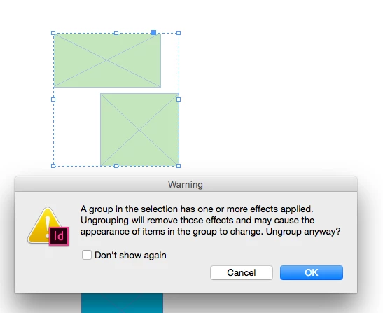

In case the group has an effect applied:
1. Duplicate the group
2. Remove all not necessary objects from the duplicated group.
3. Move the duplicated group to the layer.
Do not ungroup the duplicated group!
4. Remove the object from the original group.
Uwe

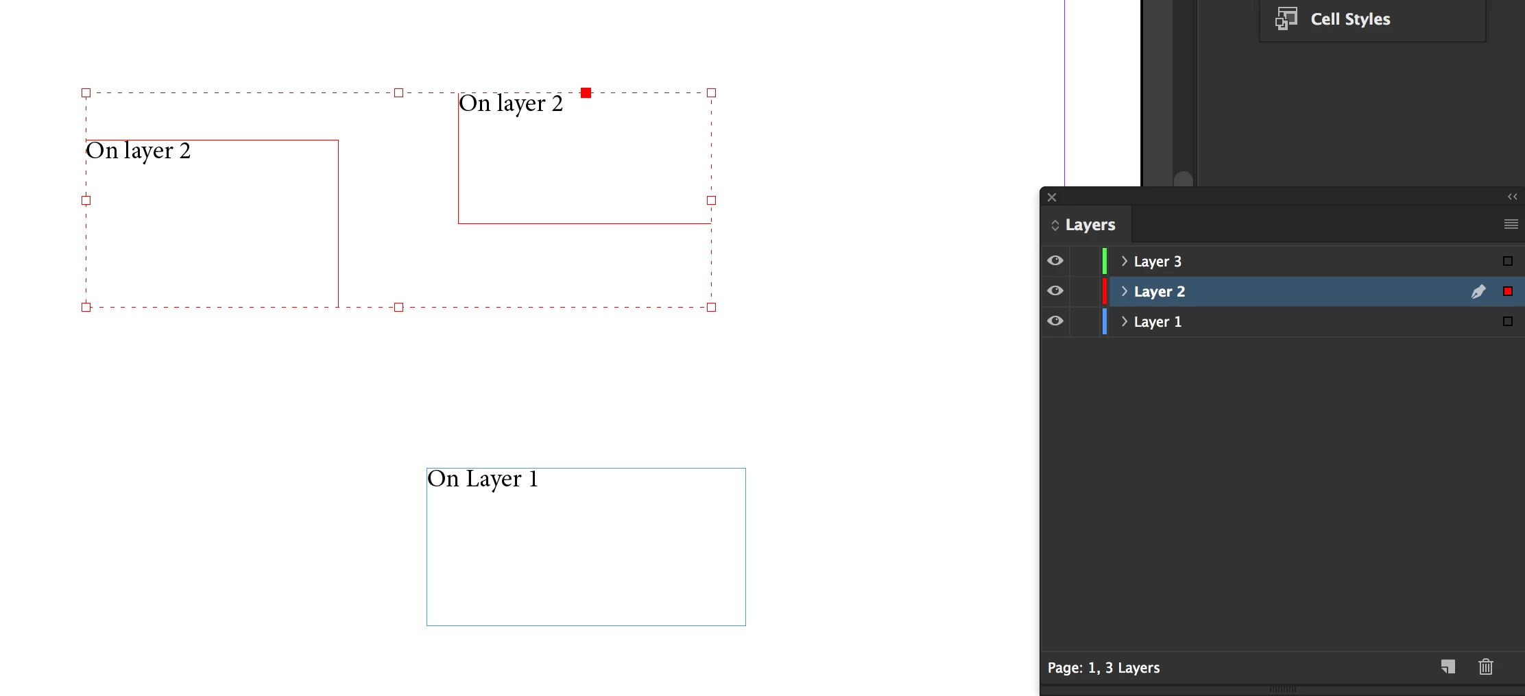

I am not sure if i understood your issue completely. What i understood is that you want to move a group containing a group into a new layer and then ungroup the outer layer. It should work fine and the ungroup should keep the elements on the new group provided the pasteRemembersLayers flag is set to false. This flag is version dependent and was added i suppose in C5.5 or CS6. The following code should work, wherein you start with the selection of all the elements that you want to group, move to a new layer and ungroup
app.clipboardPreferences.pasteRemembersLayers  = false
var gr = app.documents[0].groups.add(app.selection)
var lay = app.documents[0].layers.itemByName("Layer 3")// this is the layer that you want the items to move to
gr.move(lay)
gr.ungroup()
See the screenshot of my document contents.
-Manan

  1. My selection of part of the group and other objects.  if i group those elements throwing error.
2.  If i ungroup and continue the above process, effects applied group is getting lost. How to
February 28, 2019
I still don't understand if the need is just to move a set of elements which can contain group of elements as well in addition to other elements like rectangle etc, then the outer group is something that you will create so this group should not have any effects applied to it and hence the ungroup should not cause any issues.
