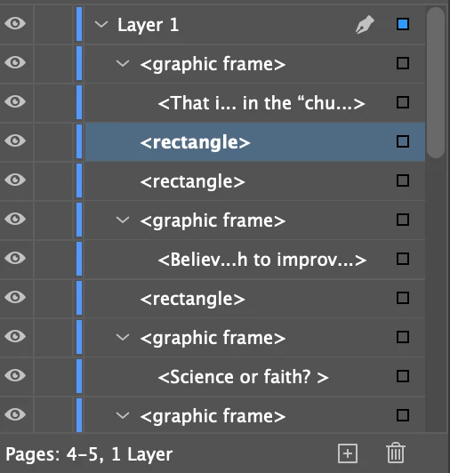

Honestly, I don’t quite know! They don’t appear to be anchored, since they don’t have the blue square that anchored objects have; the Layers panel doesn’t have any `<group>` elements, so they don't appear to be grouped. I don't imagine they were pasted in, since this is how the document was created when converted from the PDF file (no human was involved in the creation of the document at all).
The Layers panel looks like this:
It’s similar to how, if you open a PDF file in Illustrator, everything is embedded in a dozen levels of transparent rectangles (except at least in the InDesign document, it’s only one level deep).
